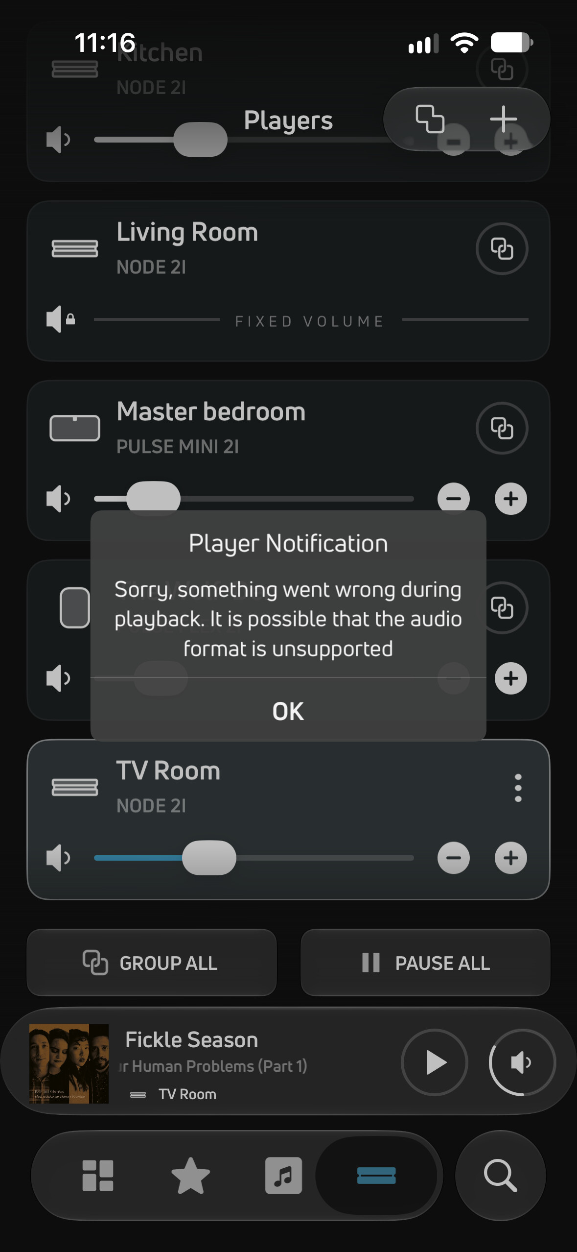

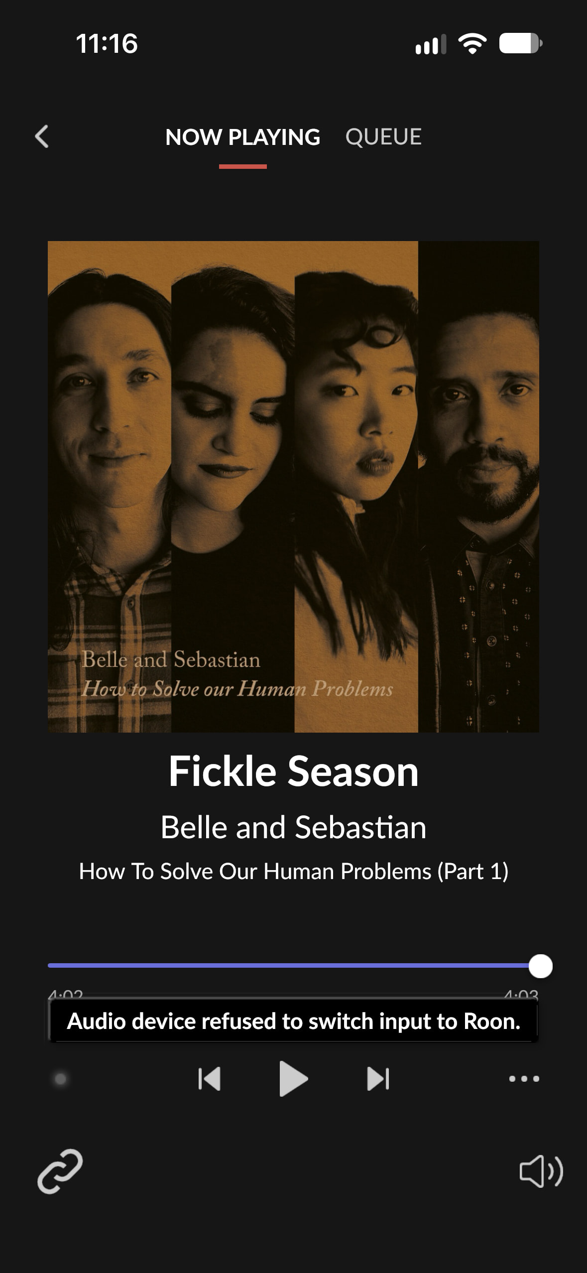

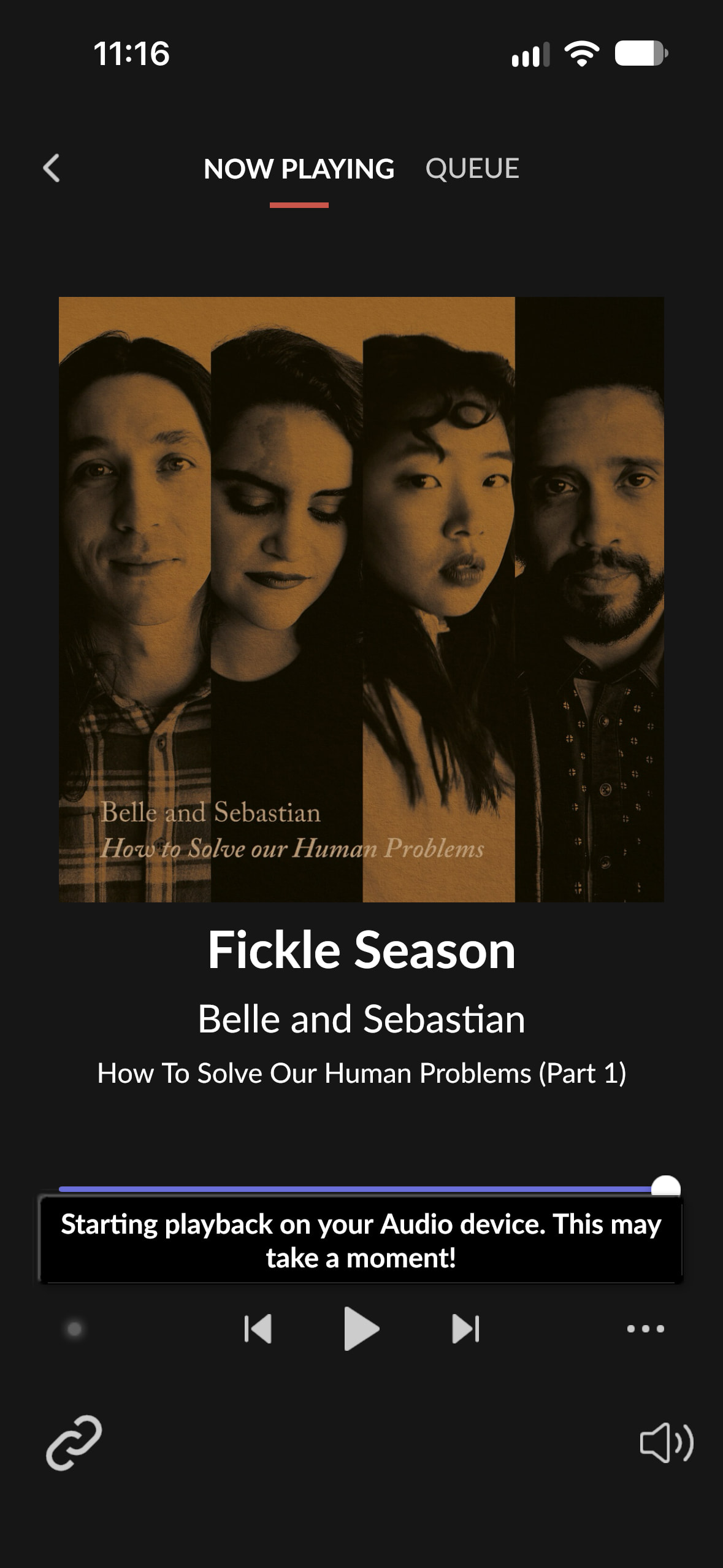

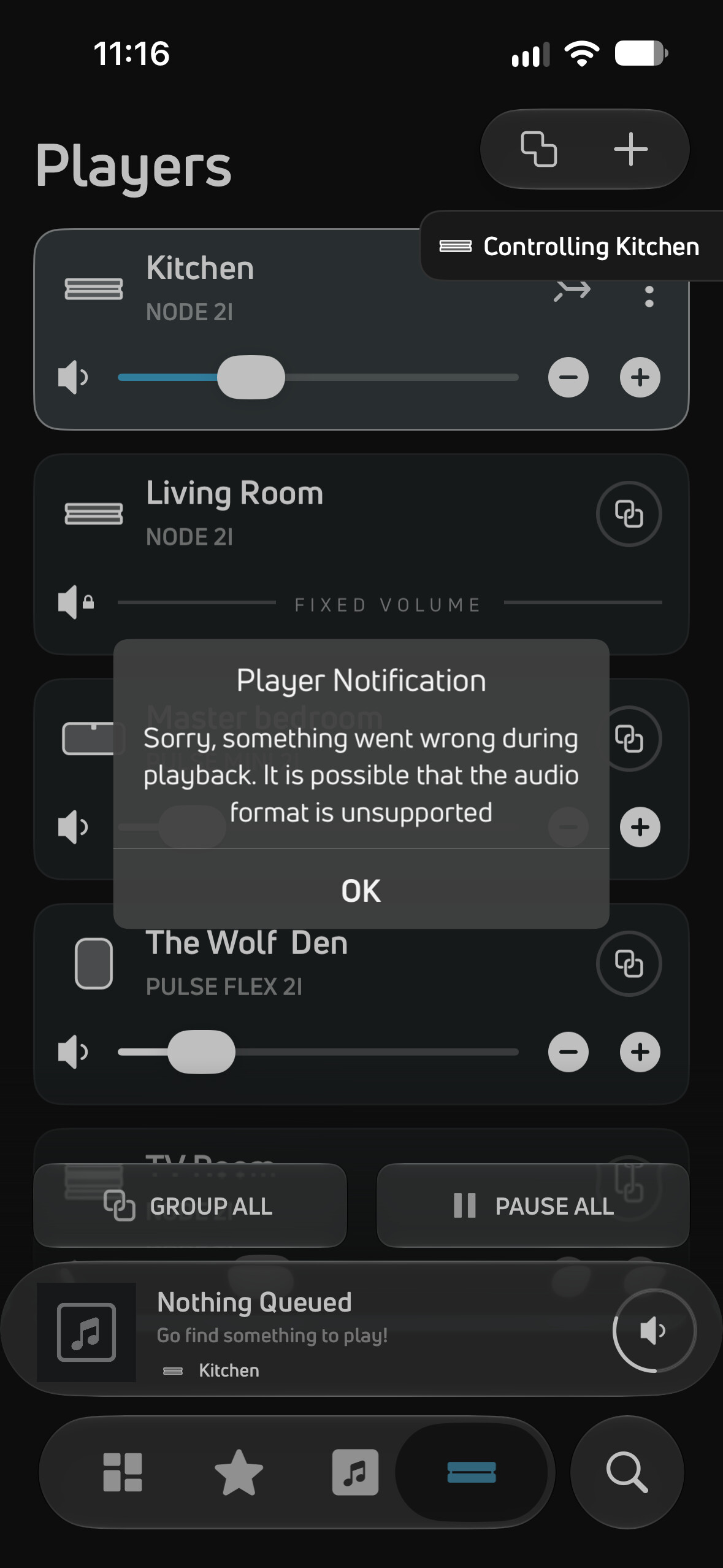

Just had a similar but slightly different issue.
group of three zones will not play. Observed the following error messages in Roon and Bluesound:
Cleared errors and had to reboot all bluesound components to restore functionality. Difference is that this time rebooting Roon server was not required. Event happened at apprx 11:15 EST.

Those screenshots are the missing piece. Thank you for posting them.
Here is what happened at 11:15 on 26 September, from our side.
Roon asked all three NODE 2i units to hand over their source. Two answered straight away. The third, at 192.168.1.122, said nothing at all for two minutes and thirteen seconds while its connection stayed open. Each time you pressed play, Roon asked again and got the same silence. At 11:17:20 that unit sent all four answers at once, and every one was SOURCE_NOT_AVAILABLE, meaning the speaker was declining to give its source to Roon. Shortly after it dropped its connection and reconnected, and playback started normally again.
Your screenshots are timestamped 11:16, inside that window, and the error in them is coming from the BluOS app itself. Roon is not involved in that dialog. So both sides saw the same speaker fail at the same moment, which puts this with Bluesound rather than with us.
If you raise it with them, these are the details worth giving: NODE 2i at 192.168.1.122, 26 September, 11:15:07 to 11:17:20 local time, no response to a RAAT source request for 2 minutes 13 seconds, then RAAT__SOURCE_SELECTION_PLUGIN_STATUS_SOURCE_NOT_AVAILABLE, alongside their own “something went wrong during playback” notification at 11:16.
