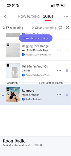

It just stopped after playing Pulp. Skipped the GIMMY track and went straight to Maddie Ashman but then stuck there without playing.
8.52pm GMT. I’ll send the log.

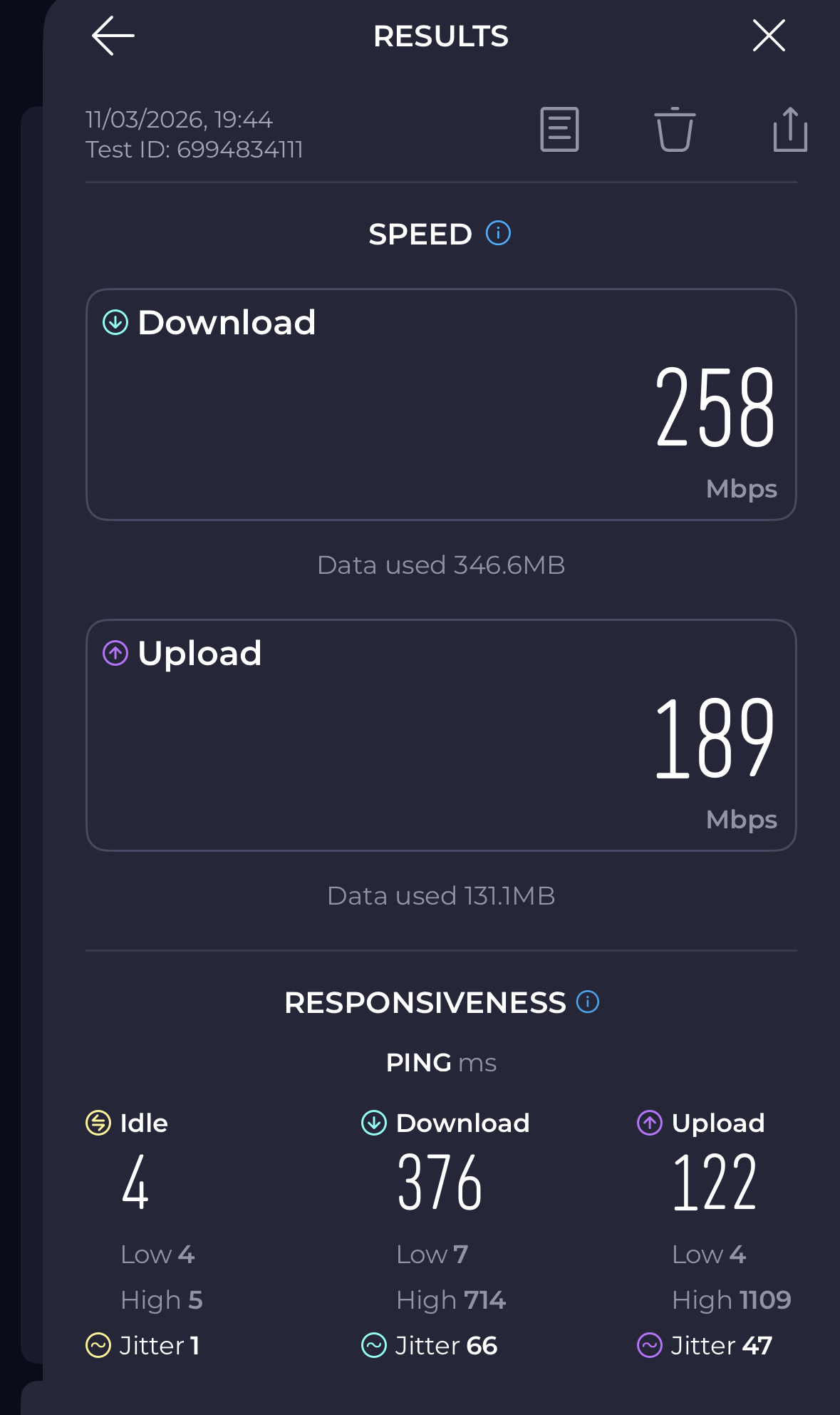

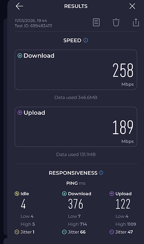

It’s just crashed again, playing via USB with Tidal streaming quality set to ‘high’. 19.38 GMT. I’ll send logs.
My internet is fast up and down and stable.

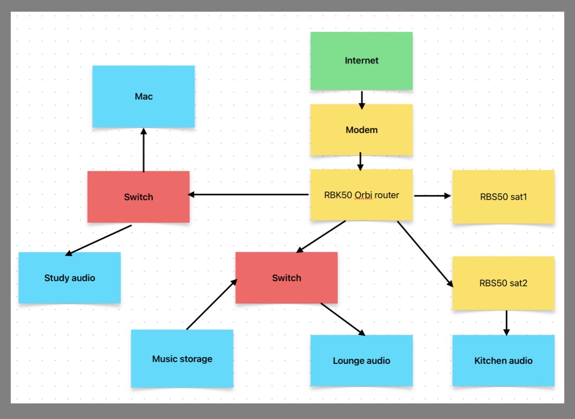

In the meantime this is my set up if it’s useful to know. The “lounge audio” is the ID41. The “music storage” is the Nucleus+. I’ve connected that directly to the Orbi router to bypass the switch and I’ve ordered new Cat8 cables in case that’s the problem. The switches are not managed btw.
Hello @Ian_Tollett
Thanks for providing the network schema. We are in the standby mode until the next occurrence
