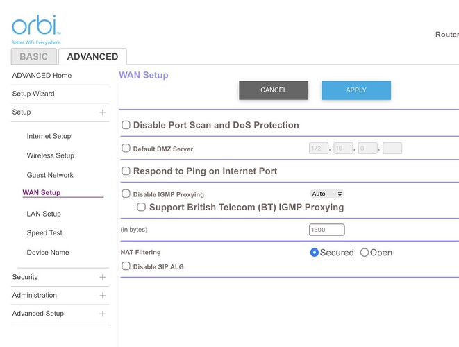

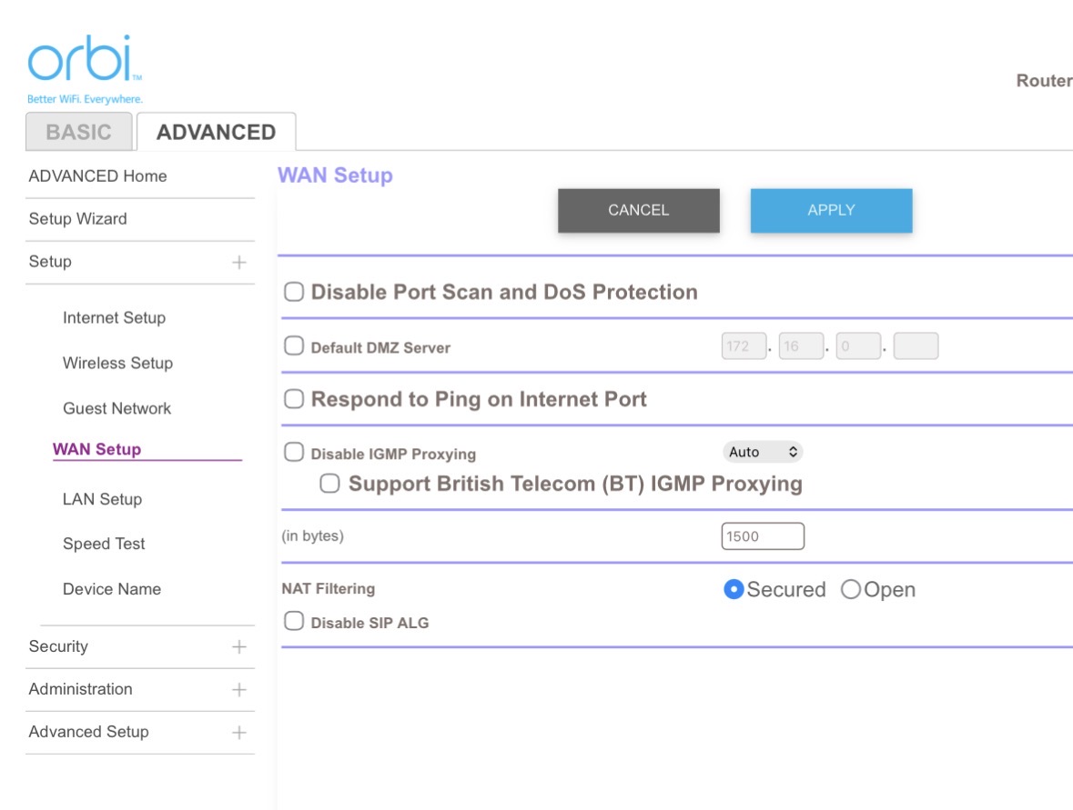

Thanks @alex_h - but my Orbi router doesn’t have an IGMP snooping setting. It does have “Disable IGMP Proxying” which I have had unchecked for a long time as recommended here:
@alex_h could you take another look at this please. Is there any other way to reduce the network overwhelm of the ID41?
