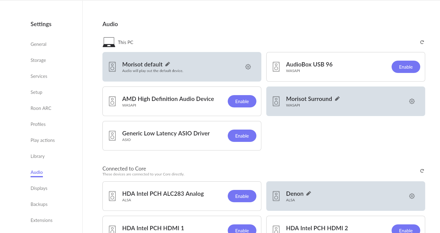

Can you post a screenshot of Roon’s Settings > Audio page showing this? It sounds as though this is correct, showing that the devices are enabled, so there must be something else going on. Here, for example, is what I see on my system - all the enabled devices are shown in “grey boxes”:
