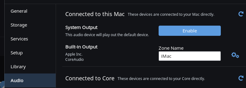

My Normal in/out seems like this.
Before getting Support to help out, here’s something for you to try.
We want to get rid of the OS Mixer as your output (as seen in your screenshot). First, go into Settings > Audio and Enable Built-In Output. See here:

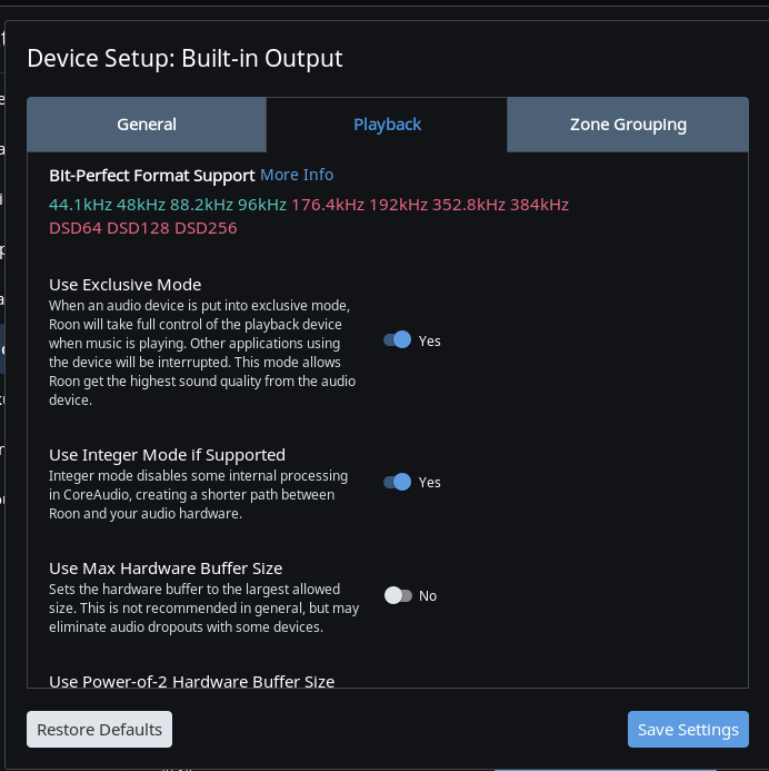

Then we want to go into Device Setup (it may already be showing when you Enable Built-In Output), or click on the gears icon next to the Output and select Device setup. Under the Playback Tab, select Exclusive Mode, like I did here:
Save your settings and be sure to change your Zone by clicking on the Zone Picker at the bottom right of the screen, next to the speaker icon.
Try that and see if it helps.
Cheers, Greg
Wow It solved! I think the problem was using system output instead of Built-in output! thx
