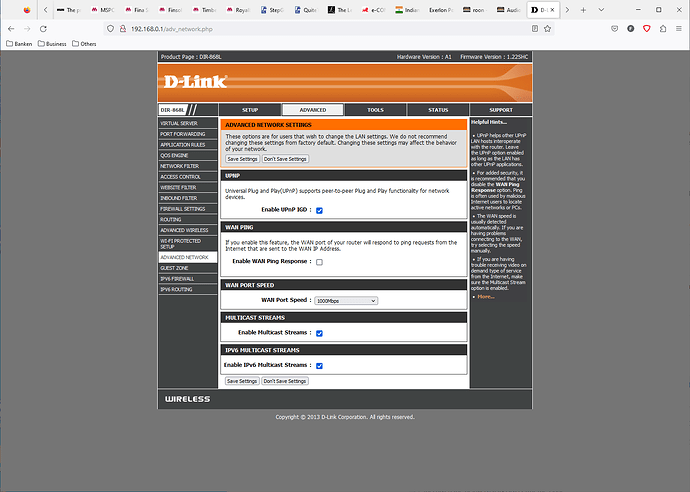

LAN / WiFi Router connected to Huawei modem: D-Link Dir-868L
UPnP enabled on the Router:

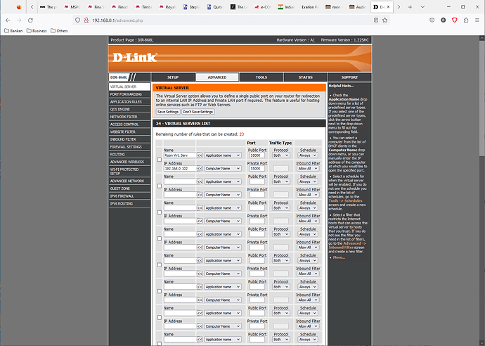

Port Forward setting on the Router (192.168.0.102 is the IP address of my PC with the Roon Core installed on it):

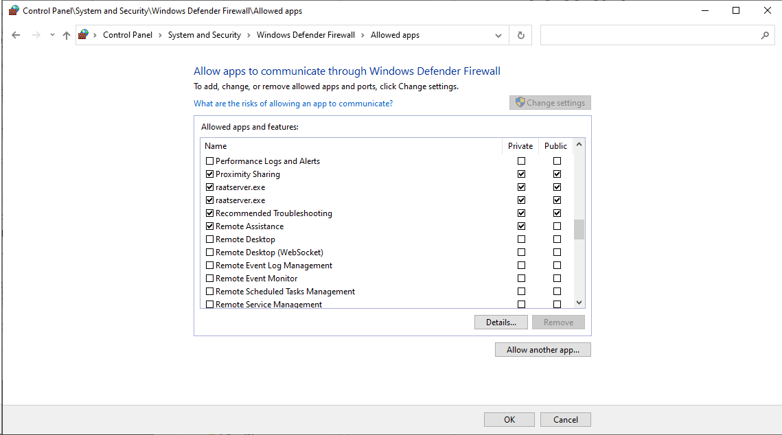

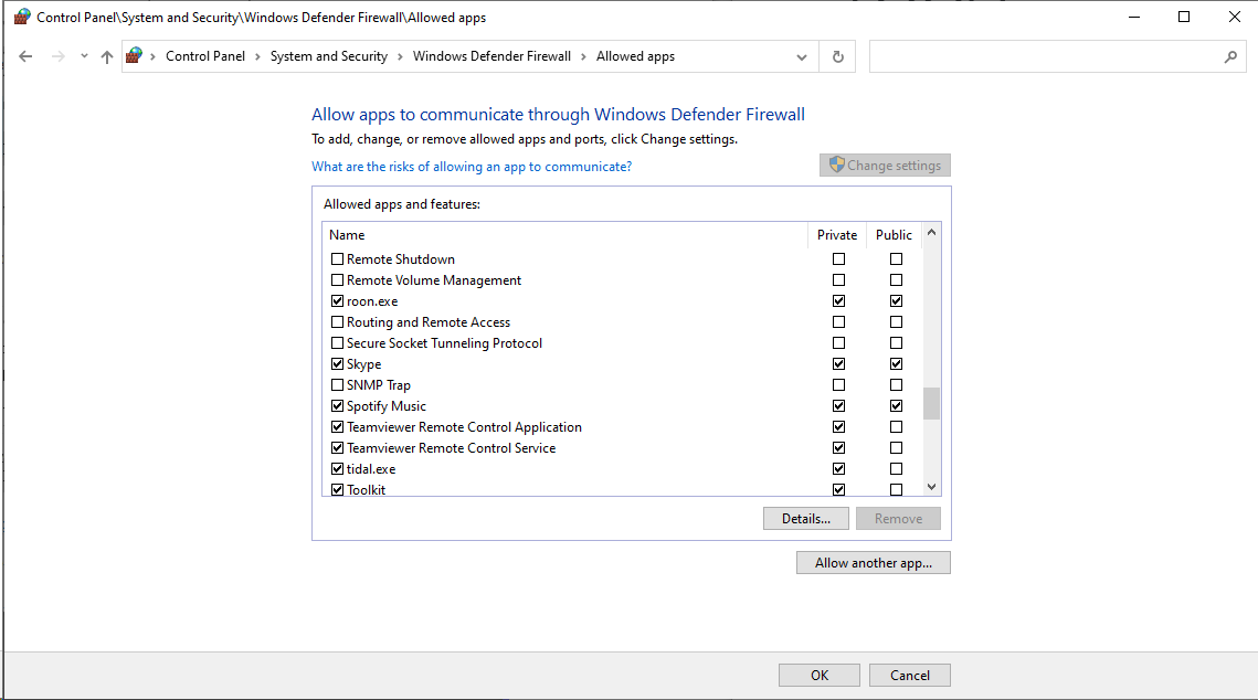

My Windows Firewall settings (I have uninstalled Avira, no other protection is on as per my knowledge):

@Friedrich_Brida, your second screenshot identifies your core as “Roon virt. serv”.
I don’t use ARC, but fwiw that may be just a D-Link thing. If you look at the description in the header on that page of the router config, D-Link is describing a port forwarding function as “Virtual Server”. These router companies sometimes have odd ways of describing functionality.
My own router shows it’s firewall setting as “NAT only” which gave me a start. It’s not just NATing.

Dear Martin, thank you for highlighting the virtual server situation. Actually as you can see in the second screenshot the box is not ticked, so it was not running as a virtual machine. Nonetheless for this reason, I decided to reset my D-Link router and to uninstall my Roon Core and start completely new to ensure that I have no tinkering done on my side and run everything with a clean new Roon setup.
