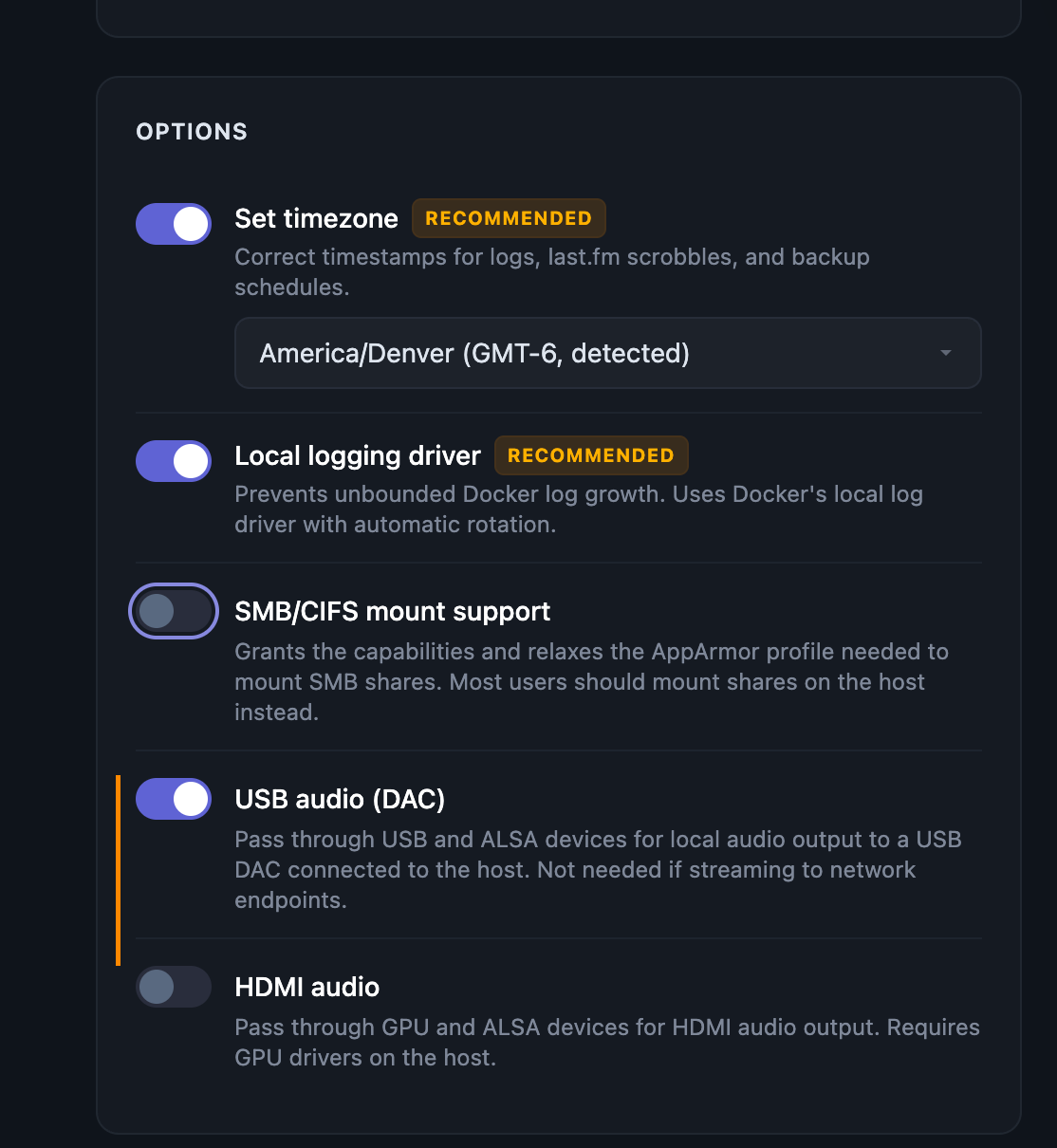

The DAC should work over USB and the new container stuff. However, you do have to enable USB.
On the configurator web tool:
My apologies for missing the option in the Configuration Generator.
@Stephen, I assume you have enabled USB/IP?

Thanks Stephen,
I am up and running now.
