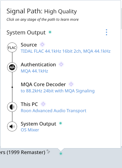

Hello. Not sure if this should be a new post but I will try this and see if there is a response. I just upgraded to a MyTek Liberty DAC with Roon on a laptop running Windows 10 64 bit. The MyTek is playing through my system, but when I listen to a Tidal Master selection the MQA led remains orange, meaning I am getting PCM playback, and not MQA quality (primary reason I upgraded). When I go into Roon / Setup / Audio, I see two entries for the MyTek Liberty (WASAPI and ASIO). Both are disabled. The device that is showing as active, and playing music is “System Output”. When I enable either of the MyTek Liberty options and select them as output, there is no sound, and it shows “nothing playing”. I checked the Windows 10 Sound Control Panel and it shows Speakers / 2 - Liberty DAC as the default device. I downloaded and install the most recent device driver from MyTek and no change.

If you click on the “dot” what does it say?

Thank you for the response and suggestion. Here is what this shows. I see that it is showing “High Quality”, an not “Lossless”. So maybe a setting in WIndows?
Have you rebooted the pc the DAC is attached to with the DAC still connected?
It looks like Roon is decoding MQA before sending it to your Liberty.
Let’s check the audio device setting in Roon.
Is it set to “Decoder and Renderer”? If not then change that.

You are outputting to the system mixer, try outputting via wasapi it asio in exclusive mode.
I think the OPs problem is that ONLY system output shows in roon.
Sorry was not super specific. You need to be using one of the two Mytek USB options to get MQA to the DAC. Going through system output is going through the OS mixer which is not going to be bit-perfect which is what the DAC requires for MQA.

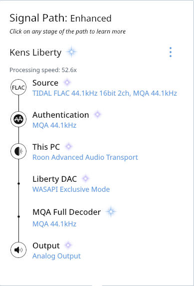

I did a firmware upgrade to 1.35, but had an issue. It took a couple of instances of pulling the plug and resetting the Liberty before it came up again. So the good news is now I am able to play through the MyTek WASAPI object in Roon. I get a green LED, which is also good. However, I tried several different Tidal masters and none of them show blue. (Could someone offer up a title they confirm shows the blue LED please). Also, in Roon it shows for any Tidal Master files I am getting only 24/44.1. (screen shot here shows same selection that was showing 88.2 kHz from the MQA Core decoder in one of my earlier posts):

If you have device volume set, change it to fixed volume. See if that helps.
