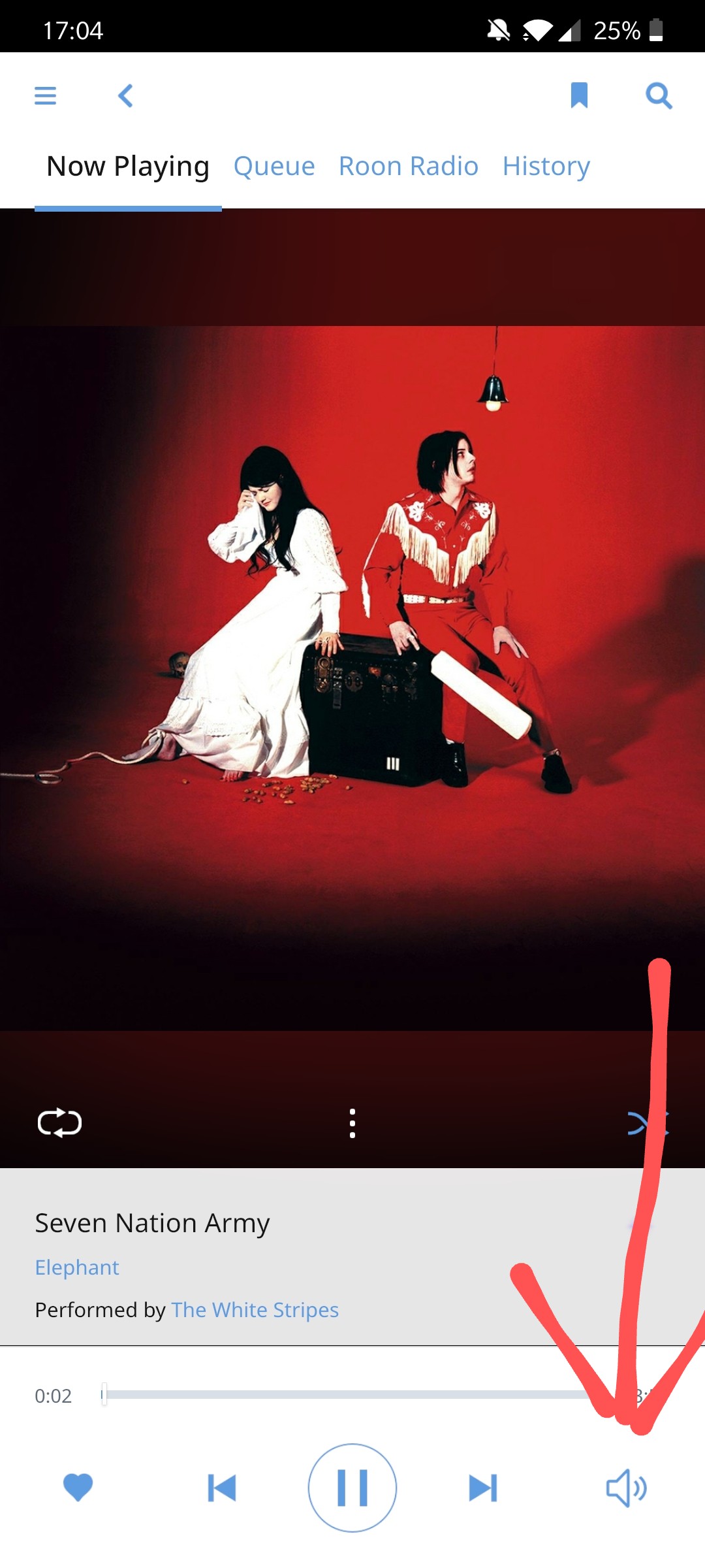

This is on my phone but you will get the idea.

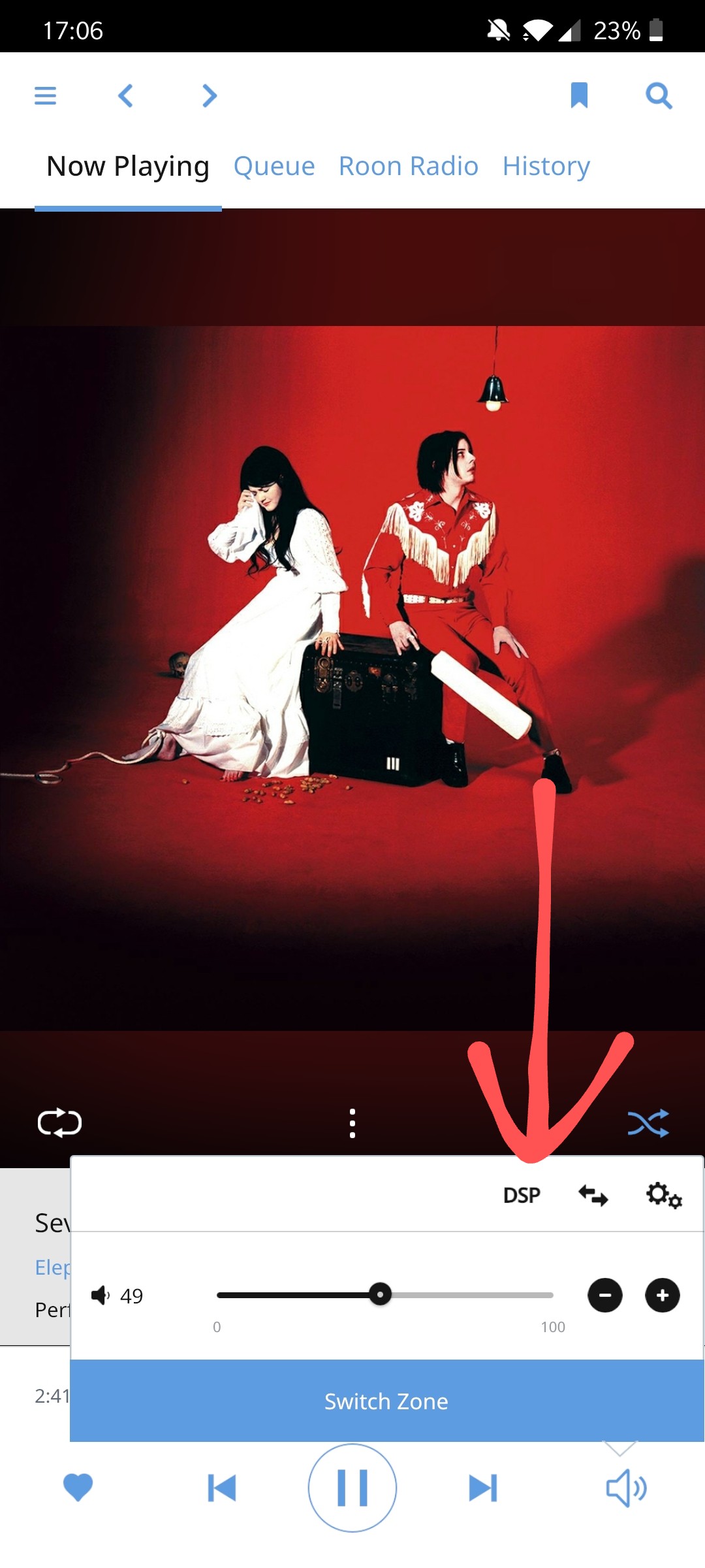

Click the volume button
Which will give a little pop up with DSP as one of the selections

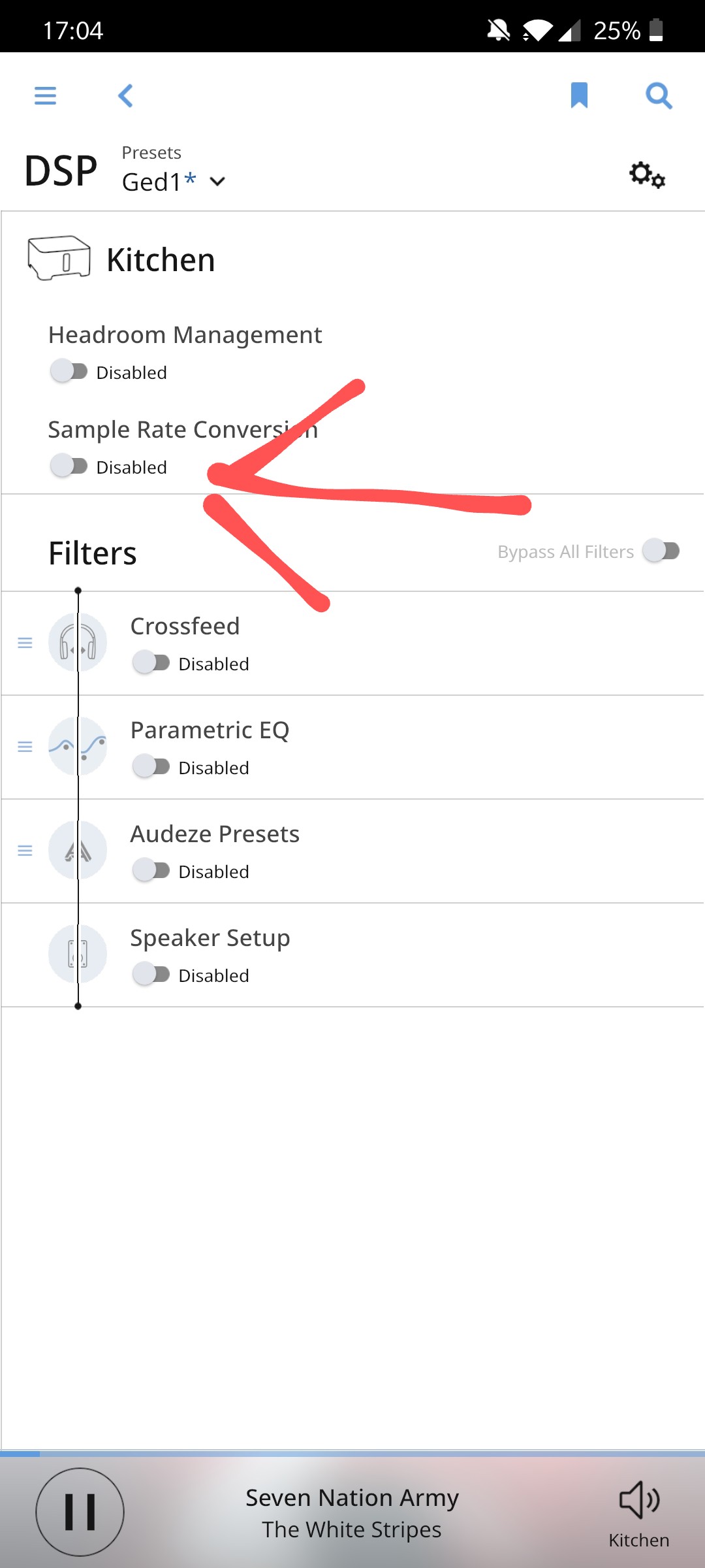

Clicking on that gives you rate tool
Fantastic, thank you! Worked like a charm!
