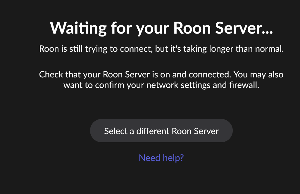

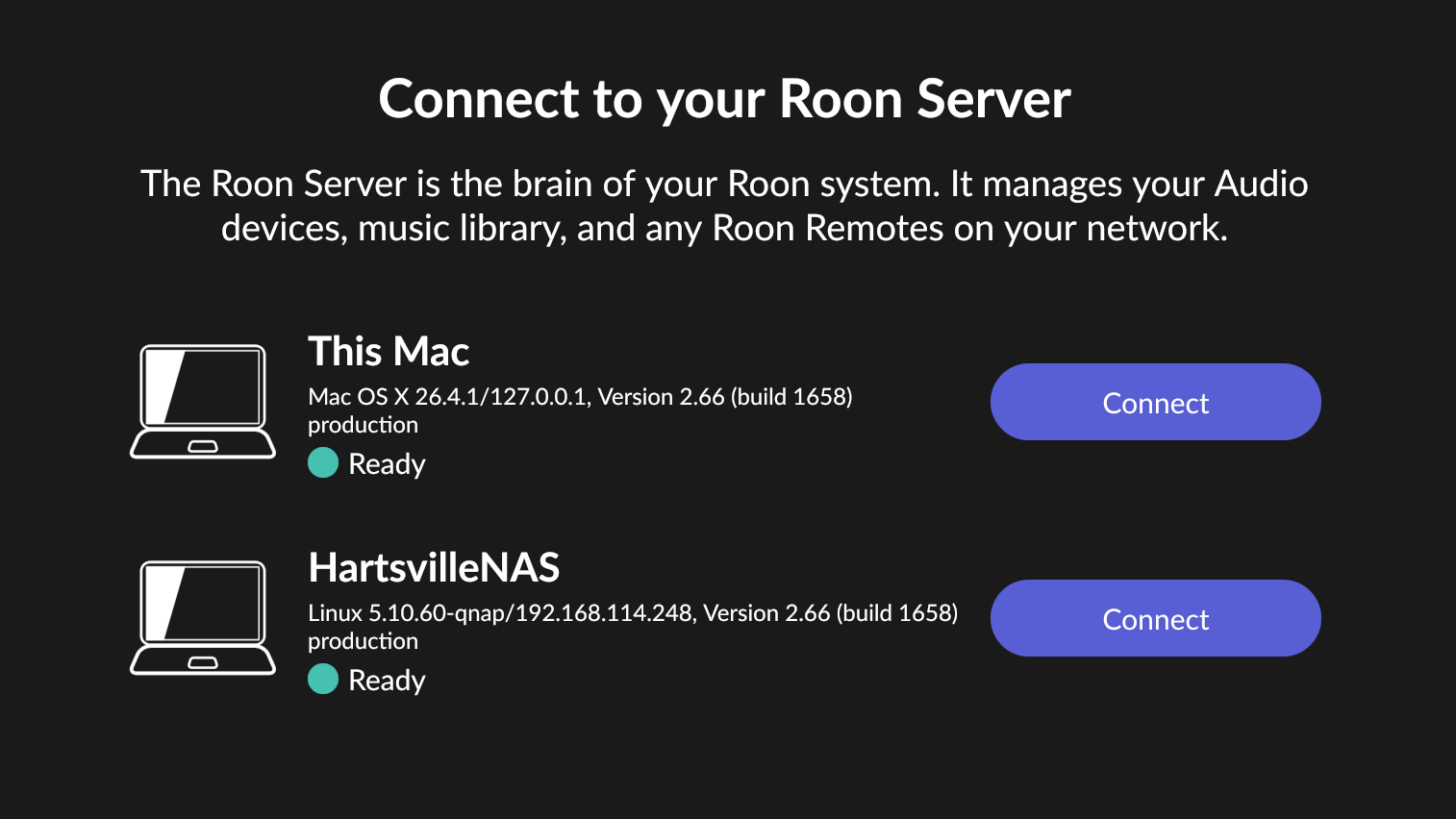

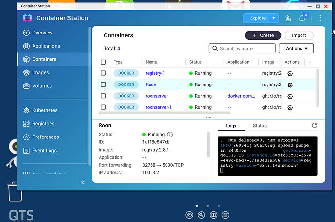

So, I followed the Docker and Container Station procedures as outlined in the links, apparently successfully, but Roon still won’t connect. Actually did it a second time after the first one did not work (Roon still failed to connect).
Whenever I select my NAS (below)
I get is this
I’m confused by this because part of the instructions for setting up Docker was to remove Roon Server from the NAS, which I did. So… I click DONE. and get this.
I also tried reinstalling Roon Server, in QNAP, but that did not change anything. Currently, I’ve removed Roon Server from Qnap.
I’m not an IT or a very experienced NAS user. Just want to listen to and maintain my audio library which is stored on the NAS so I can archive and listen to it in various places with ease of use (at least, that’s the idea). Hopefully, you or someone can glean what I’m doing wrong from these screenshots so I can get back to doing that again. Thanks.

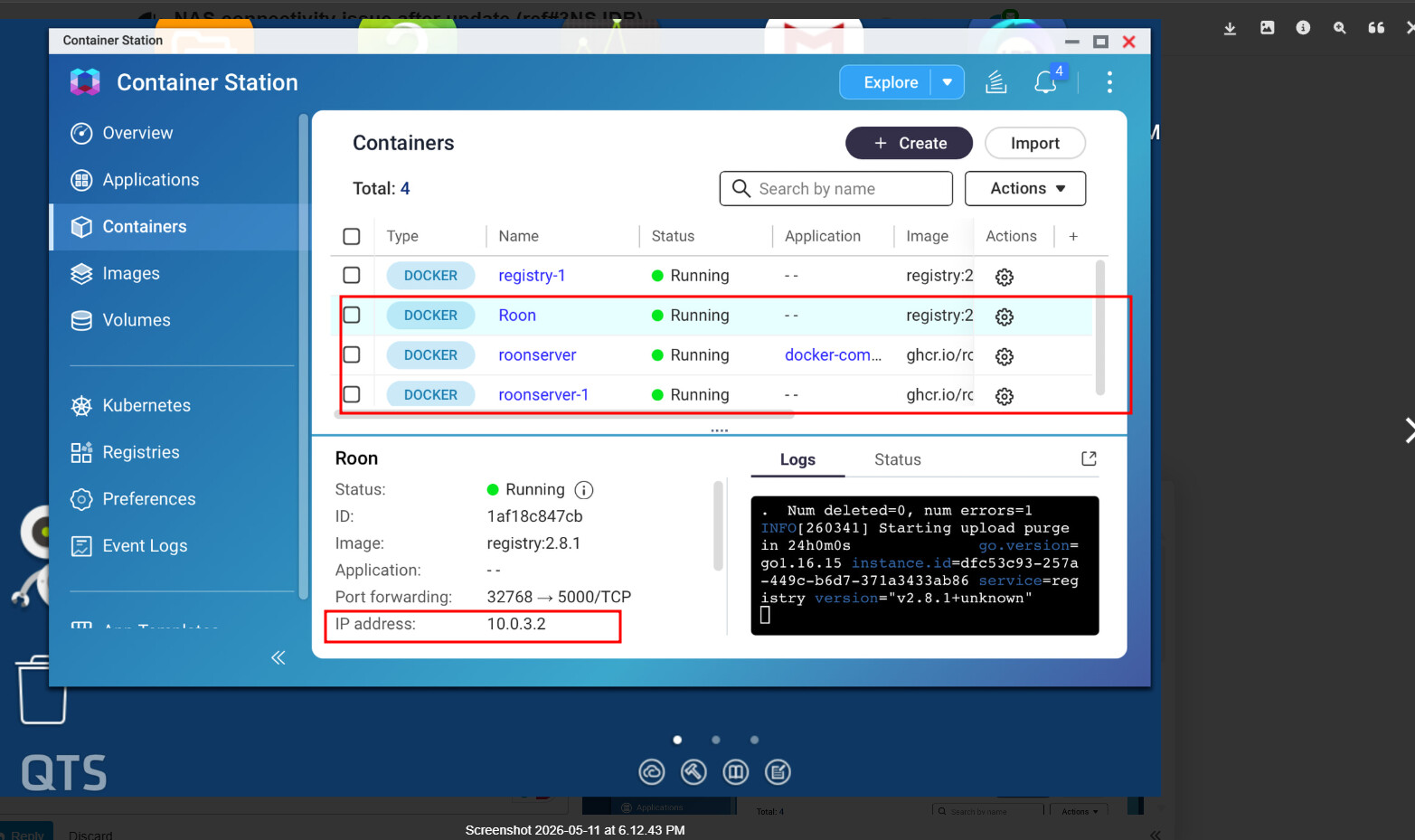

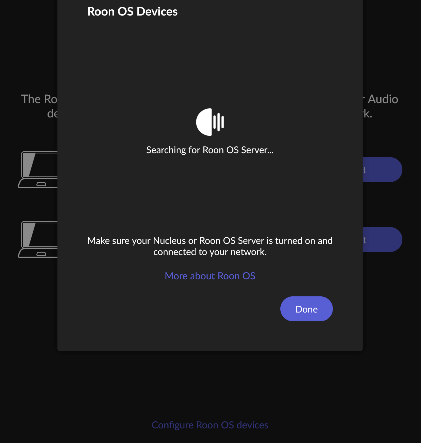

I think we want to wait for @vadim to make suggestions for next steps, but some things seem strange here:
In the first screenshot, I am not sure if there should be “roonserver” and “roonserver-1” running.
In the third screenshot, after you select your NAS, it is “Searching for Roon OS Server”, but “Roon OS” is a Nucleus or ROCK, and I think this screen should only appear if you previously click “Search for Roon OS”, not when you click Connect for the NAS. So I don’t know what’s going on there.
Right. I mentioned that I had attempted a second time after the first attempt failed so that’s why there are two roonserver entries. I’ve, alternately, tried turning each off/on to no avail. I took the screenshot when both were turned on. I know I must’ve done something wrong but don’t know where I went wrong. Likewise, the Roon OS line also confused me as I don’t have a Rock or Nucleus. Hopefully @vadim can straighten me out. Thanks.
Thank you for providing the screenshot! It completely explains why you are having trouble connecting. It looks like things got a bit tangled up during the setup attempts.
Looking at your Container Station, there are a few critical issues we need to fix:
  1. Multiple Instances: You have multiple Roon Server containers running at the same time (roonserver and roonserver-1). They are likely fighting over the same network ports and database files.
  2. Incorrect Image & Network: The container simply named Roon (whose details are shown at the bottom) is actually running a completely unrelated Docker image (registry:2.8.1), not Roon Server. Furthermore, it is running in “Bridge” mode (showing IP 10.0.3.2 and port forwarding) instead of “Host” mode. Roon must be in Host mode, or it will be invisible to your remotes and audio devices.
Here is how we clean this up and get it working:
  1. Delete the Clutter: In Container Station, please select the checkboxes next to Roon, roonserver, and roonserver-1, click Actions, and completely Stop and Remove (Delete) all three of them. Don’t worry, your actual music files won’t be deleted.
  2. Start Fresh: Once the list is clear, follow the Docker setup guide to create one single container.
  3. Network Mode: Make absolutely sure that in your configuration (whether using the Compose YAML or the UI), the network mode is explicitly set to host.
Before starting the new one, you can share your YAML file from the compose generator page, and we will review it together.
Let us know once you have cleared out those duplicates and spun up a single, fresh container in Host mode!

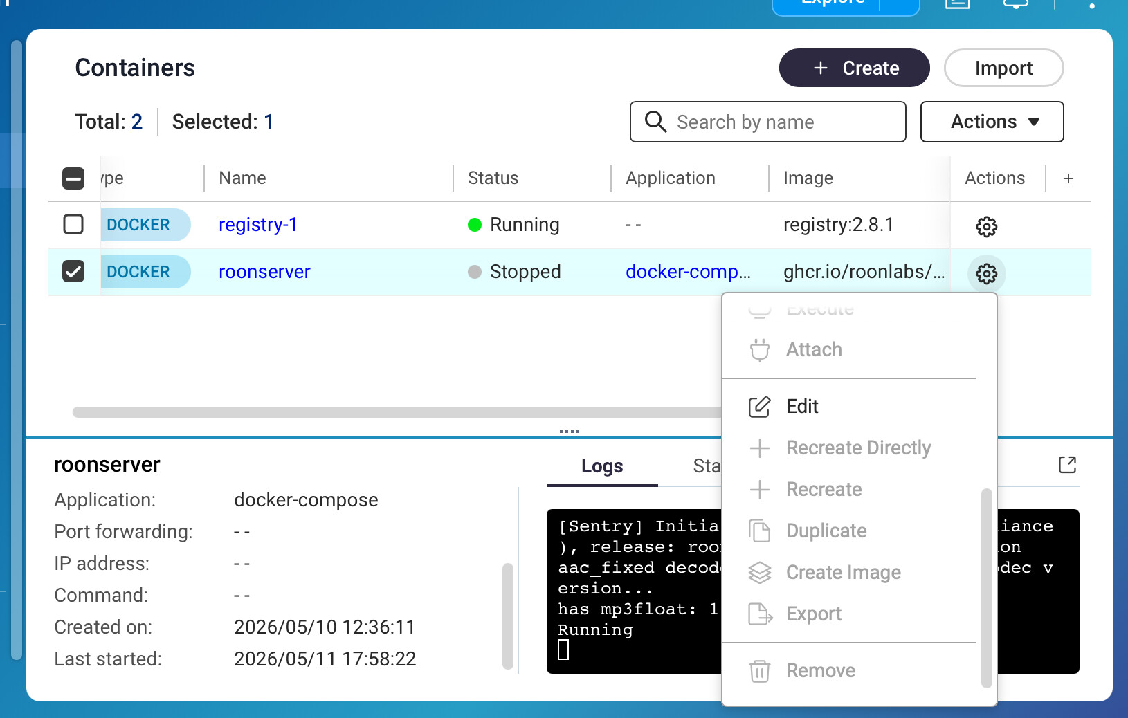

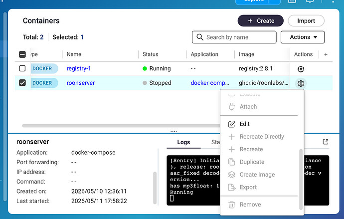

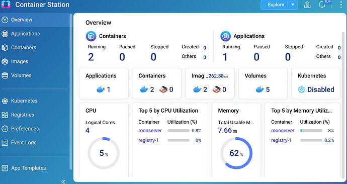

Here’s another screenshot. As you can see, I am not being allowed to remove the roonserver entry as, “This operation is not supported on containers using the Compose function”. How do I get around that?
Also, should I leave the registry-1 entry alone?
Thanks
Okay, I figured out to remove the docker-compose entry by removing the application.

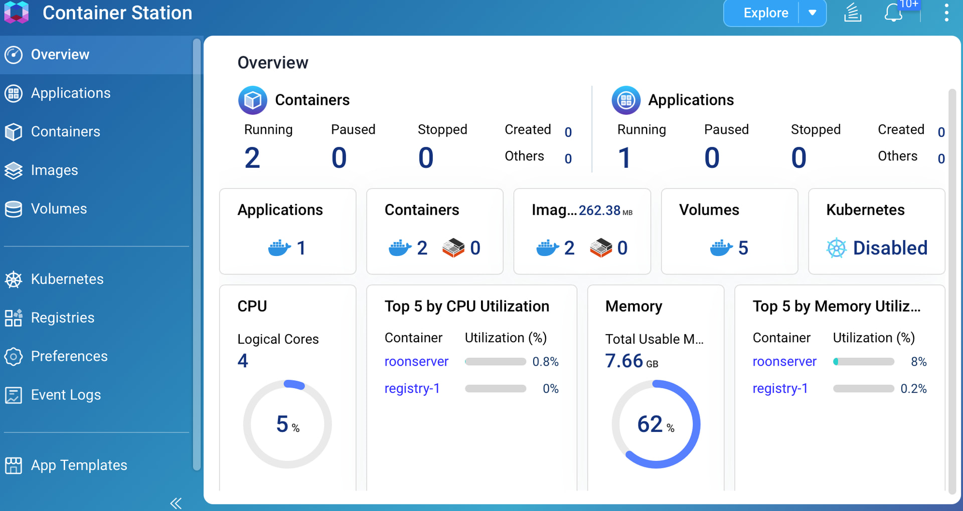

My network is up and running (always has been except when I’ve restarted several times). All Amplifi routers are on the same local network. Here’s a screenshot of current Container Station overview. Roon is currently running in the non-functioning state described in my previous post (just the pulsing speaker icon) with “Quit Roon” as the only functional menu item so… I can’t access Settings. I’ve not had connectivity issues with the routers previously.
Thanks

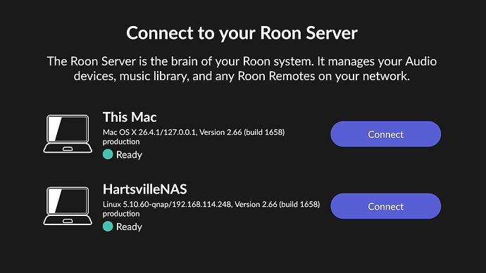

Update: I just clicked on menu item “About Roon” and am now getting this (below). I’m missing something fundamental here. Network settings seem normal and firewall is disabled. I just seem to be going in the same spiral after the update. FileVault was on. Might that be a problem? I tried decrypting but still no joy. Should I “Select a different server again”?
OKAY! After restarting, for the umpteenth time Roon, once again populated itself with my music library on the NAS although without any of my playlists and favorites, etc. Like starting from scratch. At least on the host end, that is. One client is still not functioning but that’s a separate issue, I think. I’ve got music in my main listening room now so that’s much better than the few weeks prior, anyway.
