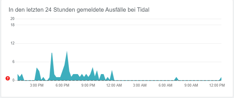

@michael_maharam , @noris, @dylan the only connection I might see is
(translation: Tidal downtimes reported in Germany (number/time) within the last 24h
At 6:20PM and 6:40pm I got skips, jumps whatever you call it and today within 4 hours no issues till 12:30 o’clock.
