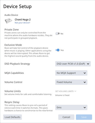

Set up is EE smart hub in the garage with DECO node/access point providing WiFi 7 MLO Internet access for the ROON core running on Windows 11 PC, otherwise wired Cat 6 network from the Deco to a MELCO switch, then to NAIM NDX streamer DAC then Naim amplifier to speakers
I agree it’s probably a DAC sync issue… you can try playing with a resync delay in device setup. Good luck.
Oh… many thanks but I’ve already tried the max delay to no avail Im afraid
