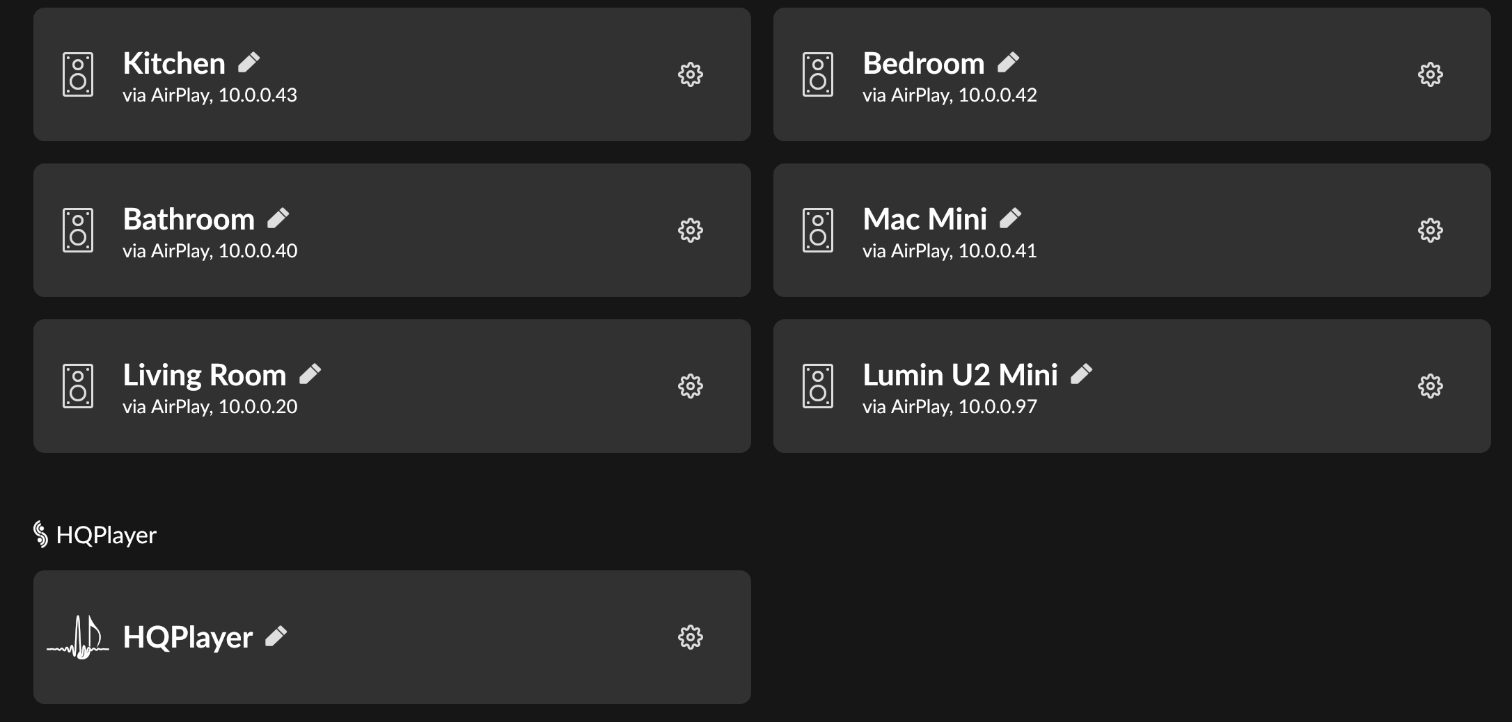

Please have a look below…
I see, thanks!
You may want to experiment with different settings for:
grafik
I would disable all the ones you are not using…and then you might have some clarity on what is what…click the gear/cog icon and select disable
