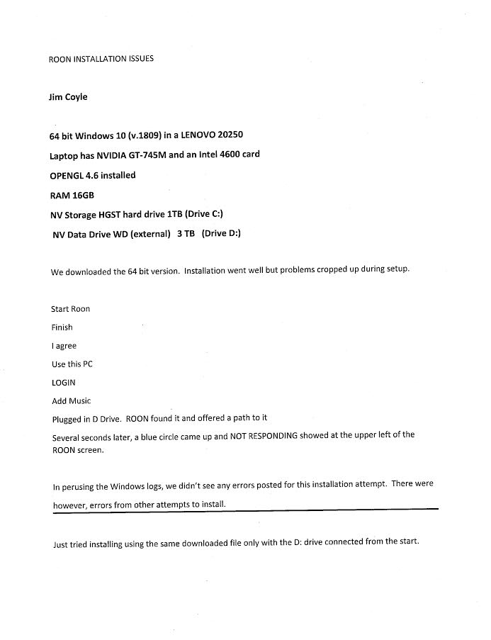

In perusing the Windows logs, we didn’t see any errors posted for this installation attempt. There were
however, errors from other attempts to install.
Just tried installing using the same downloaded file only with the D: drive connected from the start.
The installation went fine until we added a folder (D:) and then we got “not responding” in the upper left. Didn’t see any corresponding APPLICATION logs but there were DCOM errors in the system error log. The error included code 10016 on all 4 entries. Thanks

Apologies for the delay in getting back to you here, can you please provide some screenshots of the error you’re seeing and a snippet of the system error logs?
I looked up the DCOM errors and have found this article referencing it:
It appears to be some kind of permissions issue at first glance but I have requested that the QA team take a look at this matter and I will let you know what they say.
One other idea I have here if the issue still happens after following that guide would be to login and set up Roon first and then after everything has settled add the additional storage location. So this would be a bit different than adding the media locations on the Roon startup and would have to be done in Roon Settings -> Storage Tab. Please let me know if that changes anything.
I have been trying to get roon working about 3 week now and on last support email Noris replied that it looks like my laptop is not giving permission given the error codes I am getting in the log. Noris said this has been passed on to QA but asked if I could send screen print of log. and any other pertinent information please see the attached. Hope this can help me get up and running. Thanks, Jim
