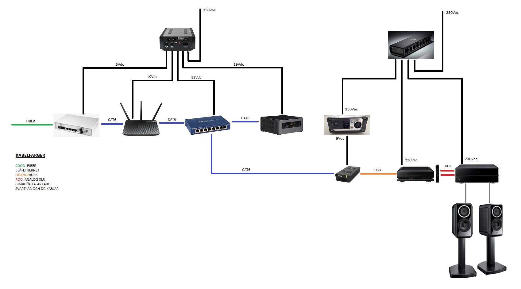

I actually made a small guide on a local forum, it can be translated and might be useful:
