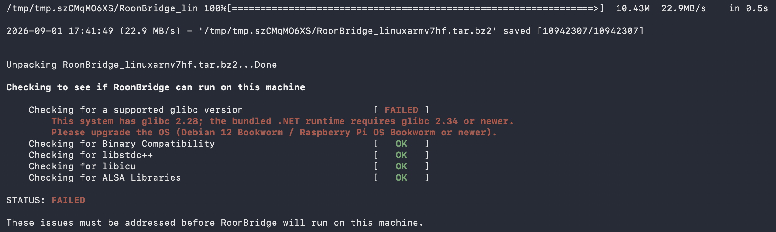

· RonnBridge on Linux actually needs glibc 2.34 or newer

It looks like you are running ARM with a 32-bit OS. What device and OS are you running?
Hi @Roland_von_Unruh,
Thanks for sharing that screenshot and the note about RoonBridge on Linux needing glibc 2.34 or newer. Could you confirm the device you are using, along with the OS version? Thank you.
It is Volumio 3.912 on a Raspberry Pi 4.
This has glibc 2.28 installed and should have been able to run the new RoonBridge according to the minimum required version 2.27 advertised by Roon in the release notes.
So either the release notes are incorrect and need to be updated or the installer checks for a higher glibc version than actually needed and has to ne fixed.

It looks like you are running a 32-bit OS on 64 bit hardware, so the minimum requirement is not 2.27.
Consequently, it is unlikely that Volumio 3 can run the latest version of Roon Bridge. You will need to update to Volumio 4.

As it seems, all ARM versions (v6, v7, v8) need at least glibc 2.34 while the 2.27 minimum requirement only applies to x64-architectures.
See the following excerpt from the “check-common.sh” shell script of the RoonBridge installer:
 display_check "Checking for a supported glibc version"
    local need
    case "$(uname -m)" in
        armv7l|armv6l|armv8l|arm) need="2.34" ;;
        aarch64|x86_64) need="2.27" ;;
        *) display_ok; return ;;
So all it takes for Roon is to update their release notes with the architecture specific details.
