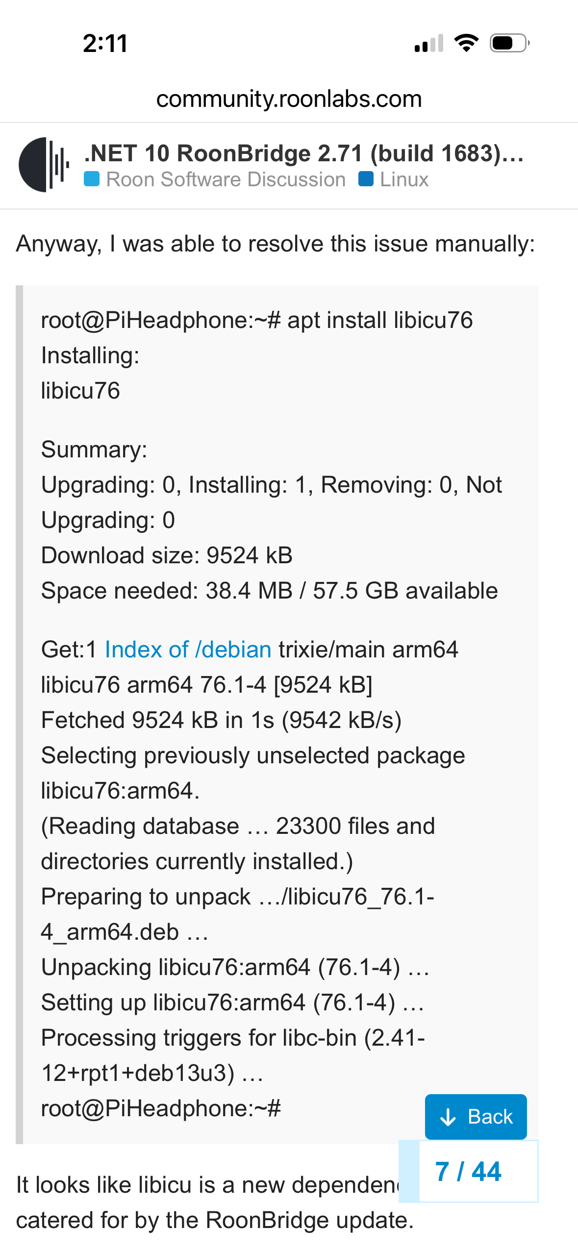

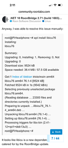

Yes I did see. That is why I suggested that if ‘apt install libicu76’ does not work (because that version is not available on bookworm) you should use ‘apt list libicu*’ to find out what versions are available.
This would likely have told you that libicu74 (note: 74 not 76) is available and thus ‘apt install libicu74’ (again 74 not 76) would have fixed your issue on bookworm without updating/reflashing to trixie.

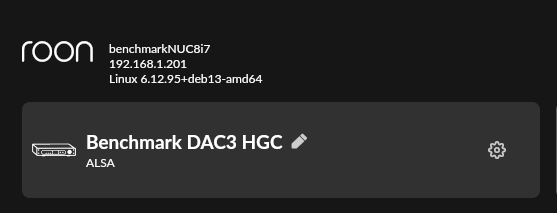

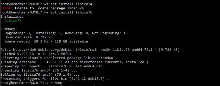

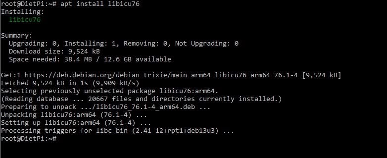

@Wade_Oram , one more huge Thank You for your patience and help. I as able to run “apt install libicu76” on my NUC8i7 running DietPi (Trixie) and get it working again. This is a huge relief since I use this Bridge to test other “stuff” (I tested “74” regardless).

“Bookworm” → 74; “Trixie → 76”. :+1:
