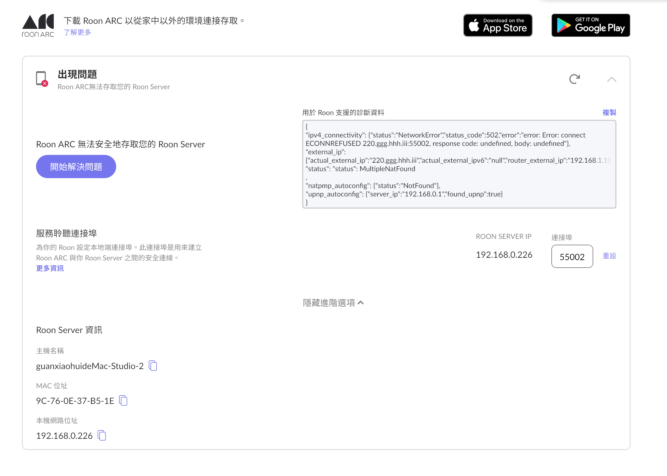

Network Error: ECONNREFUSED when connecting to IP address (ref#LDAQIY)
"ipv4_connectivity": {"status":"NetworkError","status_code":502,"error":"error: Error: connect ECONNREFUSED 220.ggg.hhh.iii:55002, response code: undefined, body: undefined"},
"external_ip": {"actual_external_ip":"220.ggg.hhh.iii","actual_external_ipv6":"null","router_external_ip":"192.168.1.107"},
"status": "status": MultipleNatFound
"natpmp_autoconfig": {"status":"NotFound"},
"upnp_autoconfig": {"server_ip":"192.168.0.1","found_upnp":true}
數據機_Archer BE805_MAC studio(Roon core)
