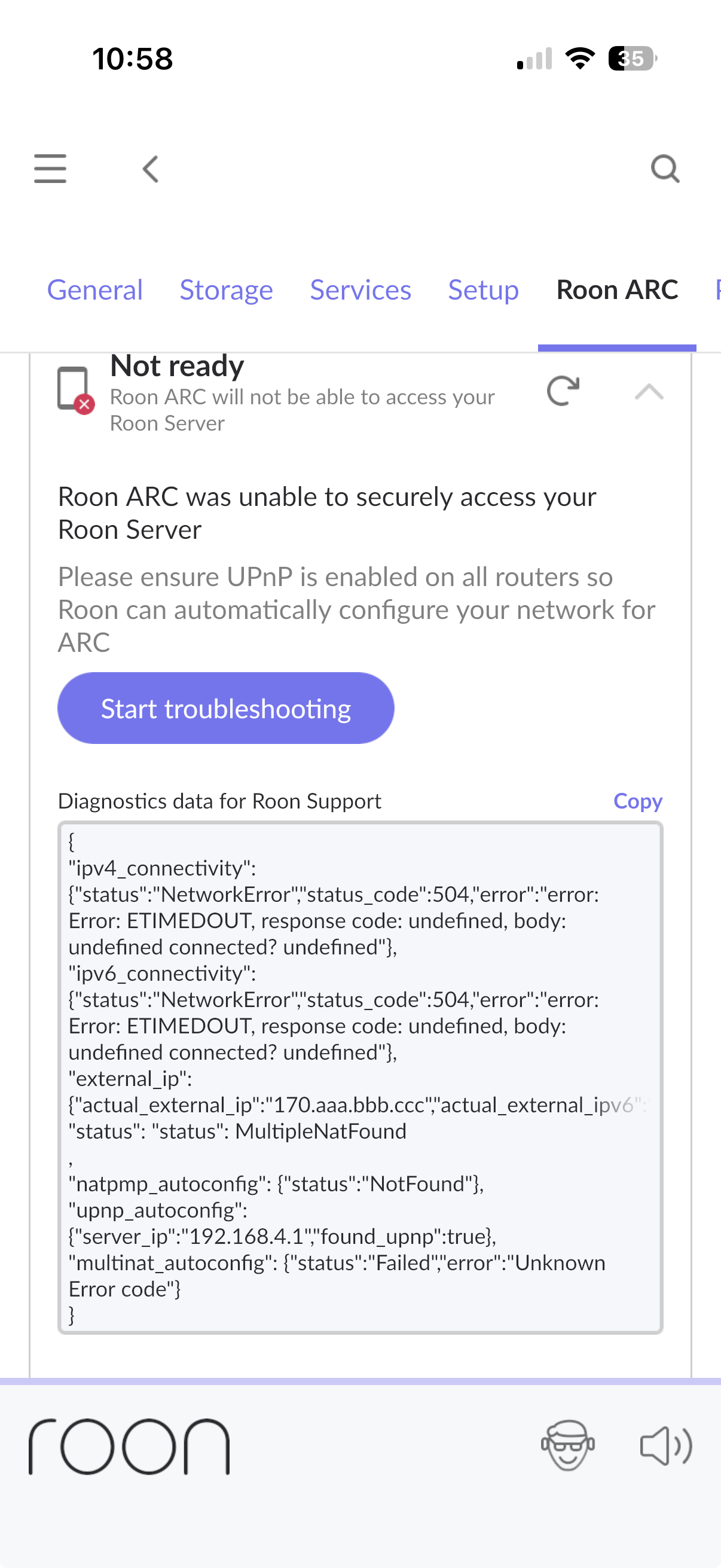

· I use my ISP's router alongside a personal router.
ARC Status
· ARC is *Not Ready*
Roon Error Code
· “natpmp_autoconfig”: {“status”:“NotFound”}, “upnp_autoconfig”: {“status”:“NotFound”} }
Have you successfully located and enabled the UPnP or NAT-PMP settings in your router's web UI?
· I've turned UPnP/ NAT-PMP on and ARC won't connect
Select the Diagnostic Keyword or Text String
· ClientUPnPError501ActionFailed
"ipv4_connectivity": {"status":"NetworkError","status_code":504,"error":"error: Error: ETIMEDOUT, response code: undefined, body: undefined connected? undefined"},
"ipv6_connectivity": {"status":"NetworkError","status_code":504,"error":"error: Error: ETIMEDOUT, response code: undefined, body: undefined connected? undefined"},
"external_ip": {"actual_external_ip":"170.aaa.bbb.ccc","actual_external_ipv6":"2606:ddd:eee:fff:ggg:hhh:iii:jjj","router_external_ip":"100.65.173.119"},
"status": "status": MultipleNatFound
"natpmp_autoconfig": {"status":"NotFound"},
"upnp_autoconfig": {"server_ip":"192.168.4.1","found_upnp":true},
"multinat_autoconfig": {"status":"Failed","error":"Unknown Error code"}
Eero 7

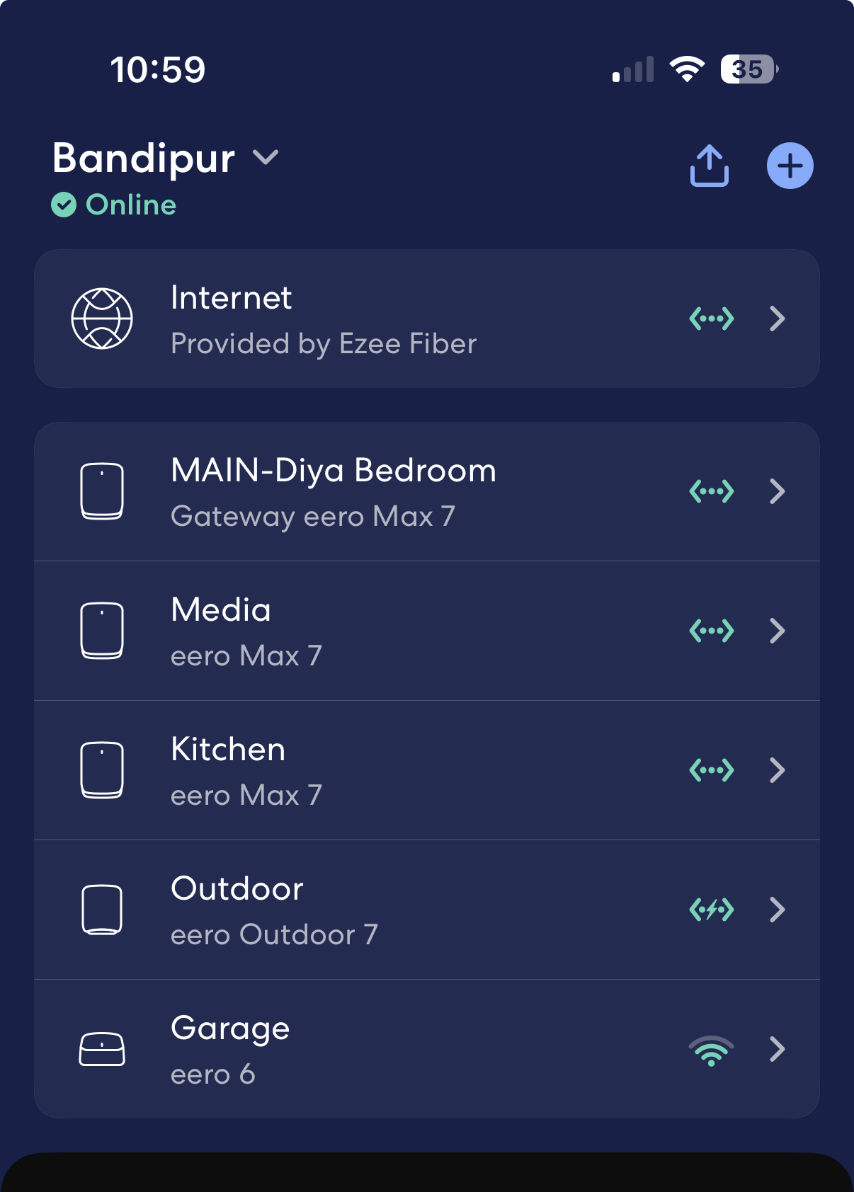

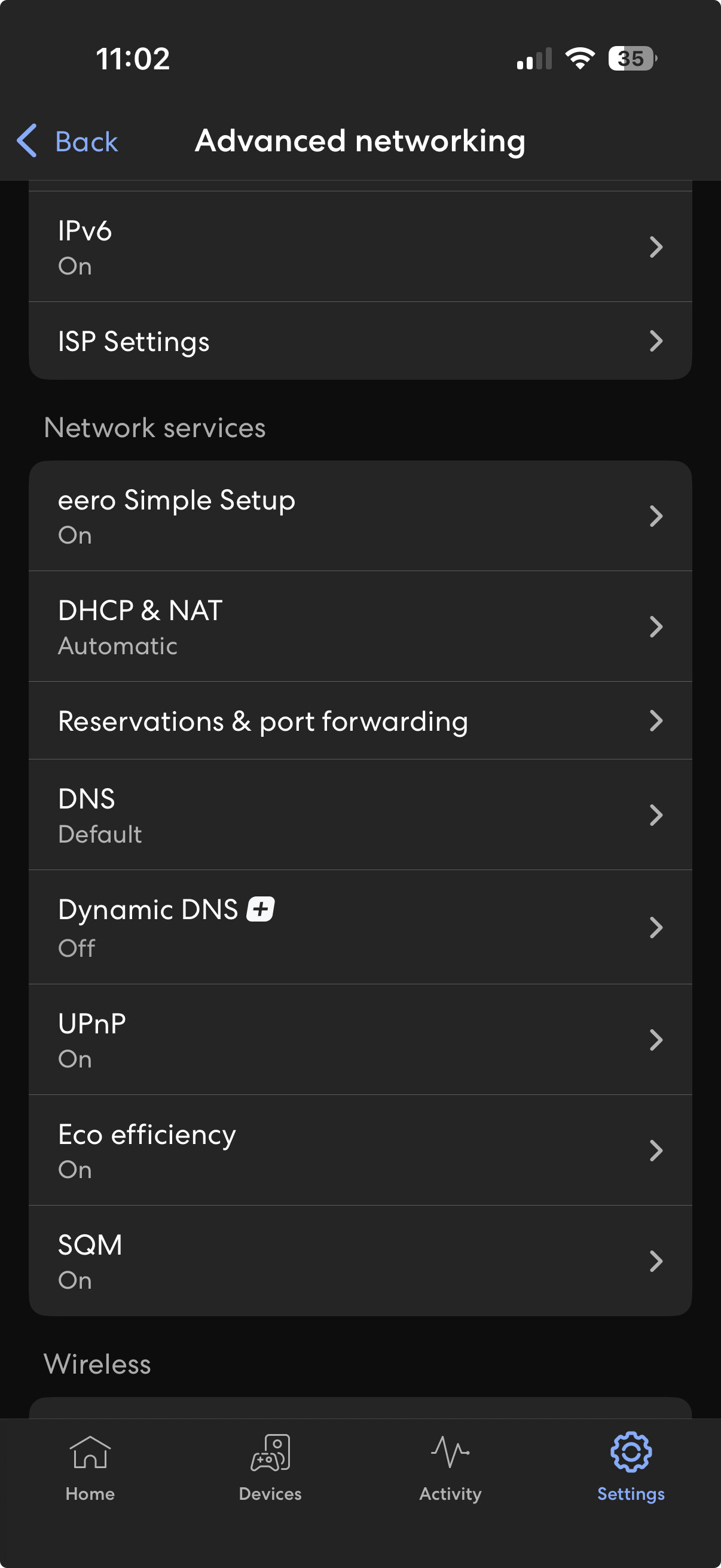

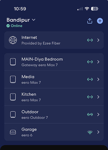

Hello Customer Service,
Please see the screen shot for Step 1-This is from Roon App

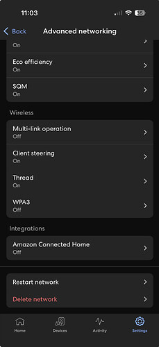

Step 2- this is from my Eero App
Step 3.1-Eero App, Advanced netwroking
Step 3.3-Eero App, Advanced networking continuation.
I am still getting error and cannot get the Roon Arc working.

This line in your original post indicates that your ISP is using CG-NAT because your router is being assigned an IP address in the range 100.64.0.0 to 100.127.255.255 which is reserved for CG-NAT.
With CG-NAT involved you will be unable to get port forwarding working unless you talk to your ISP to get them to offer a solution (some do, some don’t. Many charge extra for their offered solution).

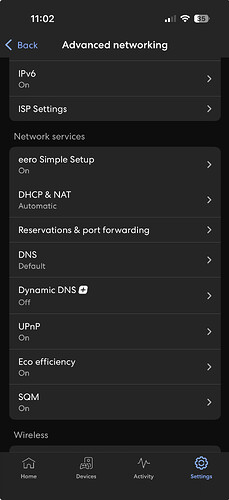

I am checking in Router Advanced setting and it has “DHCP & NAT”. The option I have under that is; Automatic, Manual IP and Bridge. Is this something I can change and make it work.
Thanks
KP
Hi @kdp.bangalore
That setting on your router is not the root cause here.
Your diagnostics show this IP:
  • 100.65.xxx.xxx
That range means your ISP is using Carrier-Grade NAT (CG-NAT). This is done on the provider’s side, not on your router, and it prevents port forwarding from working — even if UPnP / NAT-PMP is enabled.
Changing the DHCP & NAT mode on your Eero won’t fix this. The only ways forward are:
  • Ask your ISP for a public IPv4 address (or CG-NAT opt-out), or
  • Use a workaround like Tailscale instead of port forwarding.

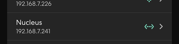

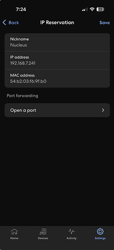

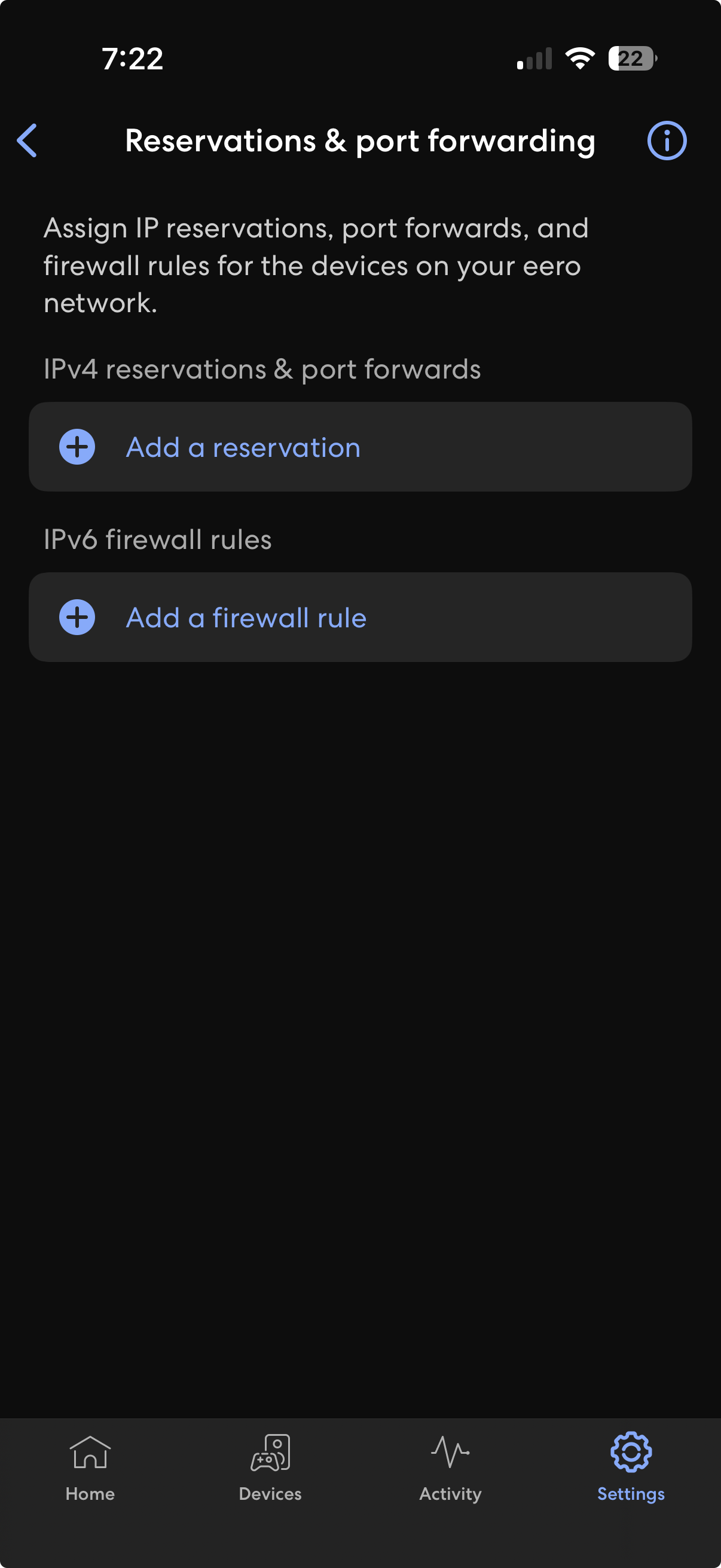

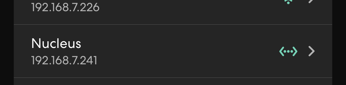

Wade, Thanks your directions. This is going to be a challenge to me. Anyways, I found that I can open the port to the Nucleus
AddProcessing: Screenshot 2026-02-04 at 7.27.08 AM.png…
images
in the EERO router. Please see the attached screen shot and let me know if this is possible through this route. Thanks KP
As has repeatedly been said above, port forwarding, or opening the port, will not work in the presence of CG-NAT.
Since CG-NAT is implemented and managed by the ISP, there is no setting that you can employ on your router that will make it work.
The only option you have is to ask the ISP if they can provide a true public IP address without CG-NAT or to use Tailscale.
