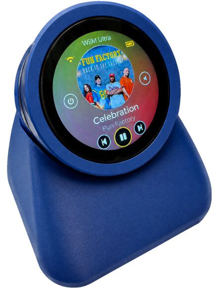

Some âfodderâ for the 3D printer:
Prototype of a docking station for RoonPilot with magnetic USB connection. Simply insert it and take it out again.
Georg
wow super cool, will you be wiling to share the stlmodel?
thx!
