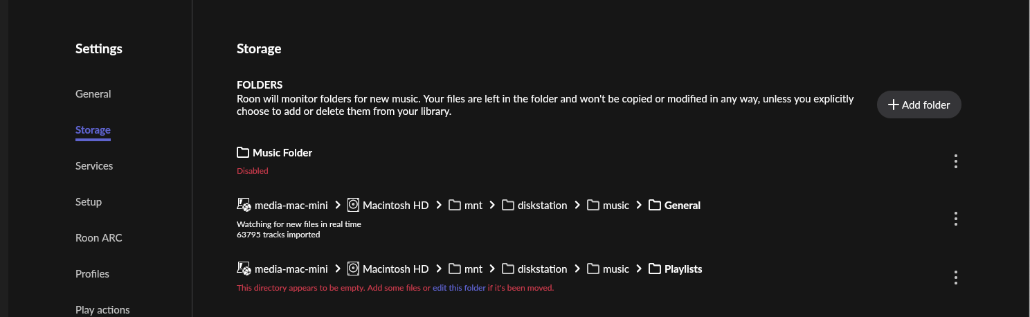

I am running an M4 Mac Mini in headless mode - That is, it uses headless hdmi dongle in the back so it can sit in my server cabinet attached via ethernet and be accessed using screen share.
This works fine for my music files that Roon accesses - One small issue was if I let the screen lock it would disconnect from all my Sonos devices - anyway enabling continuosly on fixed that,
The music files are added using autofs using nfs from my Synology NAS to mount network shares - the Mac Mini is on a static IP4 address - I use pfsense as my firewall. This is fine too, all the music is detected when I force scan.
The only issue is when I add new music I have to Force Scan the storage to detect it.
Any ideas how to fix this ?
I think file system changes can only be auto-detected on internal storage, USB or NAS drives must be manually scanned for changes, as you’ve found.

All working fine now thank you. I was having a few issues with the scanning slowing down and Roon becoming a bit unresponsive (tracks being skipped, a lag on moving around the Mac App) so I restarted the server and it seems to have fixed everything including refreshing the Arc app - maybe a process was locked.
