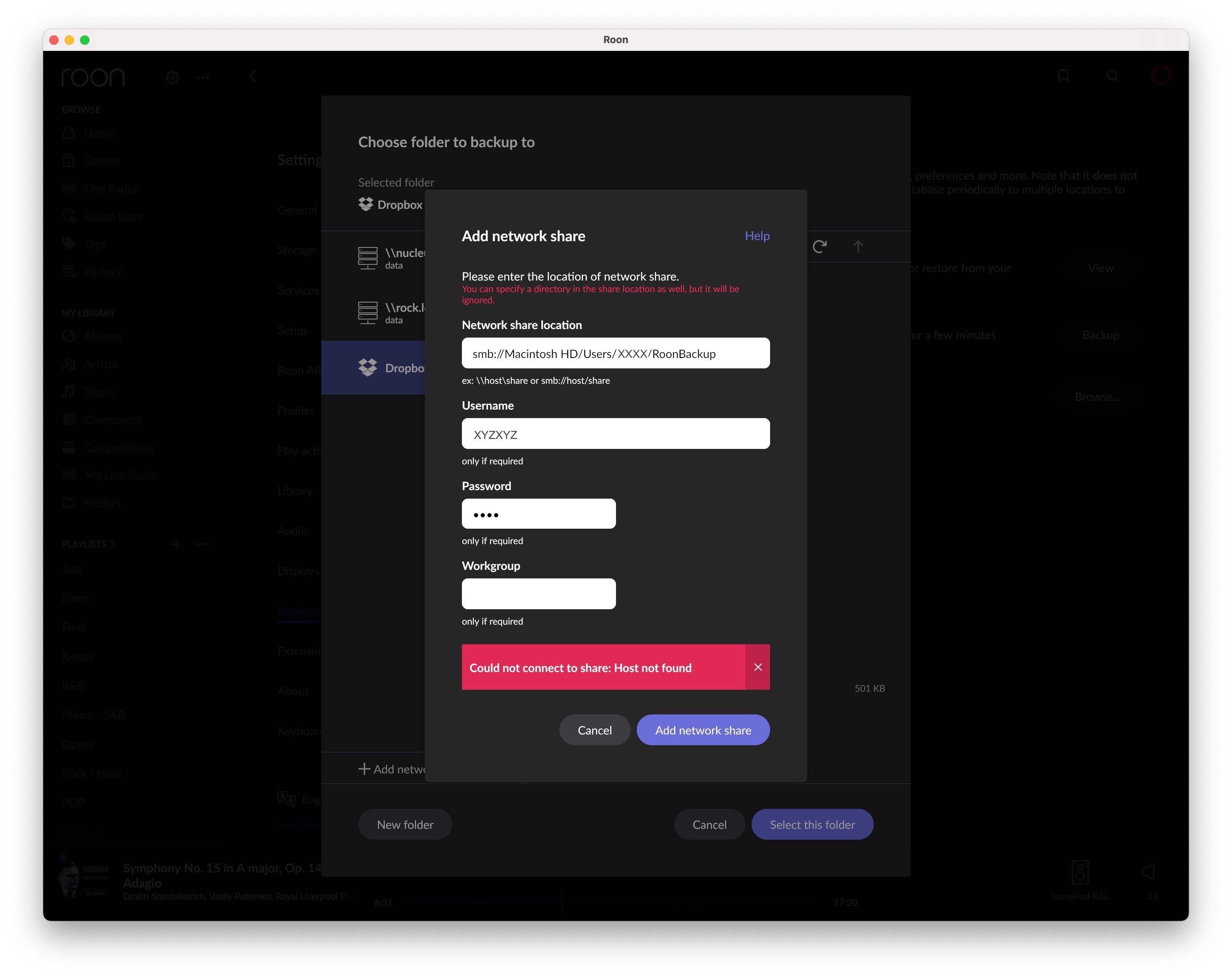

This topic is exactly addressing part of my problem. So far I did a backup on an external HD and on Dropbox. But Dropbox is kind of too small for multiple copies. I wanted to do my backup directly on to my Mac.
So I created a folder, added sharing and so on but I constantly get an error message.
Anyone any idea what I do that is wrong?
You used the name of the Mac’s hard disk, „Macintosh HD“, but you need to use the network name of the computer (the host).
The name of the disk is not known on the network, that’s why you get „host not found“ when it looks for a host named „Macintosh HD“.

can’t find it were the issue is.
I tried my IP address, that seemed OK at first but I found the backup again in dropbox, so no, can’t find the correct things to type
with smb://192.168.xxx/RoonBackup it looked OK but ended up in Dropbox
if I tried smb://192.168.xxx/User/my name/RoonBackup would not take it

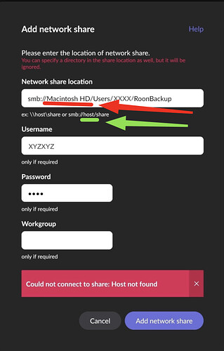

You entered the name of your Mac’s hard disk (red highlights in the following screenshot)
What you have to do is to use the Mac’s network name, i.e., host name (green highlight pointing out the example)
If you don’t know or can’t find out the host name, then using the IP is a valid alternative. (The router will normally asign a human-readable host name to an IP, so that one can use the host name for convenience; referring to the host name also means that it does not matter which IP the machine has, as the router sill always associate the host name with its currenlty correct IP)

You made progress by using the IP - Roon can now find the Mac over the network, but not yet the shared folder. This now an entirely new and different problem, to which you couldn’t even get previously (because it already failed earlier when trying to find the Mac in the first place).
Please follow the documentation I linked or at least the example given in the window. I.e., use smb://host/share, meaning first the host name or the IP as you did, then the name of the (ideally new) shared folder that you shared on the Mac.

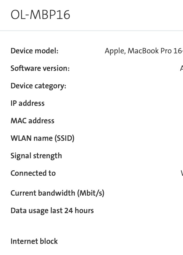

I checked on my router as what my Mac is seen
here is what I see:
so I imagine my host name is OL-MB16. which is also what I see in finder. But then again does not work either, whether I add Users, or shared or RoonBackup or anything… getting desperate.

Finally it worked. Thanks so much.
Here is what I was doing wrong:
smb://«hostname»/«shared folder name»
(the hostname can be found System settings>General first line Name…
Then I thought I needed the whole file system path. But that was a mistake, you only put that shared folder name after your host name. Seems actually the safer way too.
