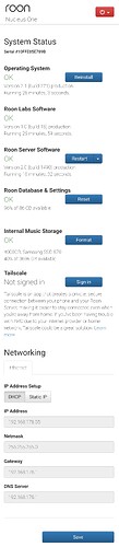

Says this.
Is that good?,

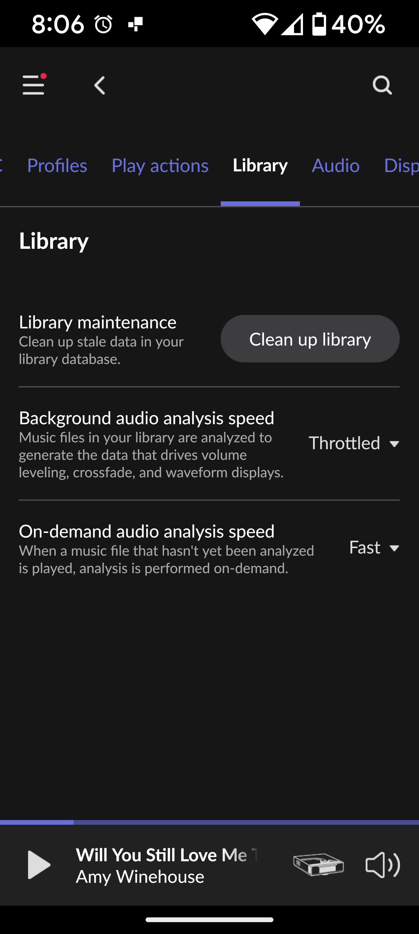

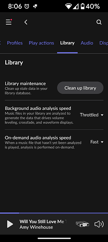

I second the comments about looking at the Audio Analysis settings. This article might also be helpful in understanding the impact of the settings:
You have a red dot. That means usually something is not right either not backing up or can’t connect to Roons servers. Click on that and see what message it gives. Analysis seems to have finished.
Red dot was failed backup to usb stick.

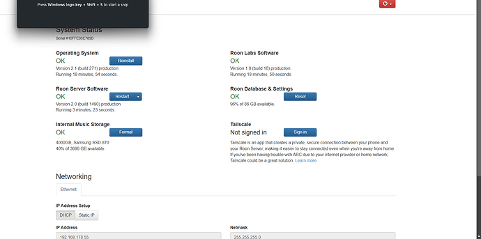

If your issues persist, could you please access the webUI of your Nucleus, and share a screenshot? Here’s more info on this:

I updated to 1490 but can still crash server at will. All I need do is go to albums and start scrolling through them. Or even just use the alphabet bit and slide down to something.
I did it at 12.13am today and server shuts down and reloads.
Attached is screenshot at 00.30
Did another crash at 00.31 (again just scrolling through albums same)
Crashed again just looking at a few links :pensive:
