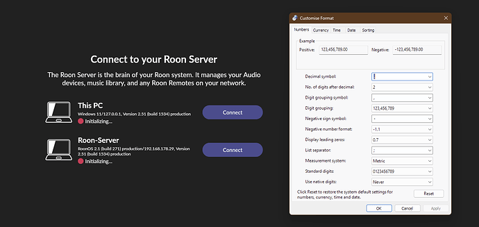

I got a new Nucleus One to move my roon installation from my Desktop-PC to a dedicated server.
I followed this guide for migration and created a backup on USB, formatted the SSD through the network-interface, moved my music to the SSD through the network-storage path and then first connected to the Server through the Roon-App on my Desktop.
I installed the backup from the stick, and after a while the Nucleus told me it was done and wanted to reboot but after that it’s stuck with “Initializing…” and the “Connect”-Button is greyed out.
After some tries with various combinations of reformatting the SSD again, first setting up the Nucleus without the backup and then importing it afterwards, reinstalling the OS and some more I started looking at the logs. For some reason they all are 2 hours off and using UTC even though the 2nd line in the log indicates that it should be possible for local time to be different than UTC.

Hi @Hannes93 ,
Thanks for the report here. I looked through our ticketing system, but I don’t see the error you listed as previously reported before, so it looks like we are dealing with a novel error, I am escalating this to the team for further review. Can you please confirm if what time-zone/calendar type the previous system used? Was it standard US/European or something more different such as the Thai calendar?
Windows says I’m on UTC+1 (timezone automatically set and time shown is correct) but that doesn’t make sense to me as I’m on GMT+2/CEST which is supposed to be UTC+2, isn’t it?
I was looking through the settings in the server on my Desktop to see if there’s a way to manually set the timezone but couldn’t find it as part of my own debugging-attempts
Location is set to Germany, locale/language to ENG (UK) which also sometimes confuses software I use.

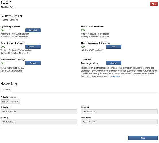

Seems like the time-difference seems to mess with the connectivity of the device as it’s connected to a router via ethernet and has no problems to be connected to through the local network and the router is not instructed to block any connections and even instructed to give the Nucleus priority access
It’s set to use IPv6 connections whenever possible which also can create problems with some applications.
I also gave the Router Permission to allow the Nucleus to set it’s own port-forwardings if necessary with the router but it didn’t do that as far as I can see
This is correct for Germany. You may be confused because daylight saving time is currently in force.
And RoonOS always uses just UTC 0 without any correction for location.
I just thought there might be a difference between the local time and what Roon Server uses since the 2nd line in the log after booting is always like this:
05/23 07:50:40 Info: Local time is 05/23/2025 07:50:40, UTC time is 05/23/2025 07:50:40
and it fails to identify the local time correctly
Just reset the DB once more, set the IP to static (same one I told the router to use) and fixed the DNS-Server to 8.8.8.8 instead of leaving it to the Router. Then instead of restoring the backup I started the login-process and de-registered the Desktop-Server but then went back and restored from the backup once more.
Now the warnings about connection errors in the RAATServer log are mostly gone, only one Warning remains:

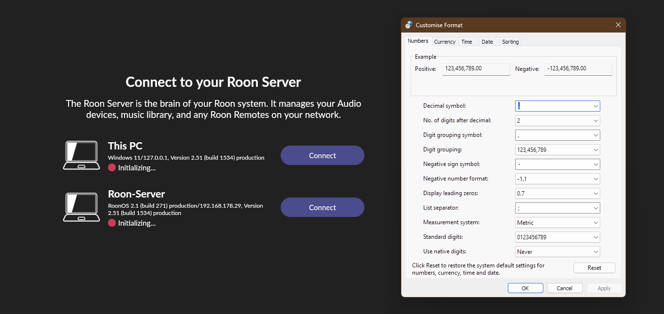

Could it be that
offset_utc_minutes = 119.99999993833333
is the problem since in my locale a . is used for 1000-markings and not as decimal separator so on reboot that number is interpreted as 11999999993833333 and creating that
System.ArgumentOutOfRangeException: The added or subtracted value results in an un-representable DateTime.
Error?
Just guessing and trying to help fix things since right now I have a pretty expensive piece of hardware doing absolutely nothing for me :smiley:
100% sure it’s the dot and comma thing as I change them around in my windows-locale trying to create a backup with them reversed and now my Desktop-Server is in the same “initializing…”-loop as the nucleus

I understand that a permanent fix that prevents this from happening takes time. Something like support for multiple decimal points at the same time is not trivial - I get that.
I just thought it’d be possible to force-change the locale on the Nucleus to the same locale as my Desktop or to manipulate the backup in a way that that’s the case without me having to wait for the next release-cycle.
Hi @Hannes93 ,
The Nucleus uses UTC time and a standard date format. If you switch your Desktop to standard date format, it may work to restore the backup. That said, our QA team has been able to reproduce this issue on their end and are working on getting the ticket prepared for dev team review, though we are unable to provide any specific timelines of when it will be addressed (and do keep in mind that the first release cycle will always be to the Early Access program, only then after to Production).
I tried to change the decimal-point setting in Windows in order to create a Backup with the “standard” settings but then my Desktop-Installation wouldn’t start anymore
