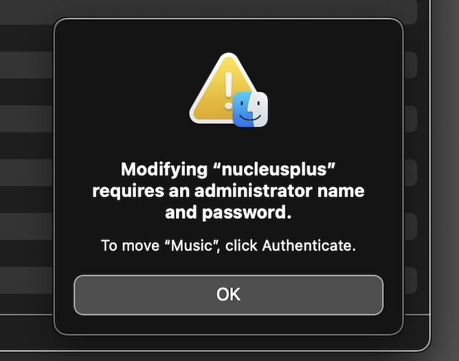

I attempted to drag and drop the music files from my NAD to the Nucleus+ only to receive this message:
Unfortunately, I couldn’t find “Authenticate”, much less click it. Is this a Mac Permissions restriction? -David
You have two drives in your Nucleus, right? Are you trying to put your music files on the wrong drive (the M.2 drive that holds the OS), maybe?
Thanks for your response Soylent. I’ll investigate further and let you know the results. -David
Thanks to Rugby again for helping me locate my internalstorage folder. I tried dragging/dropping my music files there, but no dice. My Nucleus+ came with a 4TB ssd. It occurred to me this drive might need to be formatted(!) I attempted to do so, but was stymied by the Roon web interface. I haven’t had any epiphanies about how to proceed.

Yes that’s right, Soylent. The OS is on one drive and the internal storage drive (the other) will be home to nothing but my music files.
This is a display from my ROCK installation, but the Nucleus Web GUI should be similar. Did you click the 'Format" button under 'Internal Music Storage"? If so, what happened?
