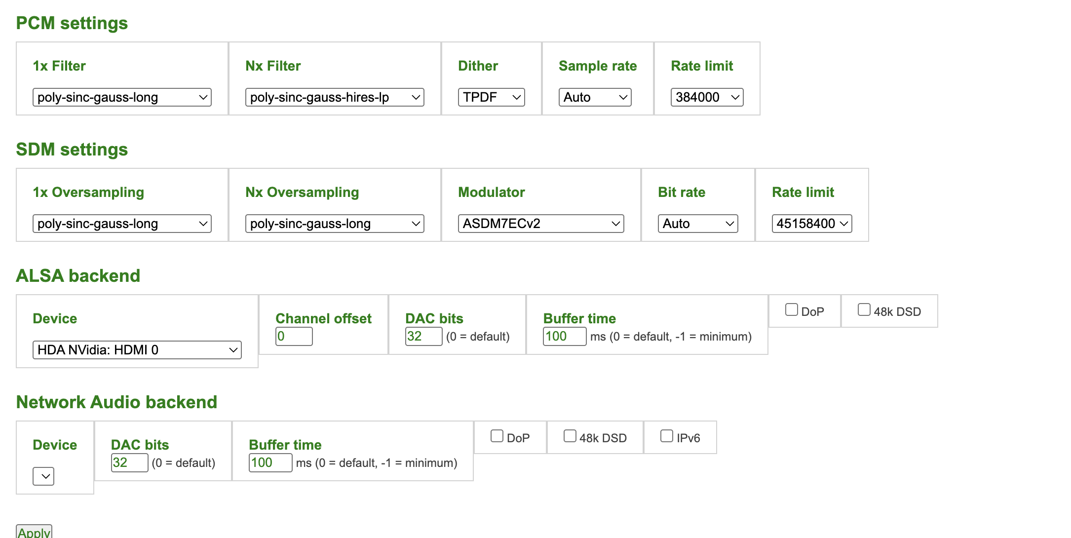

I just upgraded from my NUC to a dedicated PC for HQPlayer. Despite the significant spec upgrade, I’m running into stuttering even on relatively basic settings. So I suspect that I made some mistakes in the setup or in the config.
Setup:
  • PC: i9 14900KF, RTX 5070Ti, 64GB RAM, Ubuntu Server 24.04 LTS, HQPlayer Embedded
  • TIDAL via Roon on separate server (NUC i7)
  • NAA: RPi 4 with latest NAA Daemon
  • DAC: Holo May KTE
  • Everything connected via Ethernet, NAA->DAC via USB

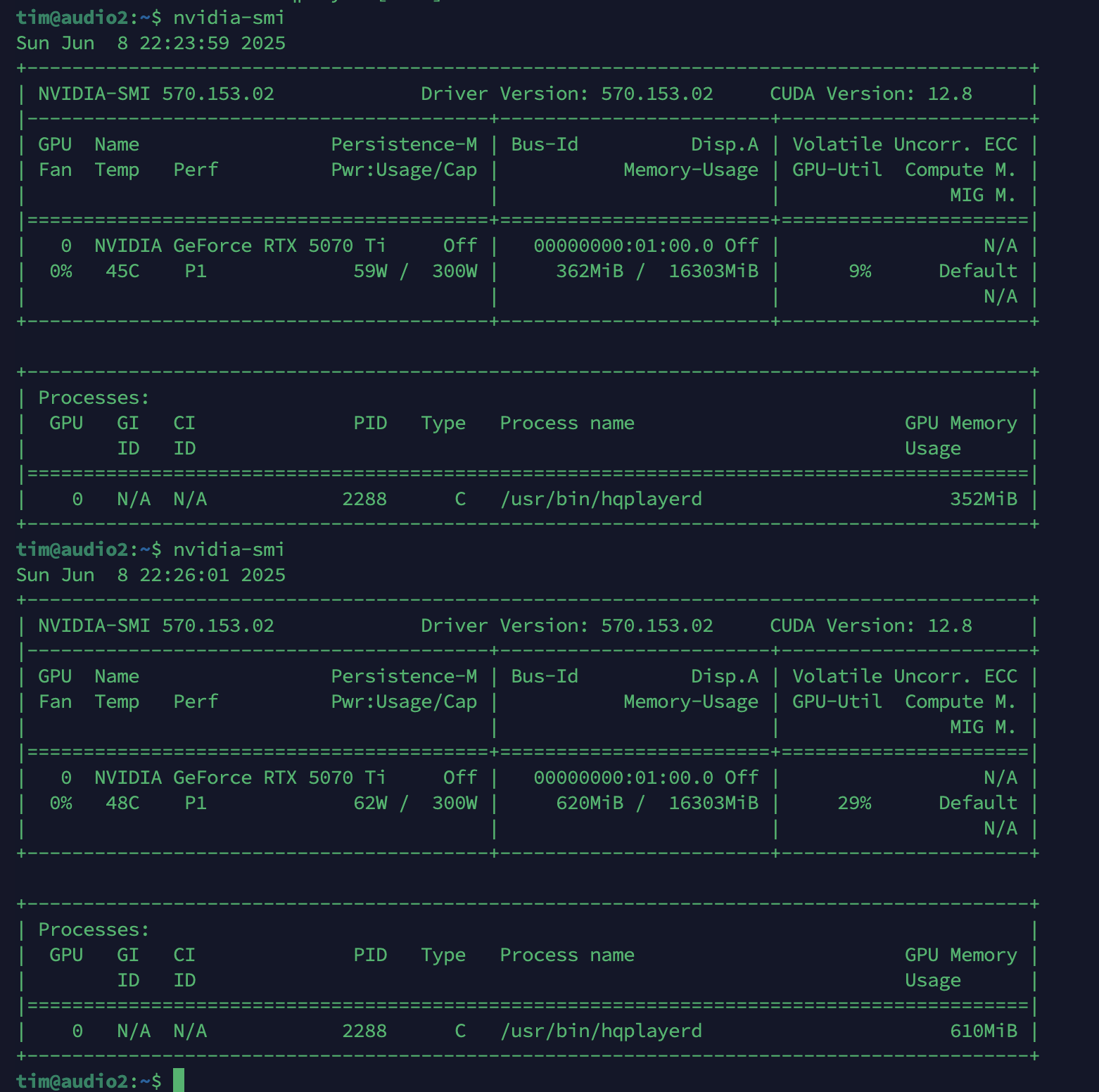

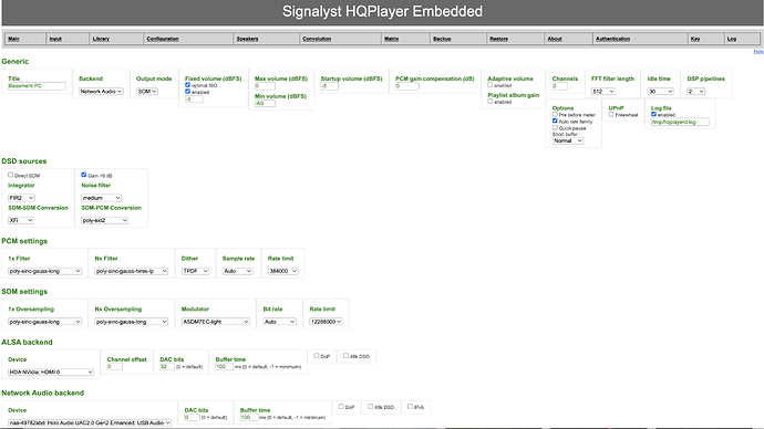

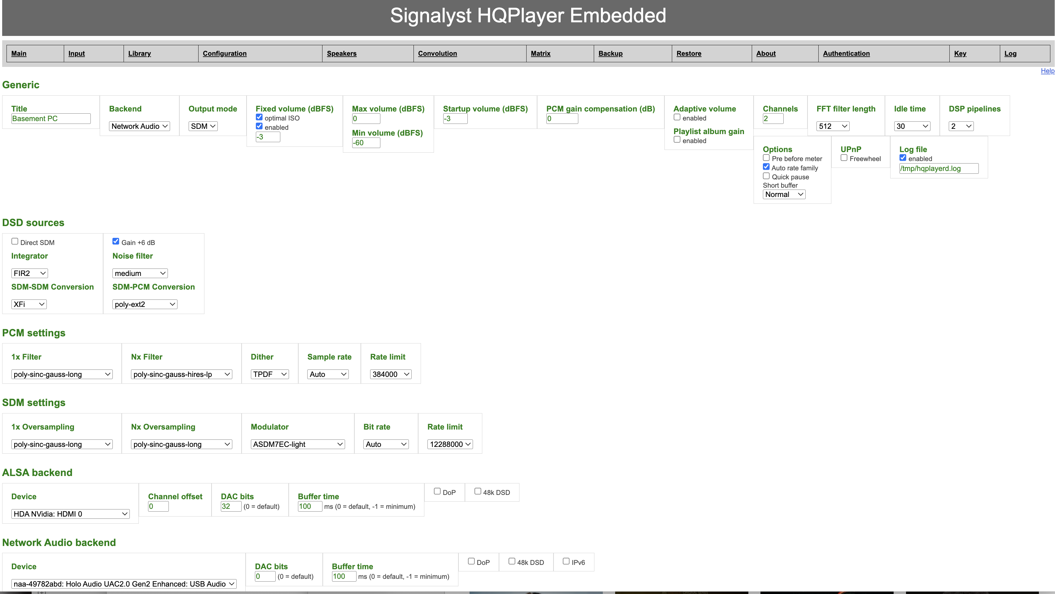

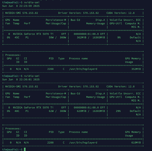

Screenshots attached of config, matrix, Nvidia diagnostics during playback.
Thankful for any pointers that could help me find the mistake or bottleneck!

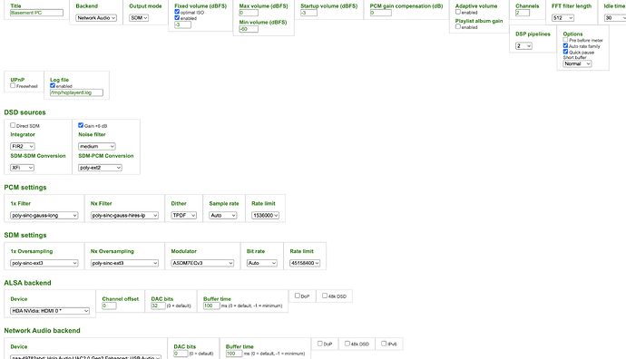

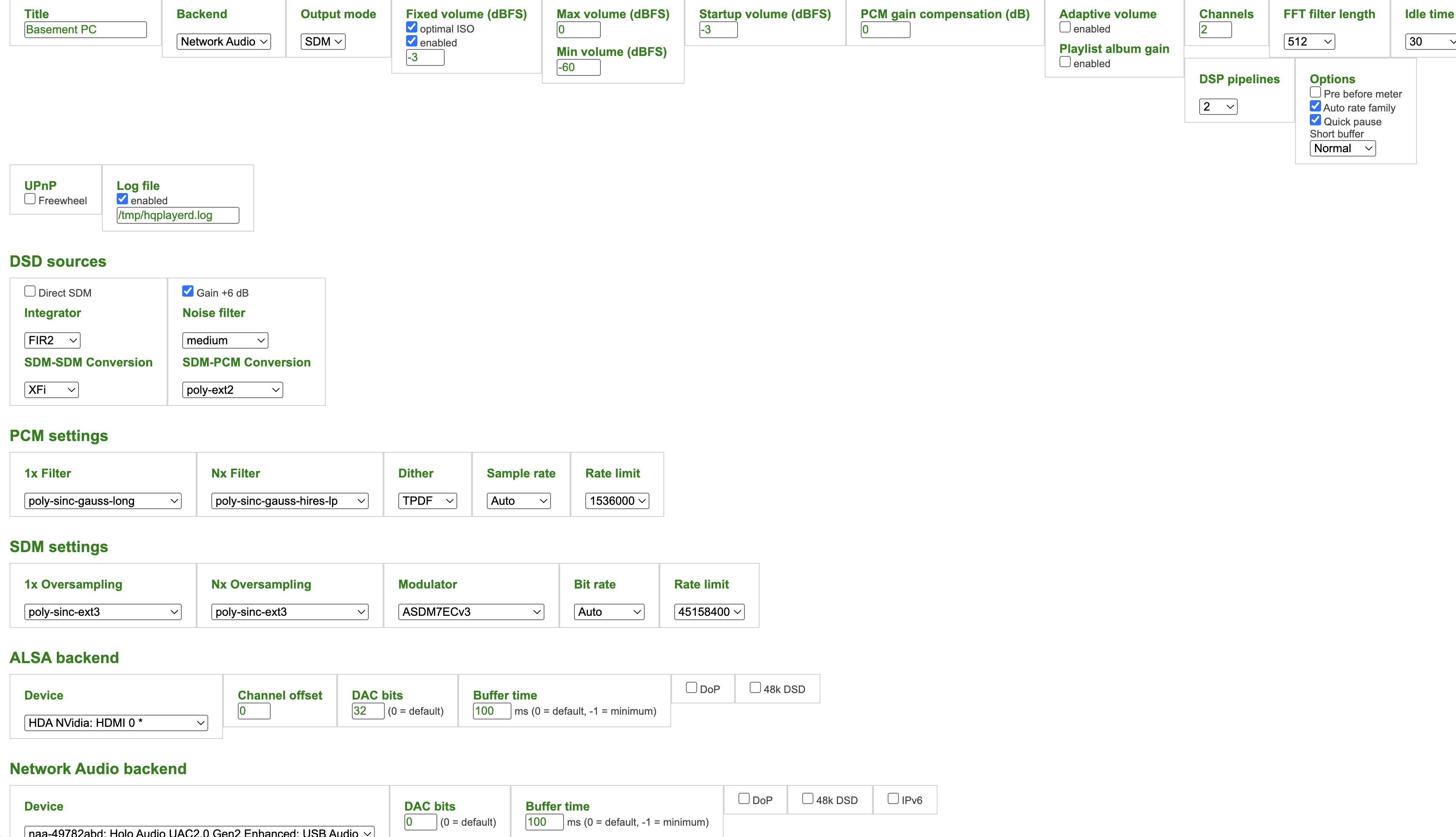

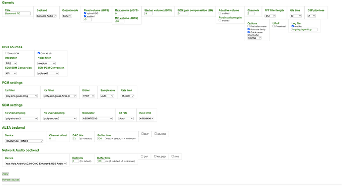

Fixed it - turned out to be a LAN issue. Now it plays DSD512 with ext3 and ASDMECv3 + DAC Correction and sounds amazing.
New issue: when I switch to DSD1024, even with lighter filters and modulators, I am getting slowed down and extremely distorted/screechy playback. Since the above works without any stutters, I can’t imagine it’s purely a performance issue.
Any ideas what the cause for this might be?

Are there any diagnostics I can run on the server or NAA to get closer to the root cause?

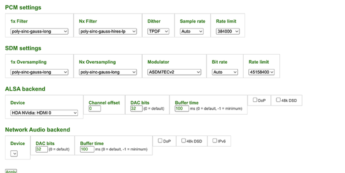

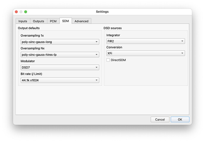

HQPlayer settings:

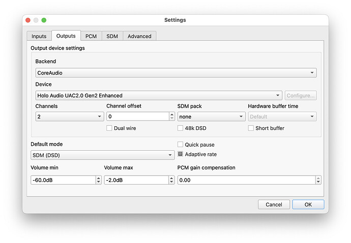

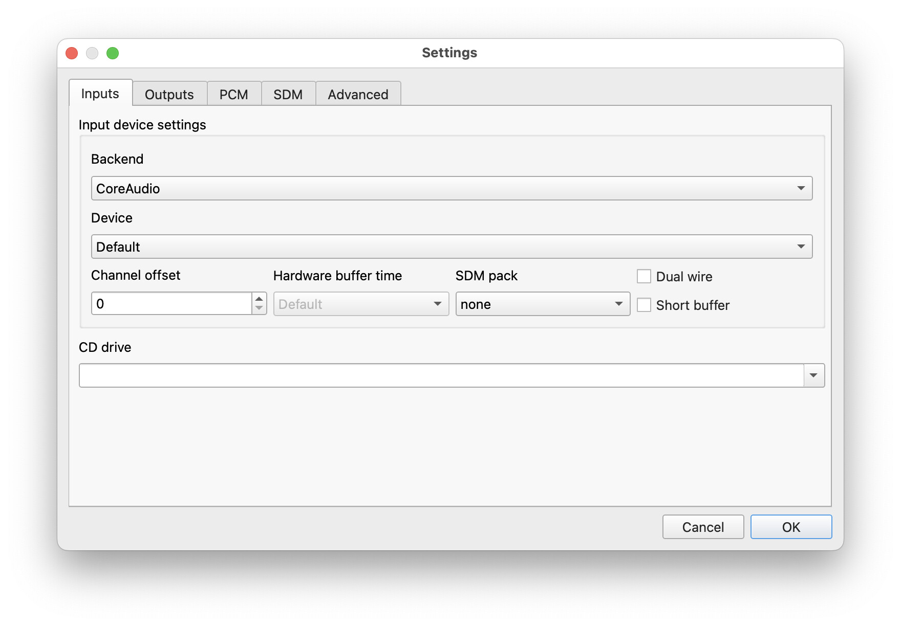

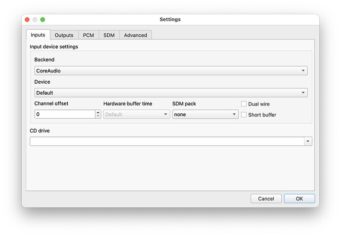

  • Mac directly connected to Holo May via USB (incl. USB C-A dongle) w/ HQPlayer Desktop. Local WAV file 44.1kHz. Despite setting it to DSD1024 (and once even to DSD2048), the May’s display only shows 768X. Plays without distortion though.
Curious if the above Desktop observation can give us any indication towards the root cause of the distortion in DSD1024, in addition to the conditions I shared in post #11.
AFAIK on Mac the max DSD using usb is dsd256/DoP
If you want to reach dsd512/1024 you should use a NAA on the network
Got it, so then that test might not add indicators to diagnosing the issue I’m seeing via NAA. Curious if any of the points in post #11 could help?

I don’t think you are going to get DSD1024 easily with ASDM7ECv3. I recommend to try one of the newer modulators that recently got some more optimizations, IOW, ASDM7EC-ul/light/fast/super. The -fast or -fast 512xfs is the recommendation.
ext3 is roughly equally heavy to gauss-xl(a). So I would recommend to get started with the current default 1x=poly-sinc-gauss-long Nx=poly-sinc-gauss-hires-lp and then if you want, change it from there.
But with these you have some known performance baseline.
I also tried with poly-sinc-long and DSD7, had the same distortion issue. Those should work with 1024 on a 14900KF + RTX5070Ti server, right?
