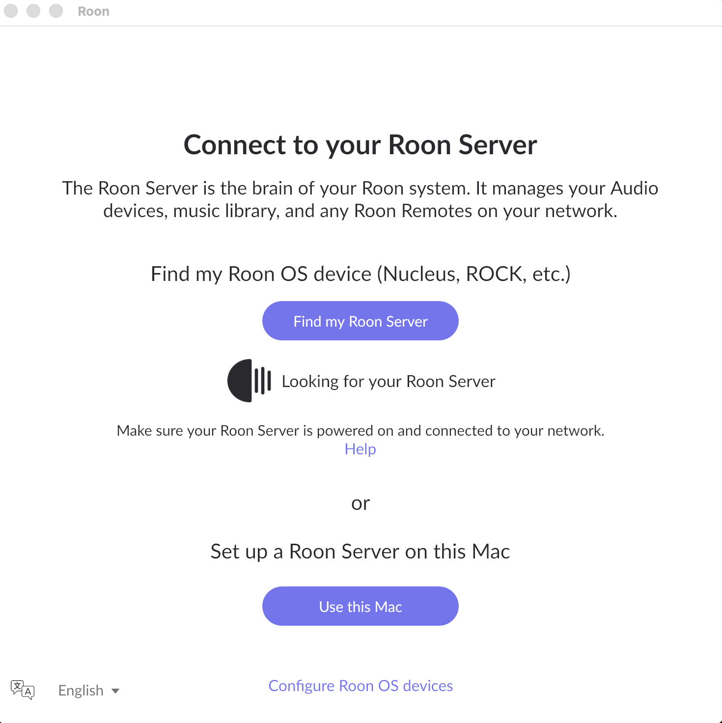

Next, I launch the Roon app on my laptop (macOS), but unfortunately, Roon Server is not detected. What did I do wrong? Could you please help me? Thanks!
It took a fair while on my Synology at this point to find the new server. I had to quit, then restart Roon on the Mac a few times before it found the new server. If you’re running an active firewall perhaps disable it temporarily.
Restarting Roon multiple times makes no difference.

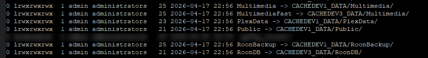

It actually depends on the folder names and hierarchy of this particular NAS. You can create a top-level folder named /Music/ for you music, or use a subfolder of /Multimedia/, which seems to be preinstalled on many QNAP NAS´ primary volume.
You could use the internal names if you want,
but its not DataVolX –> it’s CACHEDEVX_DATA on QNAP
(you can only check this via SSH afaik, I never found a way in the GUI to get this, only in SHH)
/share/Container/roon:/Roon
/share/Music:/Music
/share/Backup/Roon/NAS/RoonBackups:/RoonBackups
