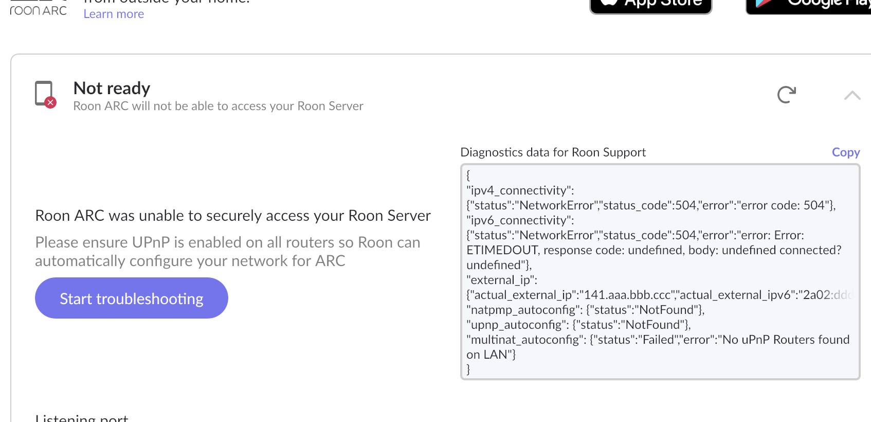

· I am a new Roon user, and installed Roon Core on NAS Synology.
I use 1 ISP Modem F@ST3896LG-TN, tried UPnP: did not work
Port forwarding: TCP connection, internal and external port 55002: other working.
Error message displays:
"ipv4_connectivity": {"status":"NetworkError","status_code":504,"error":"error code: 504"},
"ipv6_connectivity": {"status":"NetworkError","status_code":504,"error":"error: Error: ETIMEDOUT, response code: undefined, body: undefined connected? undefined"},
"external_ip": {"actual_external_ip":"141.aaa.bbb.ccc","actual_external_ipv6":"2a02:ddd:eee:fff:ggg:hhh:iii:jjj","router_external_ip":"null"},
"natpmp_autoconfig": {"status":"NotFound"},
"upnp_autoconfig": {"status":"NotFound"},
"multinat_autoconfig": {"status":"Failed","error":"No uPnP Routers found on LAN"}
· I have VPN, but is not activated for NAS. NAS is connected through a D-link switch (but I have no idea how to work with that). On NAS Plex server installed: remote service working

  1. CGNAT: WAN IP and check whatsmyip = IP address is the same → = okay?
  2. DSM Firewall: I disabled the Firewall, but I am using Docker and setting is “host” → okay
  3. Port forwarding: UPnP not working, disabled that. I tried manual port forwarding; setting local IP address 192.168.x.x external and internal port 55002 to 55002, TCP → enabled but Roon ARC can not connect to the server In the Roon ARC settings (client), listening port ‘Roon Server IP” is same as port in port forwarding, as is the port itself (55002) NAS has a static IP (same as local IP) Error:
{“ipv6_connectivity”: {“status”:“NetworkError”,“status_code”:504,“error”:“error code: 504”},
“ipv4_connectivity”: {“status”:“NetworkError”,“status_code”:504,“error”:“error code: 504”},
“external_ip”: {“actual_external_ip”:“141.hhh.iii.jjj”,“actual_external_ipv6”:“2a02:aaa:bbb:ccc:ddd:eee:fff:ggg”,“router_external_ip”:“null”},
“upnp_autoconfig”: {“status”:“NotFound”},
“multinat_autoconfig”: {“status”:“Failed”,“error”:“Network Trace Failed”}
  1. Tailscale: tried to install, but doesn’t work either
As I only have 6 days left in my trial, I really hope you can find a solution so I can access Roon outside my house.
Thanks a lot for having a look!

In the meantime, let’s break down exactly what is happening with your connection. There are two key factors in your setup that are blocking ARC from functioning normally.
To be completely transparent, running Roon Server inside a Docker container is not officially supported. While setting the container to “host” networking seems like it should bypass Docker’s internal routing, Synology’s underlying OS architecture still applies virtualized network and firewall rules to Docker containers.
Since you have already confirmed that your WAN IP matches your public IP (meaning no CGNAT) and your manual port forwarding rules are correct, the Docker environment itself is almost certainly intercepting or blocking the incoming ARC handshake.
You mentioned that Tailscale didn’t work either, but there is a very important detail regarding how Roon reports VPN connections.
When you use a VPN like Tailscale, the Settings > Roon ARC tab inside your Roon Server will always display a red error message (like the 504 error you shared).
This is because Roon’s internal diagnostic tool only checks for traditional UPnP or Port Forwarding over the open internet from our servers. It cannot “see” the secure Tailscale tunnel. If you have Tailscale actively running on both your Synology and your iPhone, you must completely ignore the error in Roon’s settings.
To get ARC up and running before your trial ends, here is what we recommend:
  • Test Tailscale directly: Make sure Tailscale is active and connected on both the NAS and your phone. Disconnect your phone from your home Wi-Fi (use cellular data), ignore the error in the Roon settings on your computer, and simply launch the ARC app on your phone. It should connect right through the tunnel.
  • Move away from Docker: If you want to use standard port forwarding instead of Tailscale, you will need to install the native Roon Server package for Synology (maintained by Christopher Rieke) rather than using Docker. This will eliminate the virtualized network layer that is currently blocking the port.
