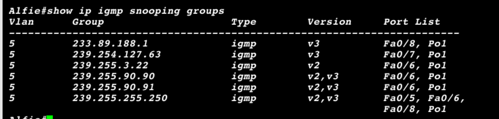

But if you can connect your Roon Core and Roon end points into the 2960… as said above the 2960 has IGMP snooping enabled, and so will see the multicast group messages and should allow the ports to connect to each other with respect to the multicast group data… it might be your router is not doing this for some reason… seems strange in this day and age, but it is what I would try.
BTW this shouldn’t be confused Bonjour or mDNS multicast group IP addresses which usually should be ubiquitously sent to all ports and not filtered by network devices.

If so you can try rebooting or restarting the end point, other than that we need to see some diagnostics. The 2960 is superb here, but you will need to be able to login to your 2960 console… use your favourite search engine to find guides on doing so if you are interested.
As far as NUC vs Core on PC, it’s not so cryptic if different… the network stack including IGMP support will be down to the OS or even firmware. If there is some issue here then behaviour can be different… but the 2960 can confirm this.
I think I posted the console screen shots of the 2960 when doing this check on the Naim forum, which as you know can be a good source of detail and advice.

For reference, here is my Naim Roon endpoint… and the multicast group IP address 239.255.90.91 is set up by my Roon Core , my NDX2 on port Fa 0/6 then joins to that group through my Cisco catalyst switch.
Port Fa 0/6 is enabled for that group using the default IGMP snooping on the catalyst switch.
