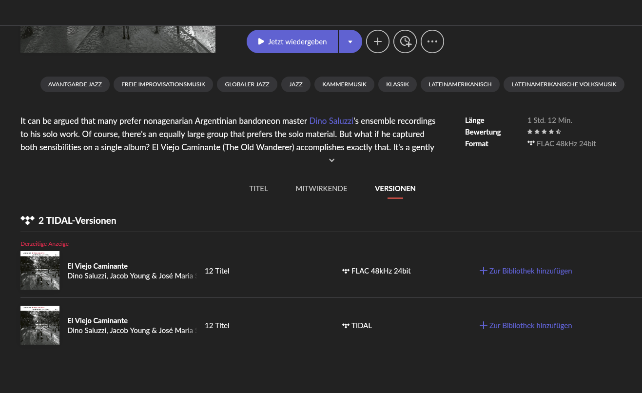

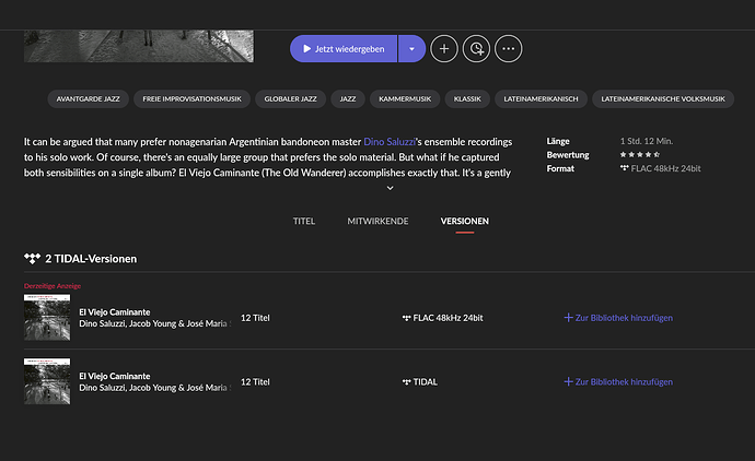

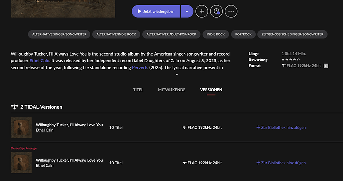

Another thing I've noticed is that two identical albums are repeatedly displayed under “Versions” (for example, Ethel Cain: Willoughby Tucker, I'll Always Love You). Or: one version only shows the Tidal logo, but not the bitrate (for example, Dino Saluzzi: El Viejo Caminante).

Thank you, that clarifies things, but it doesn’t solve my second problem with duplicate album versions and missing bitrate information (see screenshots 2 and 3).
Hi @clicksound,
Thanks for the follow-up! We see the same two versions on our end, this also is something related to updates on Tidal’s end - we simply share the data that is sent to us. This also falls into the missing bitrate / file format information you’re seeing.
We’ll let them know about this as well. Thank you! :folded_hands:

Hi @clicksound, @Riccardo_Sicheri,
Roon’s application logic is only displaying what Tidal has exposed via their API. Sometimes Tidal has an album at the same bit-depth and sample rate from two different distributors - this will manifest as two separate versions in Roon from Tidal, but they are distinct objects as exposed by the Tidal API.
Tidal doesn’t always ingest data cleanly from distributors, and it can take time for corrections to filter down from labels or metadata libraries to the actual Tidal datasets from which Roon receives this data. New releases occasionally don’t have full metadata, in which case Tidal tends to correct and fill-in missing fields after a few weeks. We will escalate any issues to their team if you continue to see this problem.
