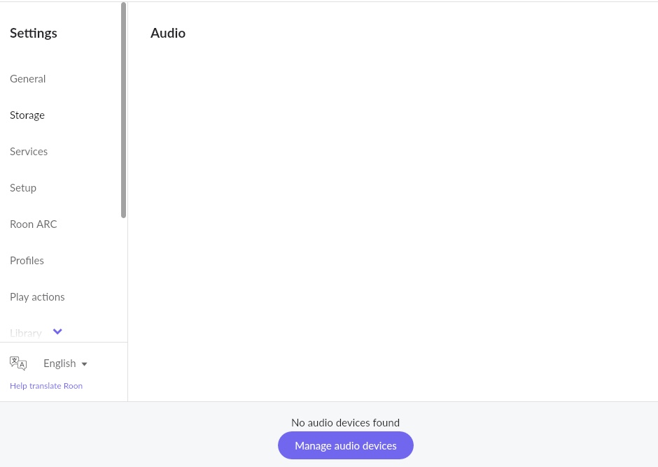

No audio devices after installing 2.71 on Mac Mini (ref#KRI8IM)
· No music or audio devices showing after installing 2.71 (build 1683) on Mac Mini

Thank you for helping out. I saw that post as well but I’m not on Sequoia (I’m on Mac OS Monterey 12.7.6) and the privacy settings described are not available. Also, no music is showing even though I added my music folder and logged into Qobuz so I think it’s more than not being able to find devices over the network.

Hey @Boude,
Thanks for your patience, and my apologies for the silence over the last couple of days, that’s longer than you should have had to wait. We’ve now been through the full set of logs from the Mac mini, and have a clear answer for you.
This isn’t the macOS Sequoia issue, you were right to rule that out. Your Roon Server database is failing to open at all, on every single start. That’s why you’re seeing no zones and no music: the server has nowhere to store or read any of it, so re-adding your music folder and signing back into Qobuz can’t stick.
Here’s the cause. On 6 August your Mac mini started Roon 1.8 (build 831), an old version, from a separate RoonServer.app in your Applications folder. Running 1.8 against a Roon 2.x database rolls the database’s internal version marker backwards. So when 2.71 starts, it thinks it’s looking at a Roon 1.8-era database and tries to upgrade it again, and that upgrade collides with your real, intact 2.x database that’s already sitting there:
[broker/database] ===[ Database Migration (v2 => v3 (roon 1.8) ] ===
[broker/database] ===[ Database Migration (v3 => v4 (roon 2.0) ] ===
Critical: Cannot create '.../broker_4.db' because a file or directory
          with the same name already exists.
The upgrade aborts, the database never loads, and everything downstream, zones, library, settings, even your scheduled backups , fails with it. The logs confirm this cleanly: your database was opening normally at ~608 MB right up to 1 August, and from 8 August onwards the server reports db_loaded=False continuously and never discovers a single audio device.
For contrast, on 6 August under 1.8 your Mac mini’s outputs were all detected perfectly, Built-in Output, HDMI and System Output. So there’s nothing wrong with the machine or the network. It’s purely the database.
Your 608 MB library database is still on the disk and intact, and you also have a clean automatic backup from 31 July in /Users/<username>/RoonBackups. (The backups from 9 and 10 August failed, so they didn’t overwrite the good ones, that turned out to be lucky.)

Ok thanks, I’ll give it a try over the weekend.
So I deleted the Roon server that was still on my Mac Mini. Part of the confusion is that if I understand correctly, Roon does not provide Roon Server as standalone anymore - it’s not available for download on the website - only as part of the Roon app. This is quite poorly explained, I had to search quite a bit and still not sure. I took the risk of just reverting to the July 31 backup and it worked so for now I should be ok. I dread the next Roon update as my Mac Mini is headless and I have to use a monitor that’s in the attic and see if one of my kids has a mouse to spare. I’ve set Roon to launch at startup if I have to restart my Mac Mini after an update (which is often the case) but not confident it will go smoothly. I absolutely love Roon, have a lifetime subscription but this is a headache. If you want every user to buy a Nucleus just say so, most people will get over it.
When I left it last night, a backup was scheduled from 1 am. Checked again today, Mac fan was blowing, CPU usage was around 70%. Restarted my Mac Mini, Roon + Roon Server automatically started up correctly. The red triangle notifying a backup issue is also gone and CPU usage around 10%; it looks like the problems were solved. So for me all good for now, can you please check on your end if you see anything out of the ordinary. Thx
