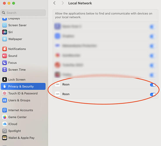

I am having the same issue as @Hannan_Herscovitz. After upgrading to sequoia on both my Roon Remote (macbook pro) and Roon Server (headless Mac mini), my roon remote no longer recognizes any local audio devices on the Roon Remote - including the system output or any connected dac/speakers. The only audio devices that show up are those connected to the Roon Server (which doesn’t help). See attached screenshot.
I have tried toggling the macOS System Settings > Privacy & Security > Local Network off and then on again, with no luck.

I tried that - at least uninstalling and re-installing Roon on the Remote machine, with no luck.
Furthermore, now I have 2 instances of Roon appearing in the macOS System Settings > Privacy & Security > Local Network menu. See below screenshot.
That’s strange.
