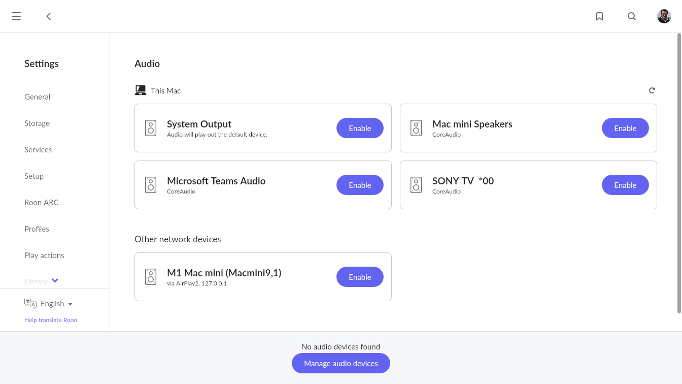

No audio devices found after new router installation (ref#DT6OSS)
No audio devices found - new router because I switched broadband ISP
My Audio Devices have all disappeared since I installed a new router because I switched broadband ISP.
Setup:
EE Smart Hub Plus IPS standard issue router (WiFi disabled)
Various Switches (all Netgear)
WiFi BT Wholesome Mesh Network Disks
Roon Server running on M1 Mac Mini connected via Ethernet.
Most of my Audio Endpoints are connected via Ethernet
Sonos is connected via WiFi
Nothing shows up in Roon anymore.
All my endpoints are working fine without Roon
The troubleshooting was extremely time consuming and almost all irrelevant. I am seriously thinking of cancelling my subscription. This should be easy. It seems overly complex. Does anyone know how to raise a complaint?

Hello.
This resolved the issue thank you.
I’m still a little baffled that it was actually a Mac issue while all I had done was changed my ISP and router. IE it wasn’t anything to do with any settings on the new router, the ISP or the Roon settings or a change in the configuration of my Mac.
