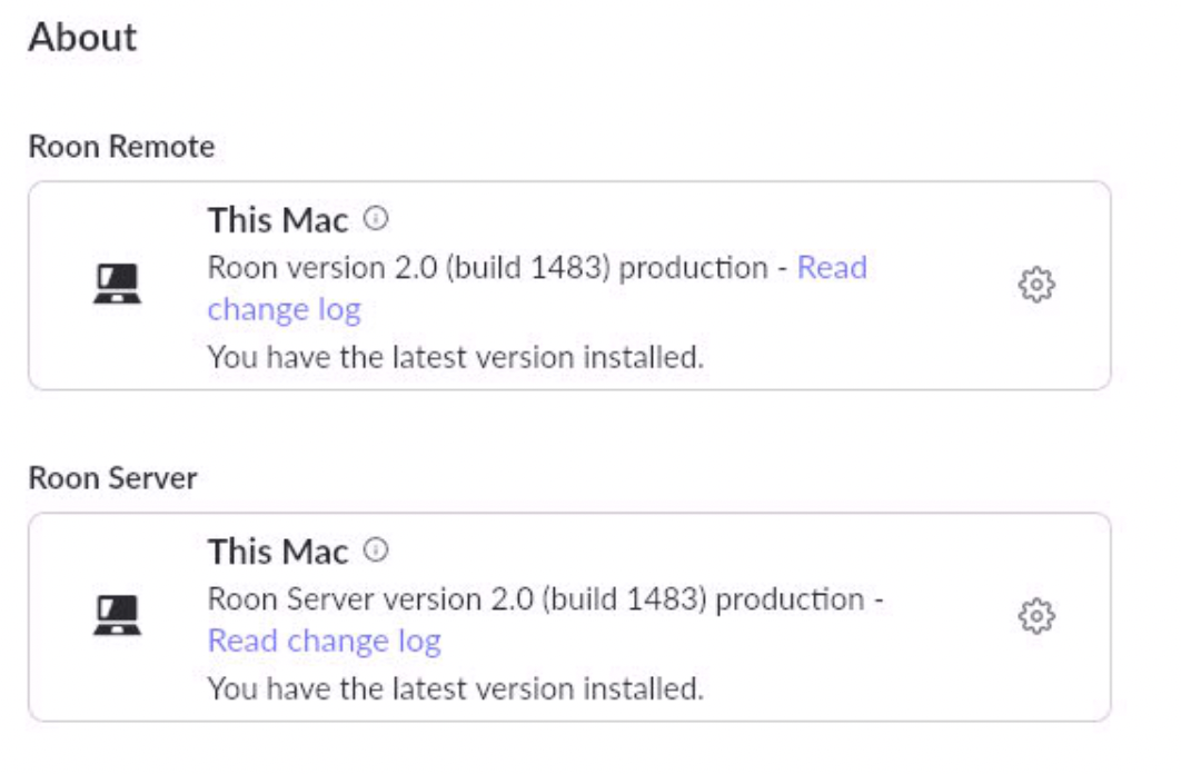

No audio devices found: I came back home from a trip to find that there had been a power cut. I’ve managed to reset everything but Roon will not find the speakers throughout my house, though Spotify has no problem doing so.
I’ve rebooted everything in sight, several times. I’ve deleted and reinstalled Roon on my Mac mini, which I use as a server.

What is the OS of your Mac running the RoonServer?
