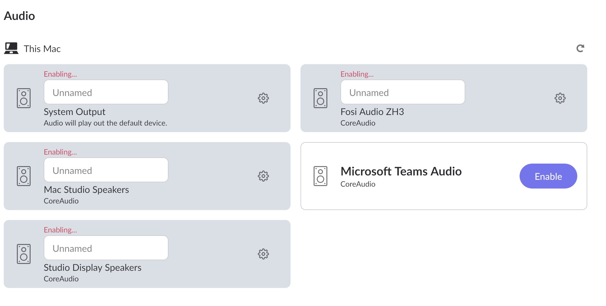

I have updated to Roon 2.60, using a Mac Studio with Tahoe 26.3. I have reinstalled Roon Mac and reinstalled Roon server. Rebooted Mac/router/ROCK multiple times. My iPhone suffers similar problems; it won’t let me play through the iPhone and all the other audio outputs show a red “enabling…”
I also went into privacy and toggled Roon in local networks.
PLEASE HELP ASAP! This was fine until I upgraded.

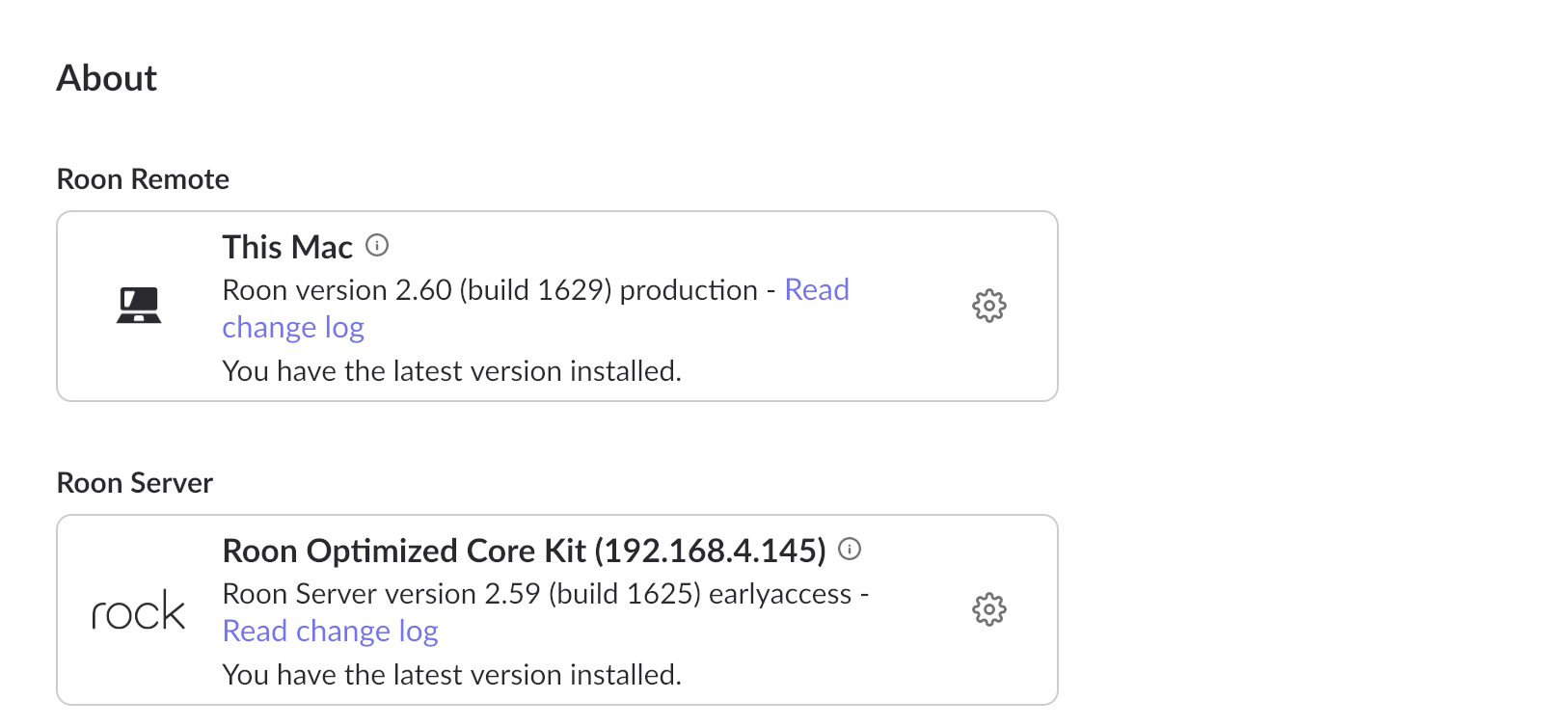

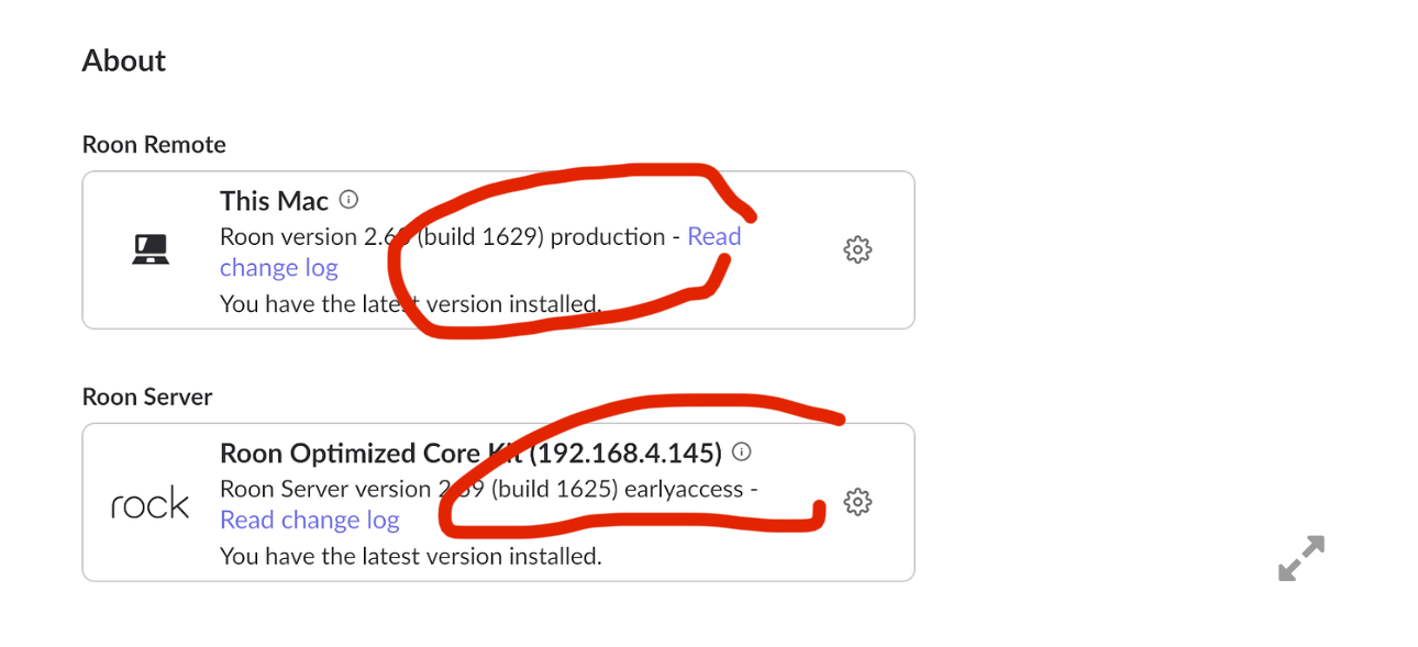

I had overlooked this. However, I see now that there is another issue because you are running a mix of Early Access and Production, which you shouldn’t do as it may always cause issues, and I think it’s currently causing precisely what you are experiencing:
Install all EA or all Production
I just followed Roon’s upgrade “prompts”. How do I install all EA or production, please???
Well you must have installed EA on the ROCK at some point. It‘s probably best to revert it to Production.

I suppose that most likely you may have created the situation with the mix of EA and Production in the past, not Roon.
Most likely, because you are not the only one who did this mix. It may work usually, so affected users may not notice, but sometimes it breaks.
Oh, and you probably still have to sort out the update channels your various machines are in, or they may update to the wrong, inconsistent versions in the future again.

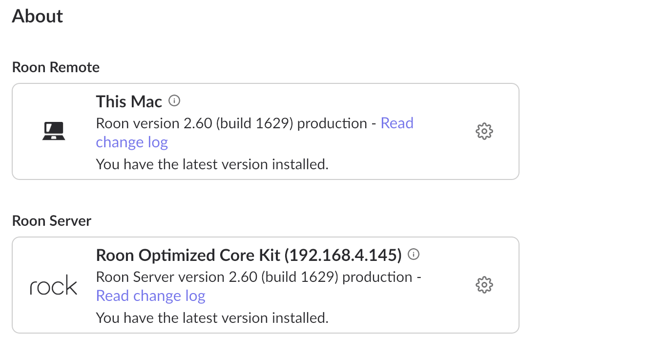

OK, now fooled around and this is now updated. Look good? For whatever reason it’s cataloguing my whole library.,…
The versions and update channels look good now
Maybe a bit weird, I don’t know. But maybe it‘s normal if it has to run a scan after switching between EA and Production. (I switched to EA years ago when it was introduced and I never switched back to Production, so this would never have occurred for me).
Normally, switching between Production, EA, and back, should not cause any issues and shouldn’t require any additional measures, so I hope it finishes up normally and nothing gets messed up :crossed_fingers:
