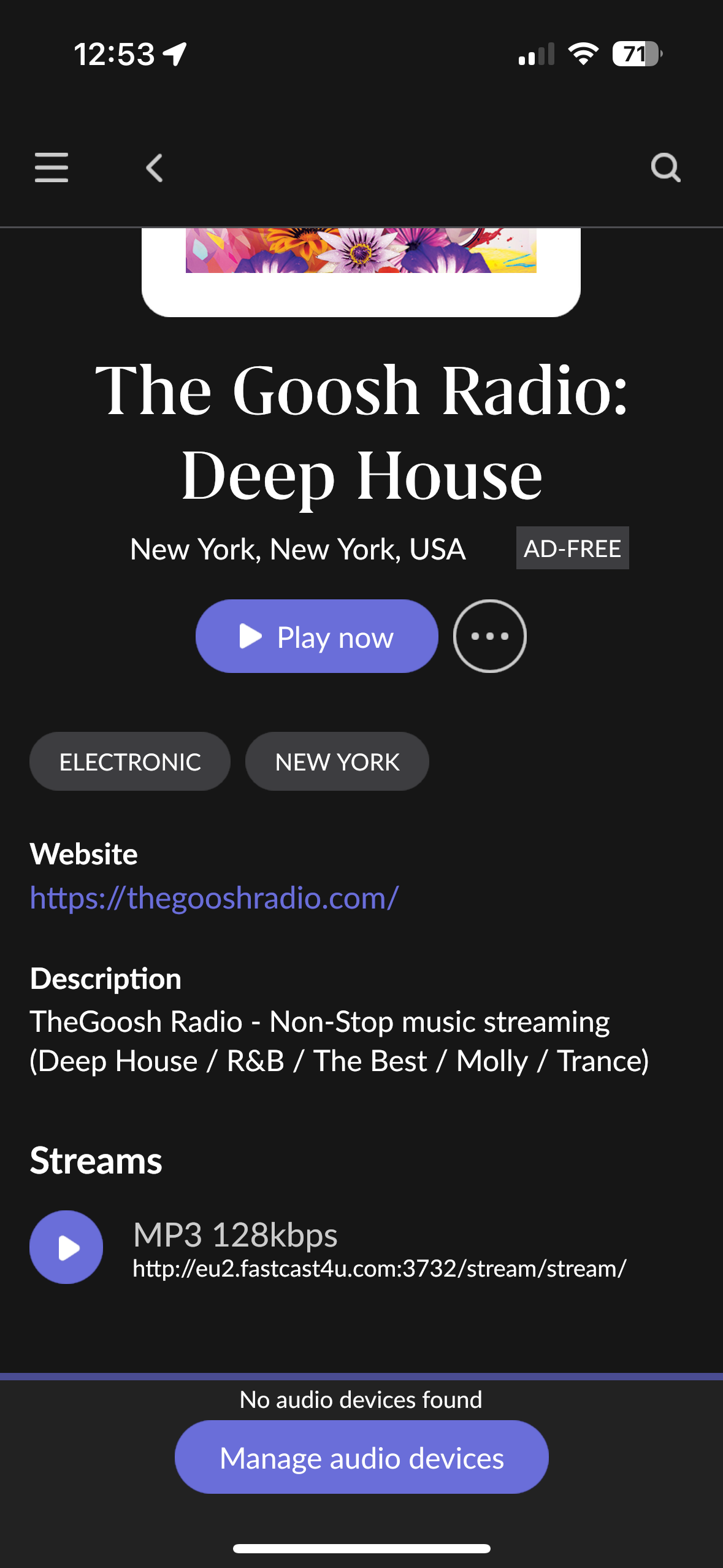

Wired ethernet plus ubiquti. Affects all zones. Roon core running on M1 Mac mini, Mac OS X 15.7.1. Roon server 2.55 build 1559. Have to restart Roon to get audio devices to show up

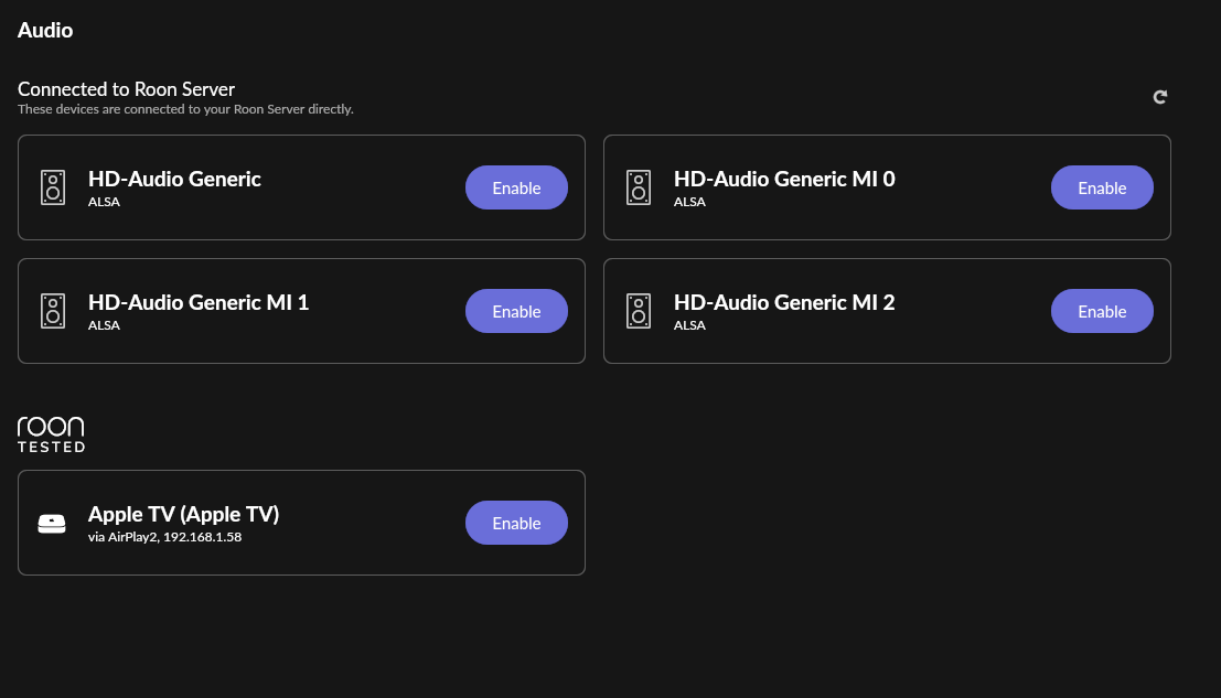

I have this issue currently ongoing. You can check example today logs around 18:00 EET.
Difference is that I am running Roon on Linux.
I have rebooted Linux as well.
For me it only sees local audio devices:
It do not see example device where I run roon software to control it:
Same happens if I look from phone.
As well it do not see my network connected audio devices.
Actually thing changed… I rebooted my network speaker and it did appear there again.
But for reason my PC Windows 11 where Roon “client” is running is not show at all… it is rebooted as well.
Sorry spamming :smiley:
I did found issue on PC… it had changed profile to public network. Once changed it it started to work once I restarted Roon client.
Other network device did not get found until I rebooted it after upgrade.

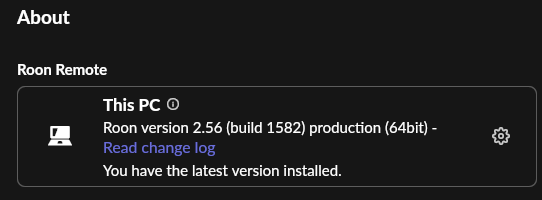

@Matt_Levin, we haven’t heard from you in a few days on this thread as the OP. Are you still experiencing this issue after updating to the latest build?
Hi,
I just installed the update. I have been rather busy with work the past few days and haven’t listened to Roon much. Will continue to monitor when I next listen and report if the issue still happens. Thanks-

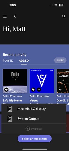

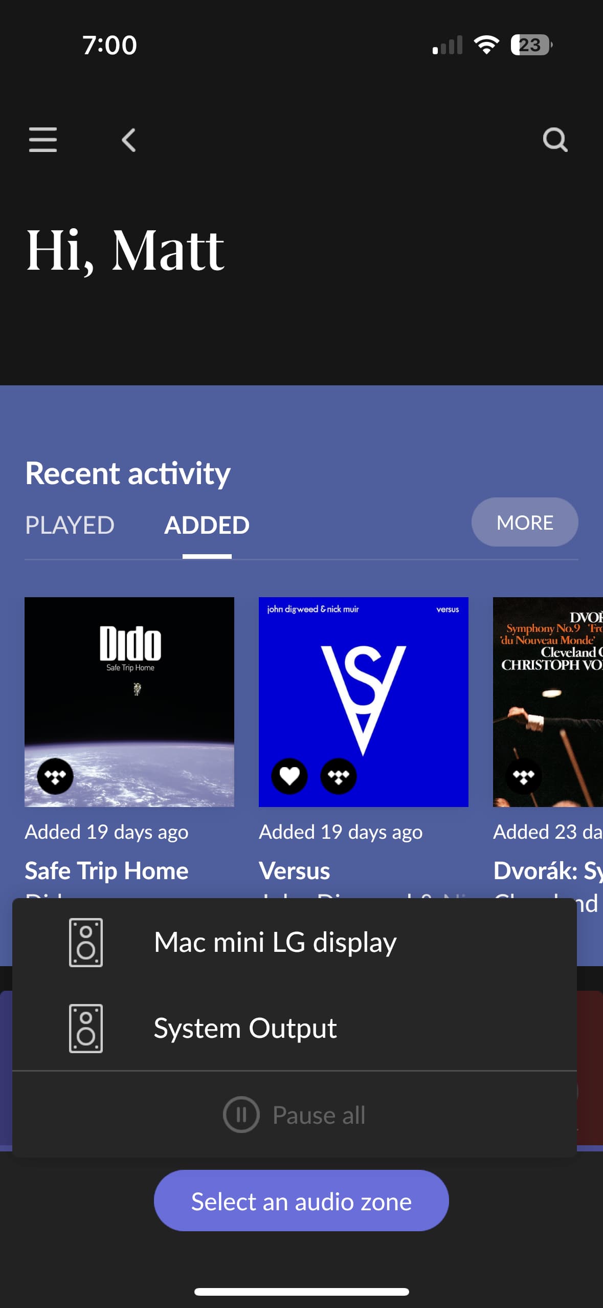

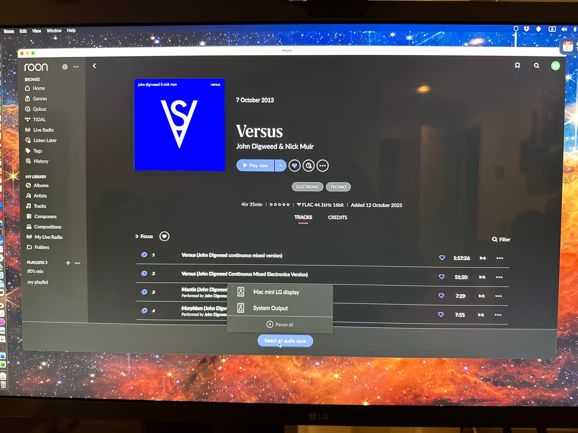

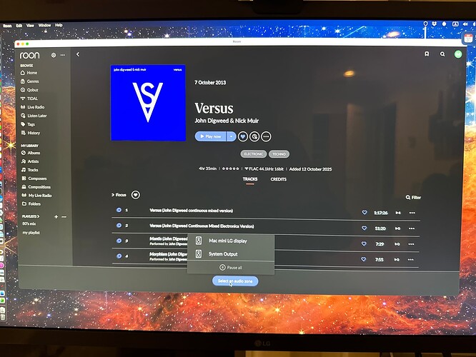

I just tried Roon on the mac mini directly and can see local zones only. 10/31/25 19:52 EDT. I also tried at 17:00 from from iphone and same issue. Screen shots attached.
Logged out current user and logged back in, re-launched Roon —> can see zones.

The team has a ticket in the pipeline to make Zone retention more robust on MacOS, but in the meantime, try turning off the WiFi on the Mac and relying entirely on ethernet.
Our diagnostic servers indicate that the Mac Mini hosting your RoonServer might have both the WiFi and ethernet network interfaces active.
Roon won’t discriminate between the available network interfaces and will use whichever the OS presents as offering the most reliable and fastest connection. If MacOS reprioritizes interfaces mid-session, RAAT might be bound to the old interface.
