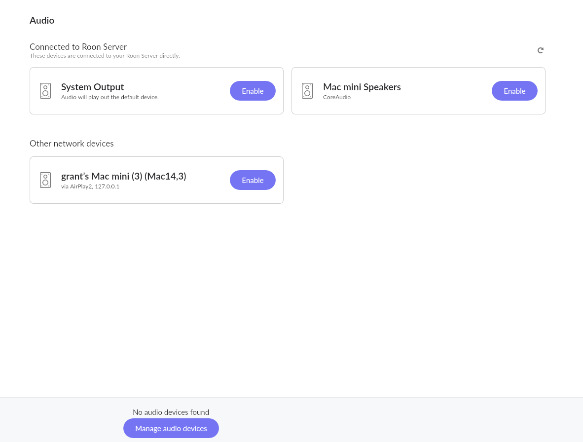

Installed latest update and no audio devices found
have just installed the latest update on a dedicated Mac Mini running as the Roon core, all network devices have disappeared in Roon. All are on the same network and nothing has changed. other software can see all the devices. Restored from a backup from a month ago but this hasn't fixed the issue. Have restarted the Mac Mini.

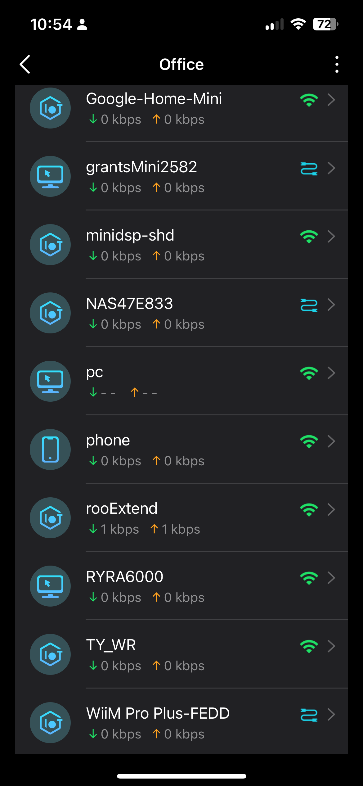

Deco BE65 three of these
I have restarted both the Mac Mini and the network to no effect. The network pic shows many of the devices on the same network.
Same issue here. Restarting my Roon Server (Mac Mini M4) fixes the issue. Also, after some time the audio devices reappear but there is no pattern to the restoration that I can see.
