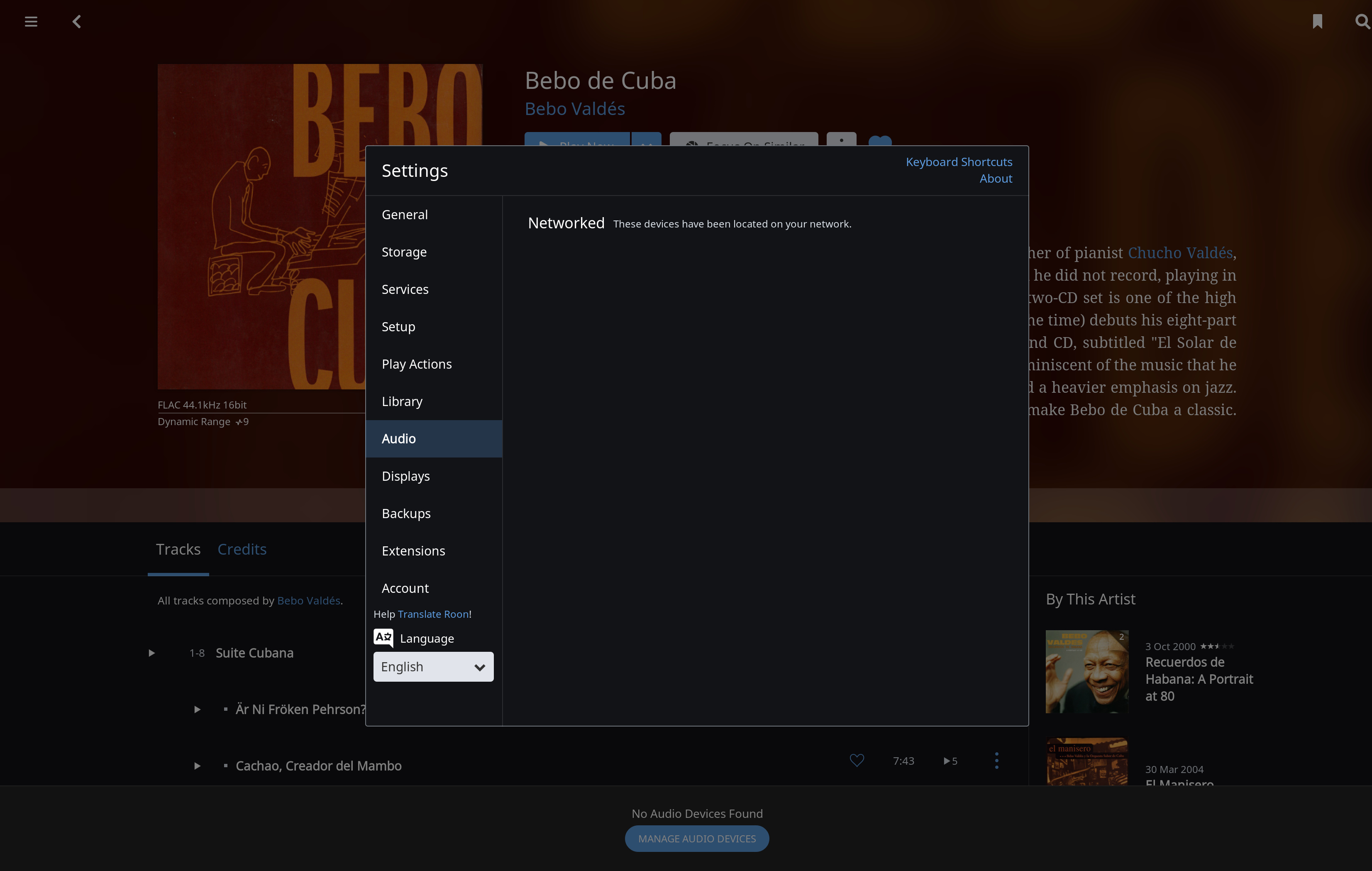

I am currently struggling to select a built in output device on my mac. The audio window in the settings just appears blank often. I have found this is triggered by either having WIFI turned off on my Mac or not being connected to the internet. Unfortunately at the moment I can’t use Roon unless I am connected to the internet which is a problem. I don’t understand how the internet should affect my built in output sources such as my headphone port. And the heading ‘Connected to this Mac’ is influenced / doesn’t appear if not connected to internet.

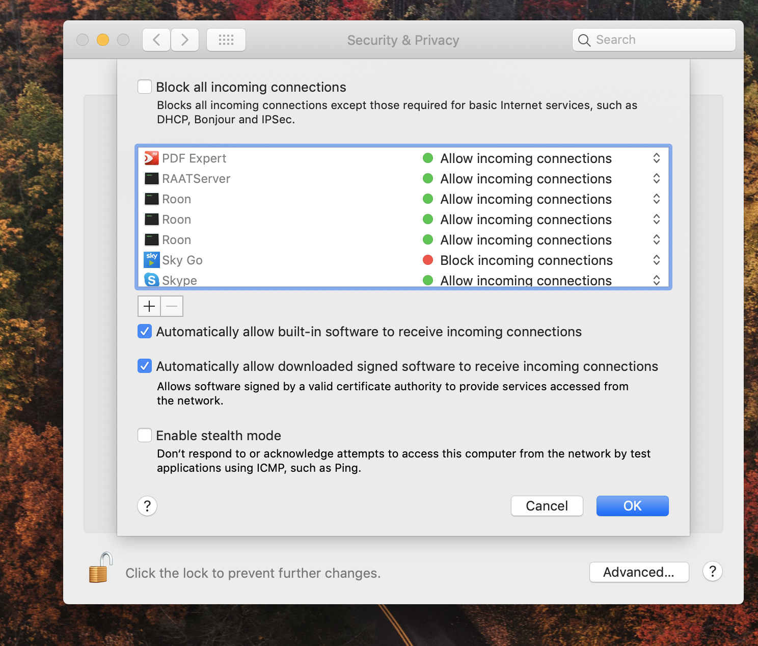

Thanks for sharing the screenshot, it is helpful. I would expect to see a similar page when there is an active firewall blocking RAATServer from performing the device discovery. What I would do here is double check that both Roon and RAATServer have been added as exceptions to your OSX firewall (you can use these instructions to check) and also that they have been added to any other application firewalls you may have (McAFee/Bullguard/Little Snitch/ect.)
Hi @noris
Thanks for getting back to me so quickly.
I have checked my firewall settings and there was nothing preventing them from running.
I don’t have any other firewall installed as far as I am aware.
Having 3x Roon / RAATServer seems suspicious. I checked mine and it’s only there 1x. I would propose to remove all. Next time Roon starts, it will request to allow incoming connections again.
Hi @Isaac_Hamilton,
I would also expect to see just one Roon/RAATServer listed there. I would remove them and re-add as Bart suggests.
Hi @noris and thanks @Nepherte.
How would I go about doing that ?
@noris
I have managed to do it but still when I have wifi turned off or not connected to the internet nothing appears in the audio output window. I have also since removed the 3 'Roon’s underneath and now have 1. The issue is still there

Just following up here based on your recent PM. I discussed your issue with QA again and they have asked if you can please let us know your network setup info as requested and perform the following test:
  1. Get in this state with no devices appearing and internet turned off
  2. Close Roon
  3. Reboot the machine
  4. Open Roon
  5. Open the audio tab and post a screenshot
Does anything change once you are already in this state and the machine + roon app is rebooted with the network still turned off?
Hi @noris
My network setup is Netgear Nighthawk R7000. Connect to my Mac via WIFI.
And here is the screenshot of the test just run. Nothing has changed as far as I am aware. Still no local outputs show up.
Just a thought, one thing I have noticed is when I perform a backup of my roon database the time it shows on roon of backup is 1 hour ahead of my actual local time of backup. Could this of affected the use of the logs I sent you as the time that I sent you regarding the logs may of been an hour out ? I have attached a screenshot with an example of a backup time which shows the time as 15:54:40 when in fact at the top right the time was actually 14:54:40. If this is unrelated or you know why this is this is fine.
