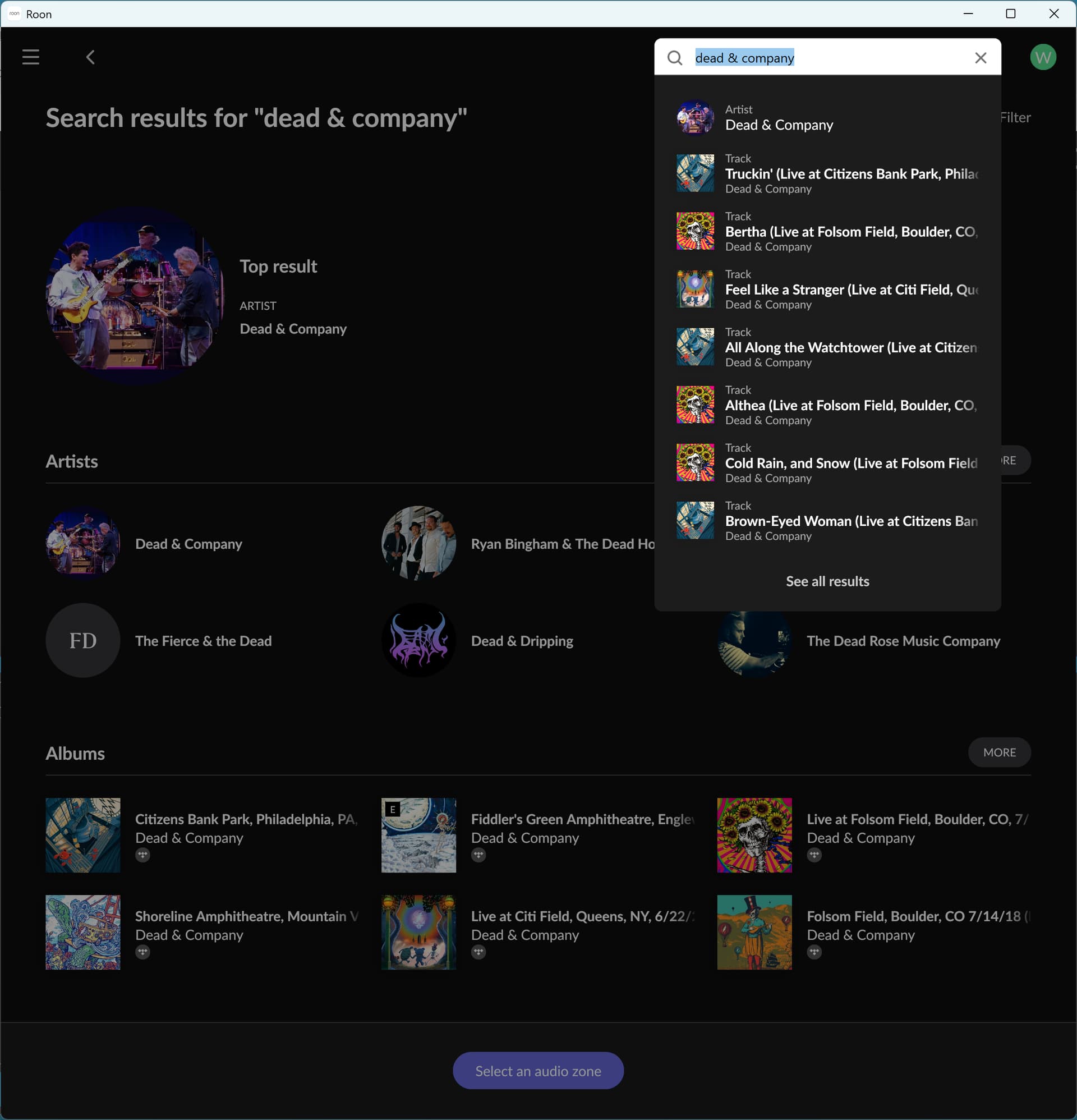

It works for me:
Note: I normally have subscriptions to both Tidal and Qobuz active but for this experiment, I disabled the Qobuz service.
If I search „dead company“ or „dead & company“, I find the artist and from there I find 187 albums in Discography including the live ones.
However, if I search „dead and company“ it doesn’t find the artist and the results only contain a few albums and tracks from them. Maybe Roon search should equivalence „and“ and „&“, but then this comes with the possibility of false search hits in other cases

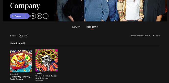

Thanks. As in my OP, I’ve tried all combinations of searches. Dead & Company, Dead and Company and Dead Company all return the artist Dead & Company. I click it, and the discography shows only the albums I’ve favorited in TIDAL.

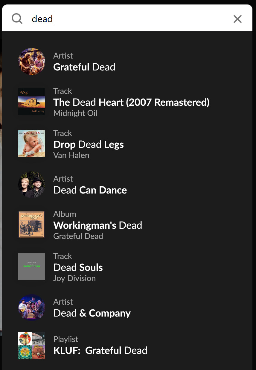

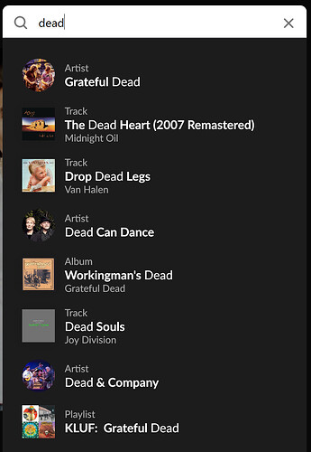

In my experience, unless you actually execute the search (not just look at the quick results, but hit enter after typing in the search term) it does not always find/or show what you are looking for. You have to actually hit enter or as an alternative click the “see all results” as @Suedkiez says.
The “quick results” is more of a preview of results and not the full list. Then you may need to click “more” on the results page to see, well, “more” results… If it still does not show up then you most likely need to “refine” your search terms.
I had edited this post in the meantime while you were writing, because the issue here doesn’t seem to be that the artist doesn’t show up in the quick search results (in which case hitting Enter or clicking All Results helps).

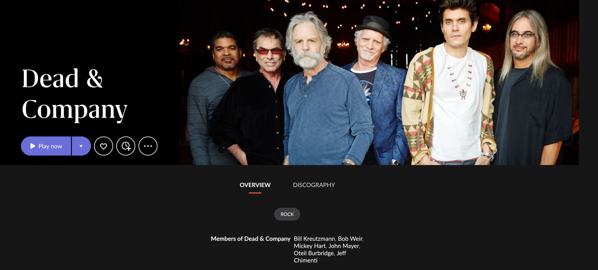

@Dean_Clough post a screen capture of your Dead & Company artist page. Overview & Discography.
No problem - and yes, I have been executing the search. The only discs that appear when I click “Discography” are those that I’ve favorited in TIDAL, vs. displaying their entire catalog, which it should, and does for every other artist I’ve tried.

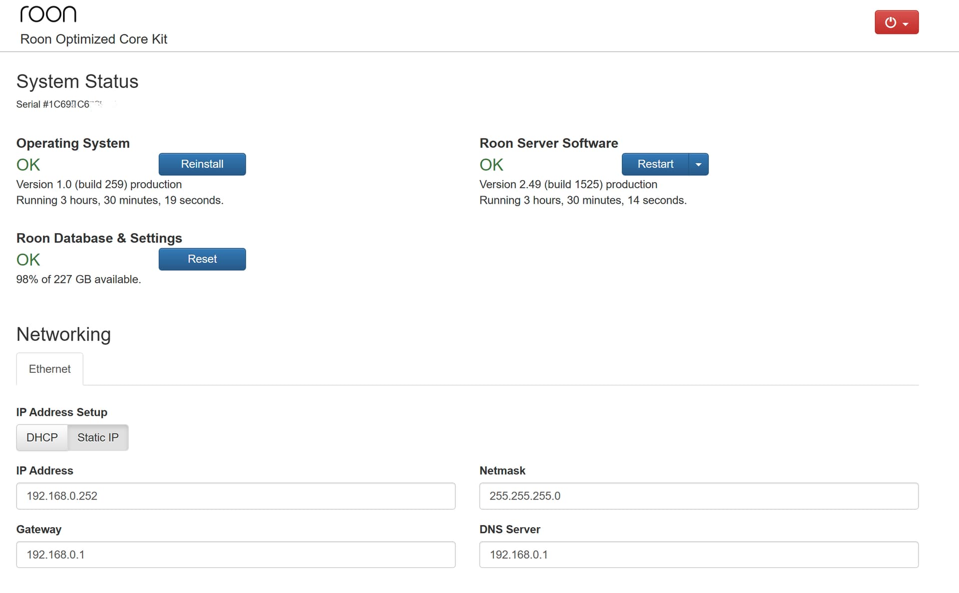

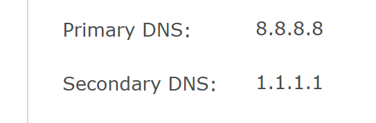

Thank you Benjamin, but my router was already set for this. I believe the primary is Google, the secondary is Cloudflare. Should I try reversing them or using Quad9?
Screenshot 2025-04-22 102028
Is your router configured to give those DNS addresses out via DHCP or are they used by your router and your router proxies DNS requests for your clients?
Hello DrTone - it’s DHCP
Have you played with giving your Rock a fixed IP and different DNS servers directly? It’s behaving like it’s a dns cache corruption issue.
Thank you - but my Core/ROCK is already set to use a static IP address. I am going to leave the DNS address on the Core alone (it is presently pointing at my router, which to me means it should be using Roon-suggested Google and Cloudflare DNS) until I hear back from Roon’s tech support group.
You need to rule out your router caching DNS by pointing your Rock directly at the DNS servers.
It’s a 2 minute change and reboot.
Hi @Dean_Clough,
@DrTone shares a valid point - we’ve seen some odd things happen from upstream servers like Tidal / Qobuz in relation to DNS on the server side. If it’s something you’d feel comfortable testing temporarily, updating the DNS server from your ROCK webUI as well would be a good next step in testing.
