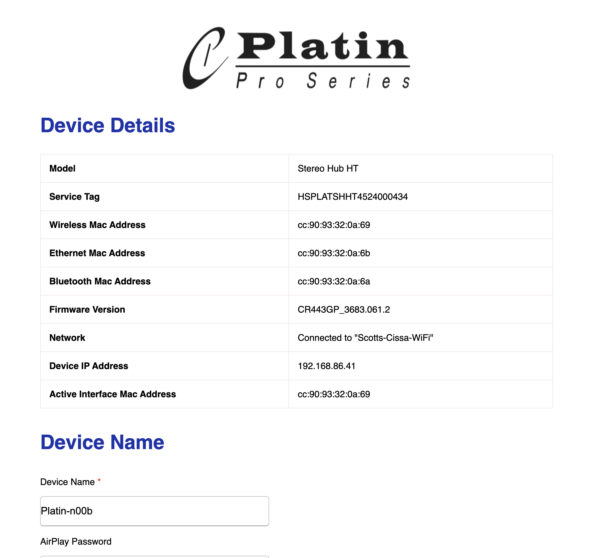

Device Settings for the Platin Stereo Hub HT paired to the A10s:
Version: CR443GP_3683.061
RAAT SDK version: 1.1.44

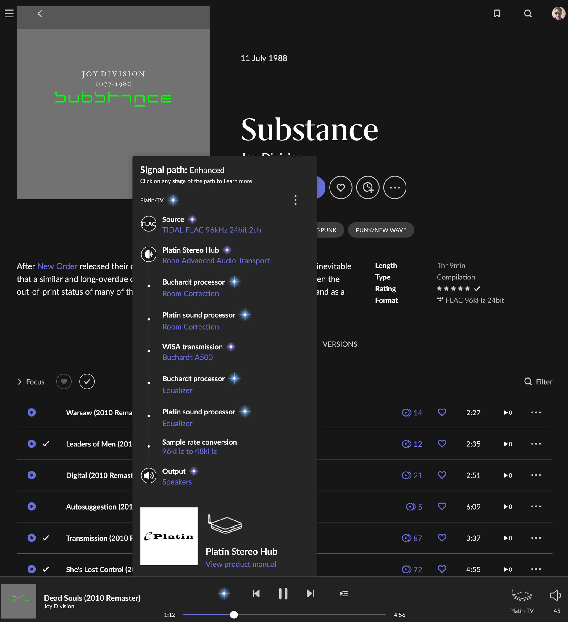

If I go to Devise Setup via ROON - I can adjust the Max sample from 48 or 96 or 192 kHz + 16 or 24 bit.
  • All music up to 48kHz is converted up to 96kHz and outputs with “High Quality” - sounds fine.
  • All music that is higher than 96kHz (like 192/24 TIDAL content) is converted down to 96 by the Platin and outputs as “High Quality” - sounds fine.
  • Hella Weird: Music that is natively 96kHz from TIDAL, like Joy Division’s Substance or Talking Heads True Stories OST, triggers the “Lossless” indicator yet plays with a cuts-in-and-out-stutter sound.
If I set the Device only to receive up to 48kHz, all signals are bottlenecked and play fine. If I set to up to 96kHz, anything not 96kHz native plays fine. If I set to up to 192kHz – anything not 96kHz plays fine.

    2. “ROON signal path shows all DSP/Room Correction/Lossless playback”
  2. New version of Platin Stereo Hub
    1. Problems with Buchardt A10, A700, A700LE
    2. “…none of the Buchardt Room Correction and DSP stuff appears into the Signal Path“

My Firmware is: CR443GP_3683.061.2
What’s your new Firmware Build ID?
My Platin Stereo Hub HT is still glitching with 96kHz-native content and is not showing Lossless for non-96kHz signals converted to 96kHz.

Hey Scott
My Firmware Version: CR443GP_3863.061.2, and it was updated directly over the internet.
That’s interesting that we have the Same Firmware yet my Stereo Hub HT glitches out.
