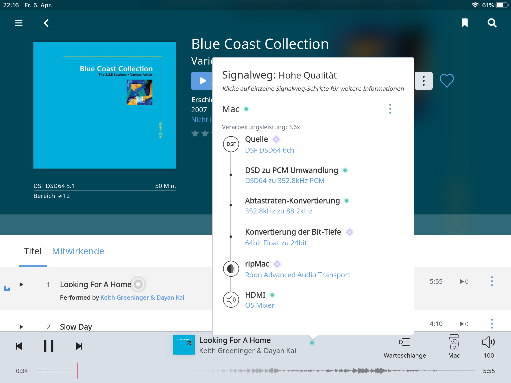

Finally I achieved to stream multichannel tracks over HDMI with my Classe Sigma SSP with your kind help. Thanks for all your appreciated replies.
As otinkyad said: configuring via the Audio MIDI Setup utility on the Mac helped, rather than just using Sound Settings. After that I could stream a 5.1 track stored on the Mac via QuickTime. Also multichannel streaming with my Roon setup on the Mac worked fine then, including multichannel streaming from Qobuz!
Remaining limitations:
  1. It looks like as if the output over hdmi on osx is limited to 96 kHz, so higher sampled files will be converted down by Roon. I will check if this limitation also remains when using a windows pc.
  2. As Kam mentioned It looks like as if the Sigma SSP does not support multichannel streaming over usb or network. I will have confirmed this from the Classe support and ask if they plan having their preamp/processors Roon ready.
