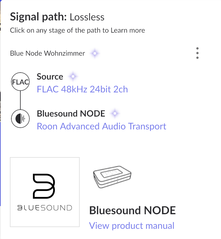

After the installation of Roon 2.0 (before with 1.8 everything worked fine), Roon still finds my Bluesound Node 130 but playback does not work. Signal Path:
The track starts but immediately stops at 0:00. After 15 seconds the track is skipped and the next one starts with the same results until the process reaches the end of the album.

Okay. I did that and it worked. Hopefully this is not going to happen too often. Thanks. You can close this one her.
