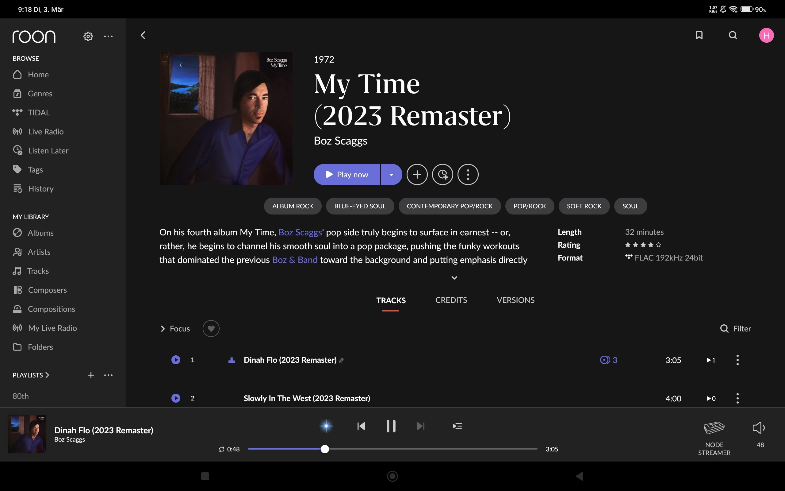

When I try to play certain Tidal albums in Roon, it only looks like they are playing, but there is no sound:
Boz Scaggs – 1972 – My Time
Marvin Gaye – 1965 – How Sweet It Is To Be Loved By You

Here is a screenshot of the album playing with no sound.

Thanks for the update! From a fresh diagnostic report, it appears that everything is functioning properly in terms of Roon sending the audio signal. The log shows the track loading, buffering to 100%, and “playing” for a bit before a manual PlayPause command is issued.
Since everything is fine, the problem is likely one of the following:
  • Sample Rate Incompatibility: The NODE 2i is trying to output 192kHz. Does the same issue happen on lower resolution tracks?
  • Variable vs. Fixed Volume: If the NODE 2i is set to "Variable" volume in the BluOS app, check if the volume there is at 0. Sometimes Roon's volume slider and BluOS's internal slider get out of sync.
  • MQA/High-Res Processing: The NODE 2i does MQA unfolding. If there is a conflict in how the NODE is handling the "Max" quality Tidal FLAC stream at 192kHz, it might be choking at the hardware level.
