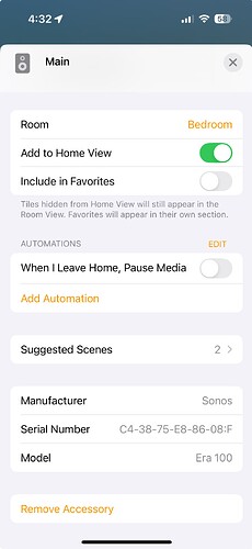

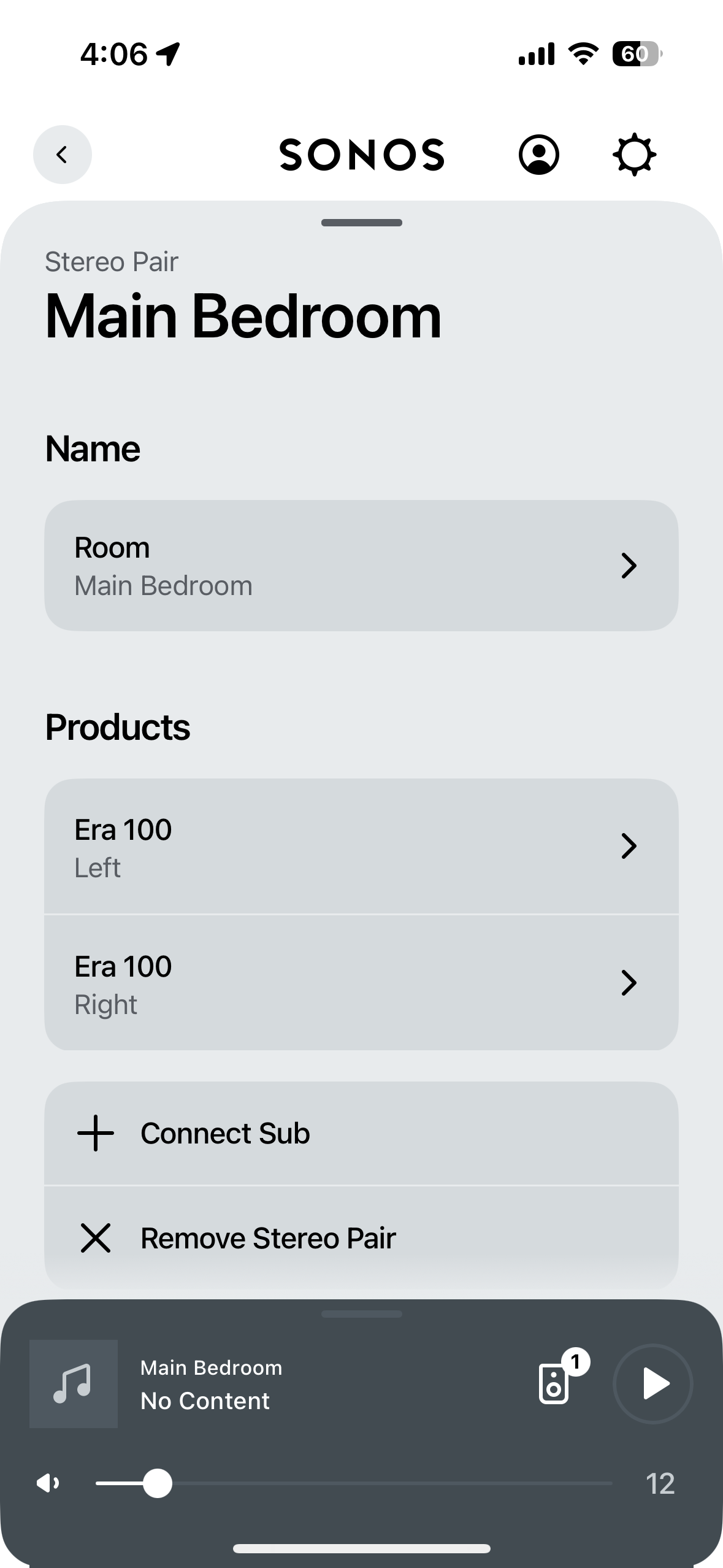

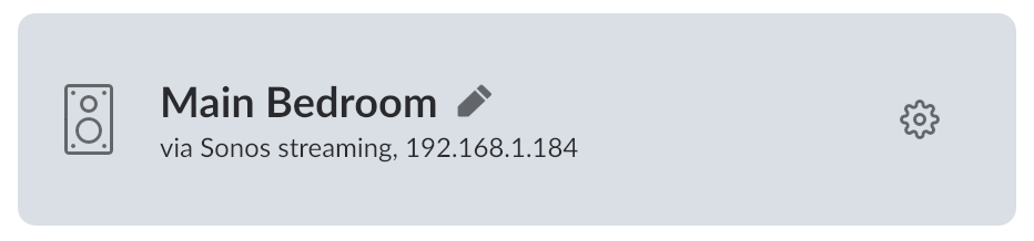

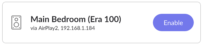

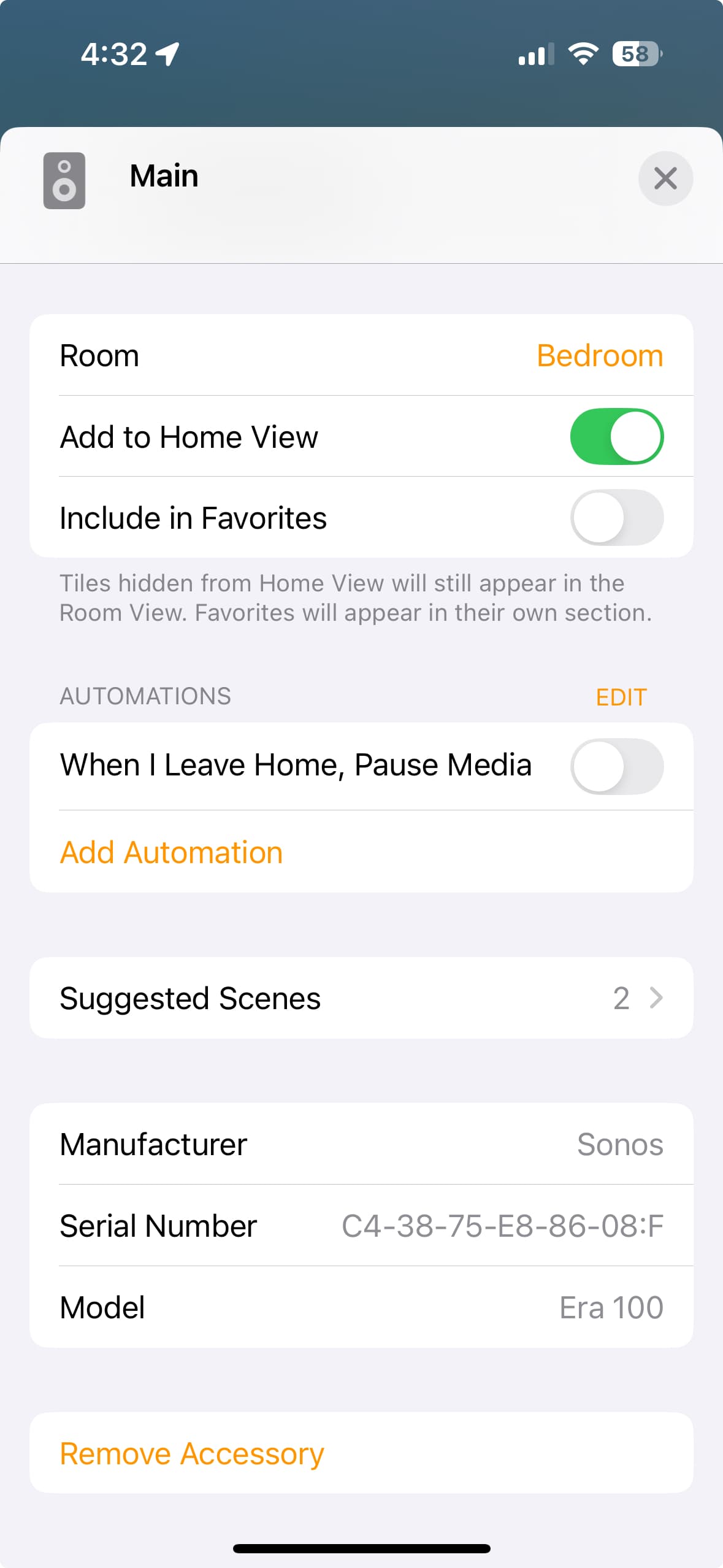

Thank you for the suggestion. I added the era100s to the apple home. It did not fix the issue. Here are some screen shots from my setup. The speakers are grouped as a stereo pair in the sonos menu (see attachment). I am able to cast roon to the sonos era 100s (main bedroom 192.168.1.184) and that works as a stereo pair. But it does not work when the same pair in the apple home. Thank you for your attention to this matter and let me know if there is anything else I can provide to help the community and support engineers.
