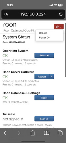

Hi, I checked the interface and everything is normal, but the problem still exist. Could you please help to look into the issue ?
To supplement with more info on my previous screenshot, it seems only music with certain format such ash 96 kHz can be played but 44.1 kHz cannot be played.
I have just tried to switch to another roon core, same problem exists. Can only play other formats from quboz other than 44.1 kHz song but cannot play 44.1 kHz songs…
