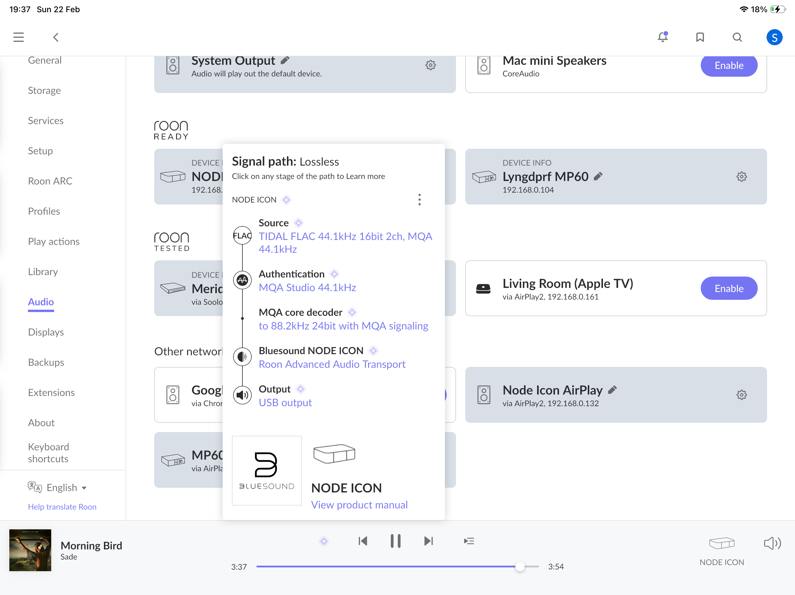

· I have just purchased a Bluesound Node Icon and have connected it to my Lyngdorf MP60 via USB. The Icon plays directly to the MP60 with no issues. However, when I try to use Roon I get no sound output. The Icon is recognised by Roon and I can see the signal path. I have ‘played around’ with the Icon settings within Roon but without any success. Previously I had a Bluesound Vault2 connected via Optical and had no problems

Hi Suedkiez, yes I have tried non-MQA material as well. The attached shows that the Icon is recognised in the Signal Path annd identifies the USB input.

Maybe I should add that my Roon Core resides on a Mac Mini - I think the issue might be related to the settings on the Mac Mini?
So, In device setup I have the Icon set as Renderer only and Enable MQA core decoder ‘yes’. These are the settings that Bluesound suggest for the Icon connected by USB. However, I still get no sound through Roon
