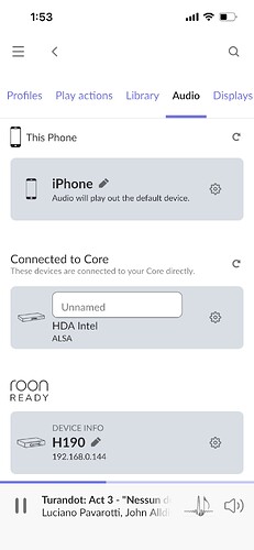

Hi, I have a question. Roon ROCK is installed in my PC (with Ubuntu 22.04 and HQP embedded). I just connected this PC to Spring 3 via USB. It does not work, no sound output. I’m sure this is not my system issue as I can play with Roon + HQplayer + Spring 3 + Hegel H190 without issue. Just doesn’t work if Roon output to spring 3 directly.
Roon detected HDA Intel ALSA after I connected Spring 3, so I assume it’s Spring 3. See following screen shot. Could you let me know what I should do ? Thanks

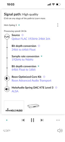

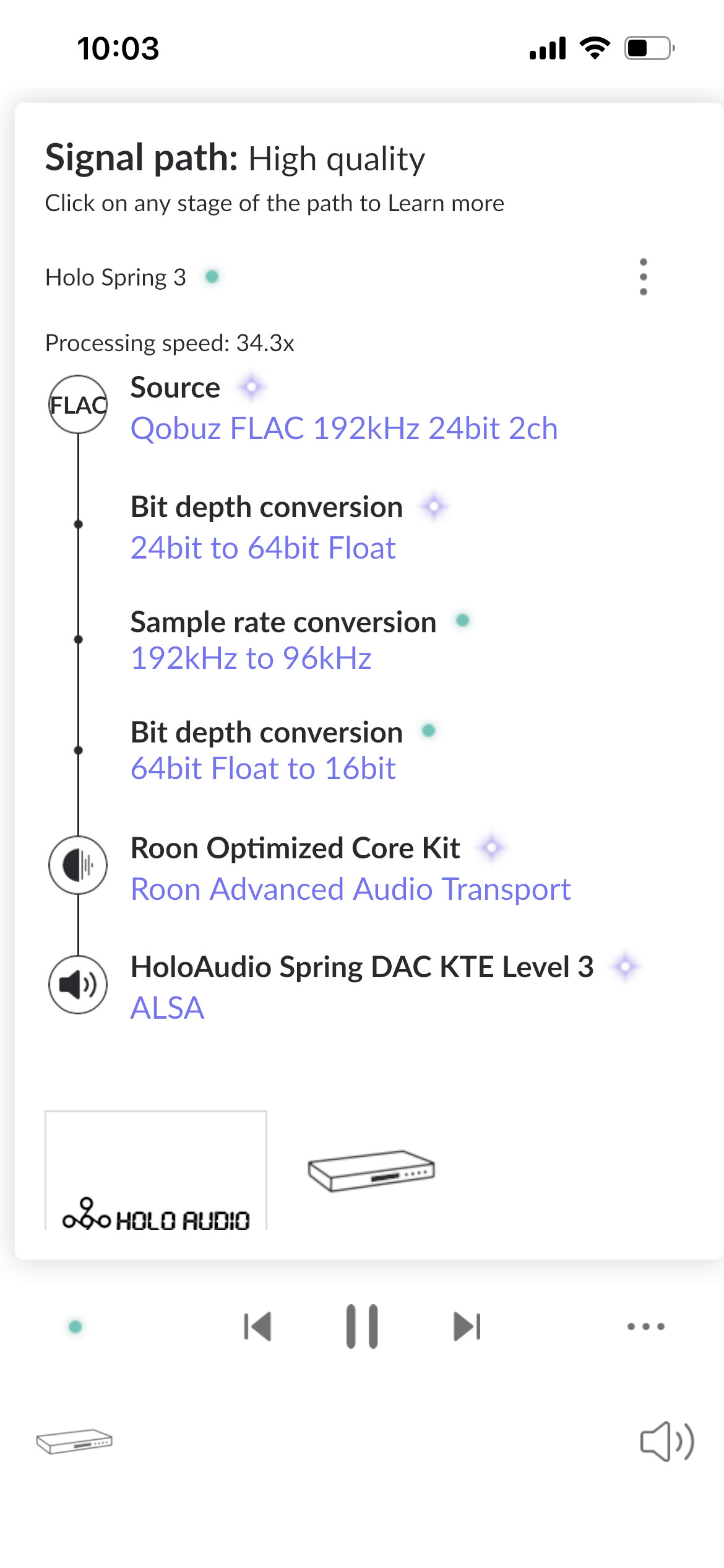

Please share a screenshot of the Signal Path (green/yellow/blue dot above the playbar) when attempting to play to this PC System Output Zone (the Holo Spring 3 via your Ubuntu). Are you using any DSP?

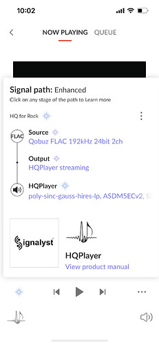

I do use HQP 5 without issue. The issue only happened when I tried to use Roon to output to Spring 3 directly. I use both Qobuz/Tidal, no local library. Please note the “Spring 3” in Roon remote screen shot below is typed by myself. I recalled it showed ALSA audio system or something. I modified to “Spring 3” as it showed up after I connected Spring 3 with PC through USB.
I learned from one friend, who believes the ALSA is “occupied” by HQP 5. Unless I free up ALSA from HQP, roon will not be able to pass signal to Spring 3 through ALSA. Is it possible ?
No issue if Roon → HQplayer → USB → Spring 3 → XLR → Hegel H190
No sound if Roon → USB → Spring 3 → XLR → Hegel H190
