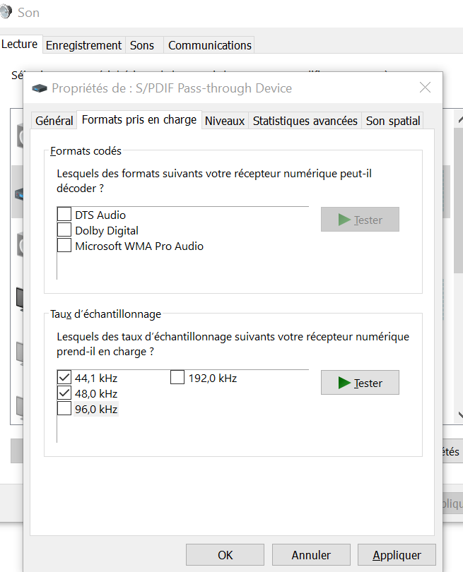

If I lower the max supported frequency to 48kHz in the device settings, sound is ok.

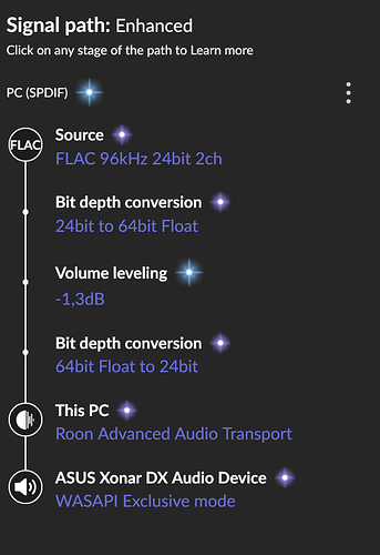

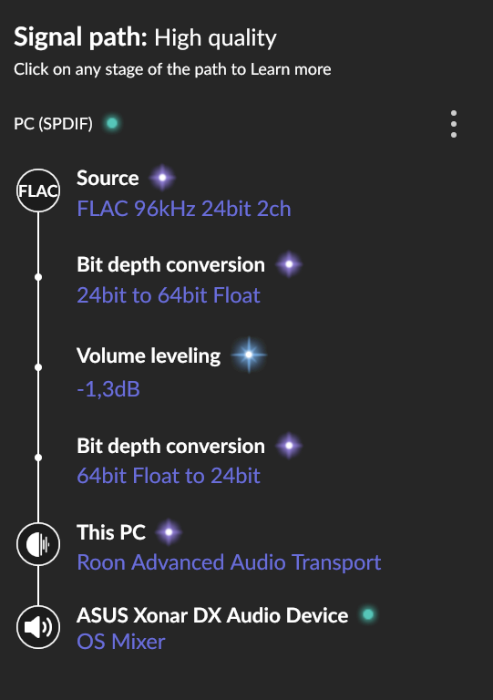

If I restore 96kHz capability but disable Exclusive mode in the device settings (which worked fine before) sound is ok but the signal path quality changes.
Enhanced signal path = No sound
High quality signal path = Sound

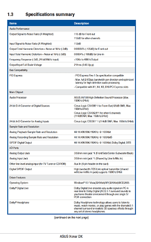

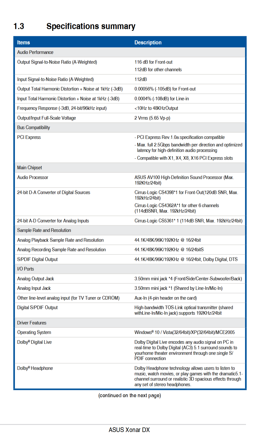

The sound card is about 18 years old, and the S/PDIF specification then most certainly would only support 20 bits via optical/3.5 mm jack. So, I suspect the issue is bit-depth not sample rate, which is up to a maximum of 192 kHz 20 bits.
You could try changing Max bits per sample to 16 in Device setupShow advanced.
I have sound with foobar2000 on the same PC with the same sound card and the same speakers (which are 192/24 compatible through Toslink).
The Xonar DX was a high quality sound card and it supports up to 192/24 for optical.

Okay, thanks for confirming. You say it worked before, but you say that this was with Exclusive Mode disabled. Foobar2000 will use the Windows audio stack, and OS mixer, by default.
When using the OS mixer, there is no guarantee that the higher sample rate/bit depth hasn’t been altered. This would not be shown in the signal path, which is why there is a green indicator. You would be better off bypassing the system mixer and using Exclusive Mode with a lower bit depth or sample rate.
Exclusive mode was enabled initially… It works if I disabled it.
You haven’t confirmed if Exclusive Mode (Roon) has ever worked with 96 kHz 24 bit recordings. As I said, using the Windows OS mixer will downsample, so there is no guarantee that source values for sample rate and bit depth are delivered to the sound card. Therefore, experiences with Foobar2000 cannot be fairly or practically compared to Roon using Exclusive Mode.

I then did a simple test in the windows sound settings of the device.
No sound too when hitting the test button. Works fine with the two others.
So in conclusion it seems to be a windows/driver or hardware problem…
I dug a little more in the driver section… I uninstalled all my sound card outputs in the device manager and restarted.
After setting back exclusive mode on device… sound is back.
