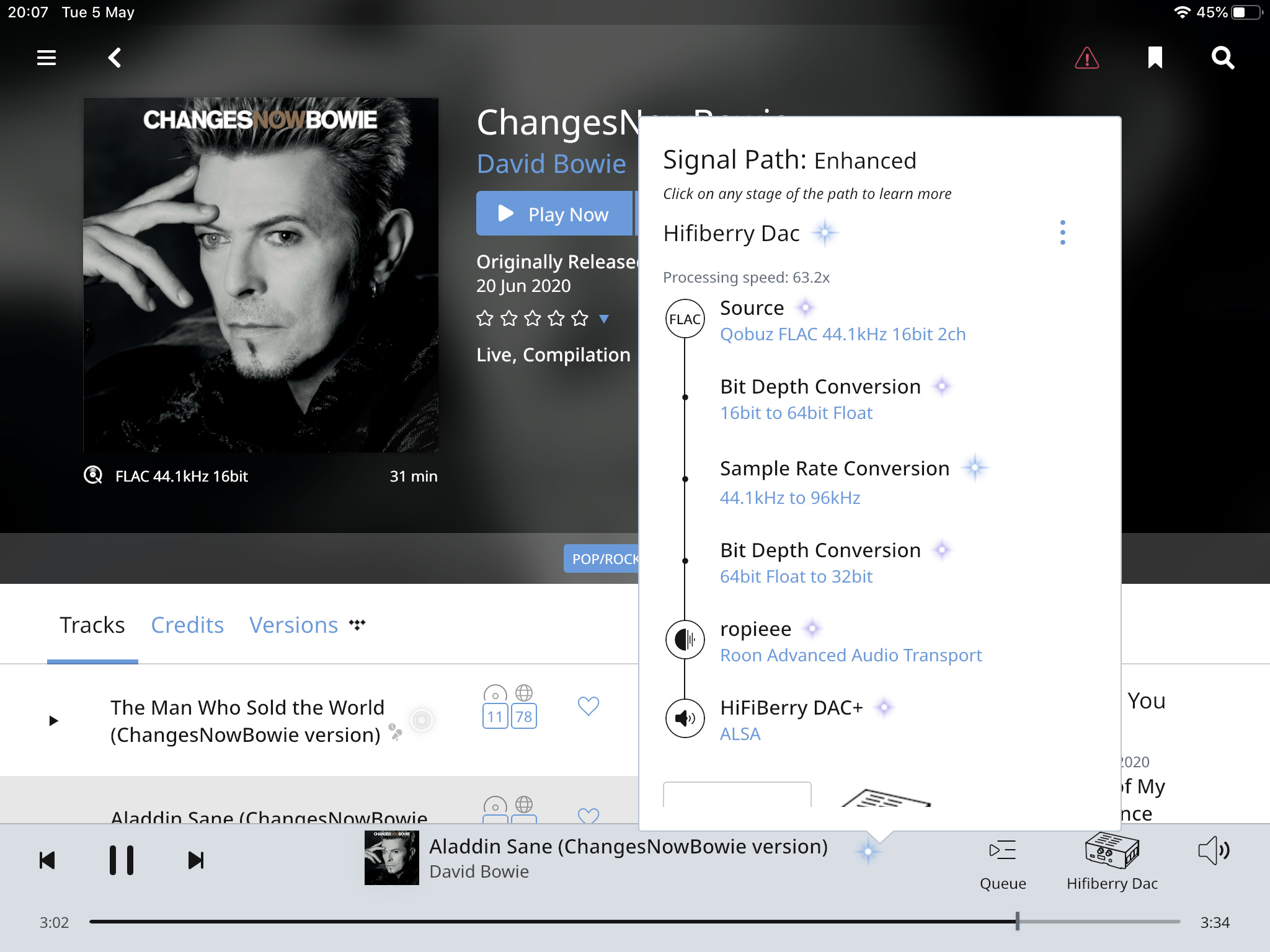

Show us the signal path to it might help us help you get to the bottom of it. Volume should be set to fixed. Also show your Ropieee settongs.

Here is the signal path. Richard
Odd, have you tried it outputting to something else other than the Meridian ? To see if that’s the issue.

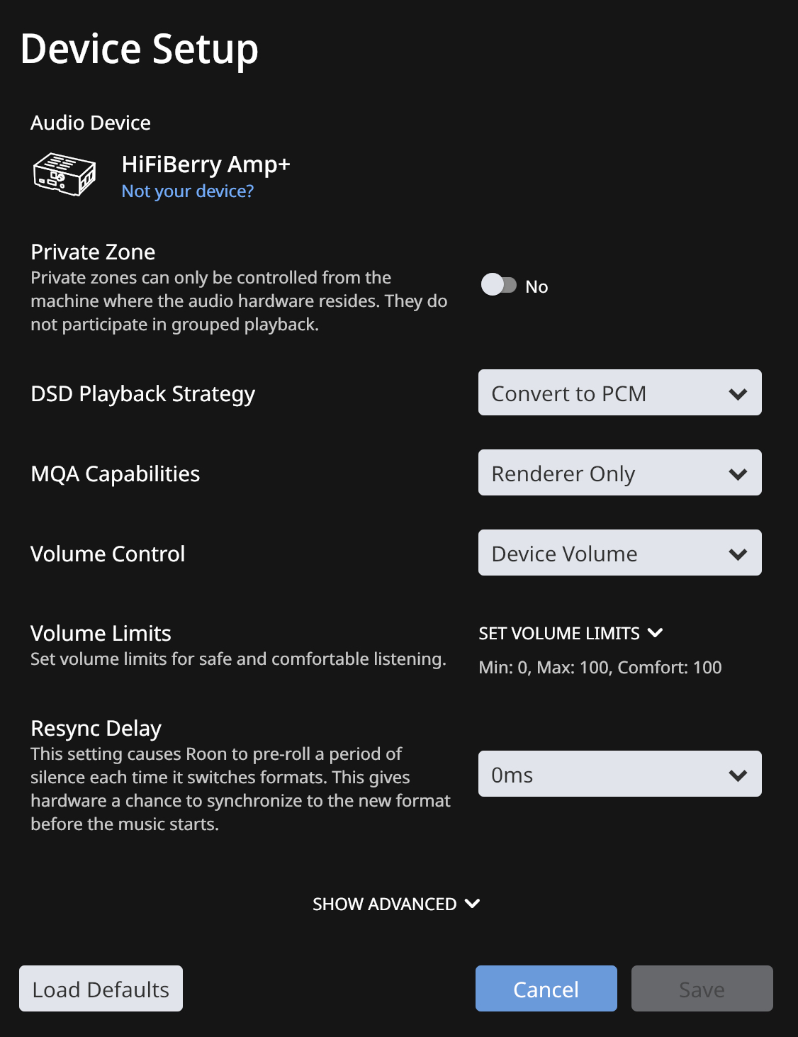

I think volume should be set to “Device Volume”, this setting works with my hifiberry amp, which Ropieee see’s as a dac+.
Not for DAC fixed is the way. as you want it to output line level or you using crappy digital volume attentuation and not you amps decent analogue stage. Amp+ has an amp in it so device is the only way unless you want full volume all the time. I have both Amp+ and DAC+ and this is how they are setup.

Thank for your help. I had initially installed the software on Ropieee for HiFiBerry Dac/Dac+Pro/Amp2. This did not seem to work so I then installed HiFiBerry Dac which was when I asked the question on the Community Board. This morning I reinstalled the first software install and reduced the Max sample rate in Roon Set Up to 192Khz for the HiFiberry Dac Pro + which is the maximum that the Meridian Prime Amp can cope with…and voila I have sound!
