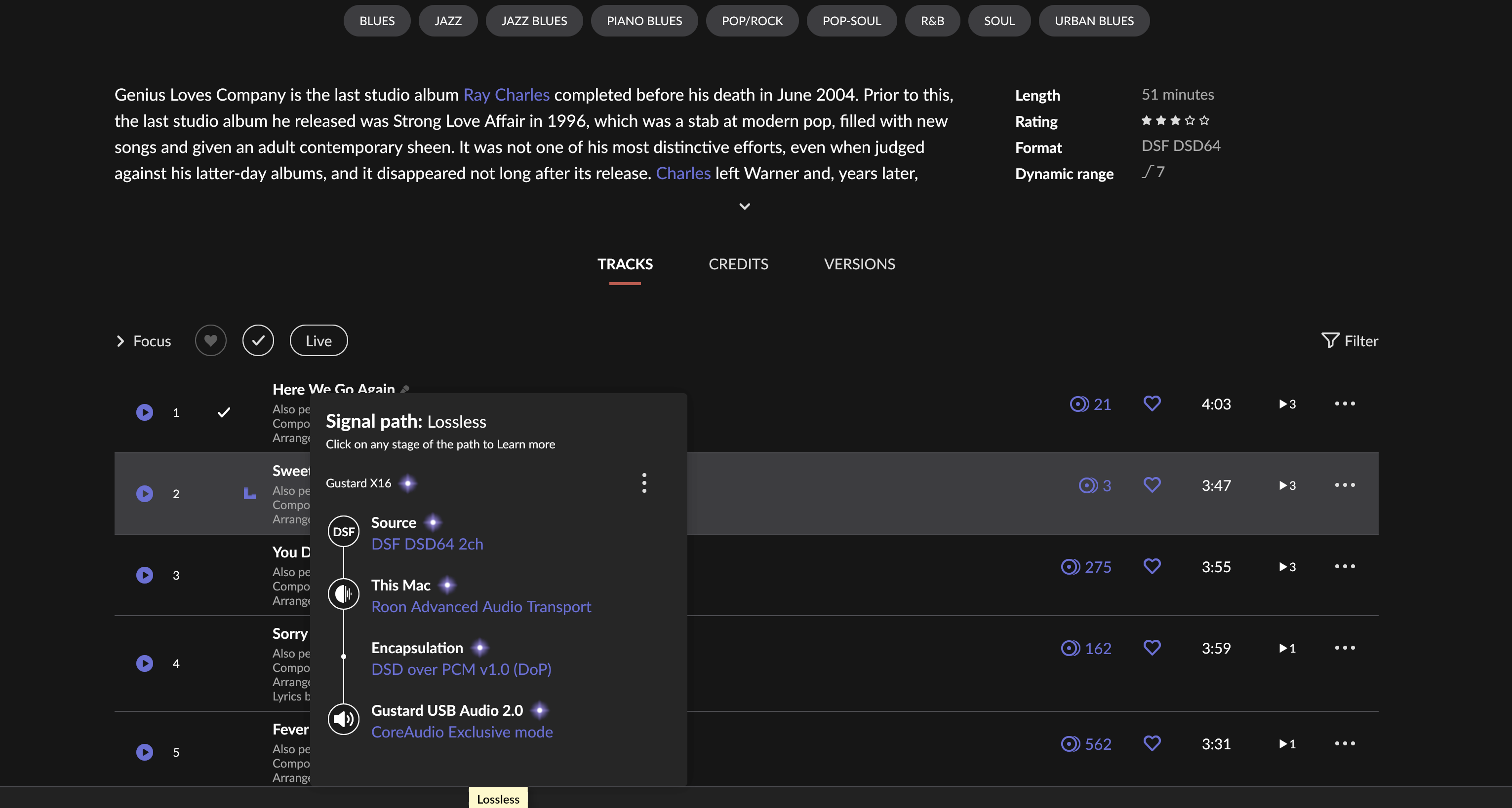

Twice now I have played a DSD 64 file and got horrible noise. I switched over to JRiver and played the same tract and it was perfect. No problem whatsoever. Example is Ray Charles screen shot attached

What OS is your Roon Core running on? Windows?
Is the Gustard connected via USB?
Are you using WASAPI? ASIO?
Exclusive mode?
Native DSD or DoP?

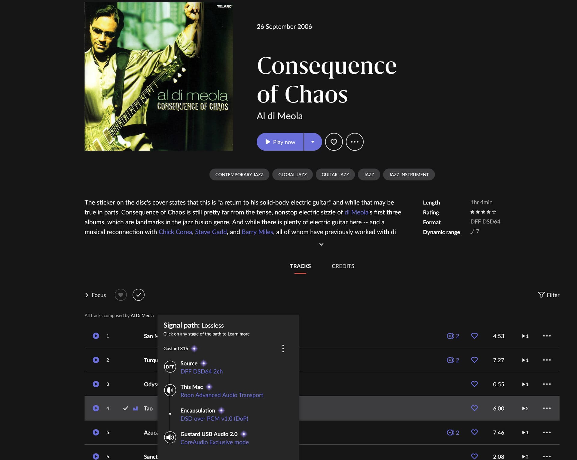

This is another album that gave me trouble. (I just played it again and it is fine)

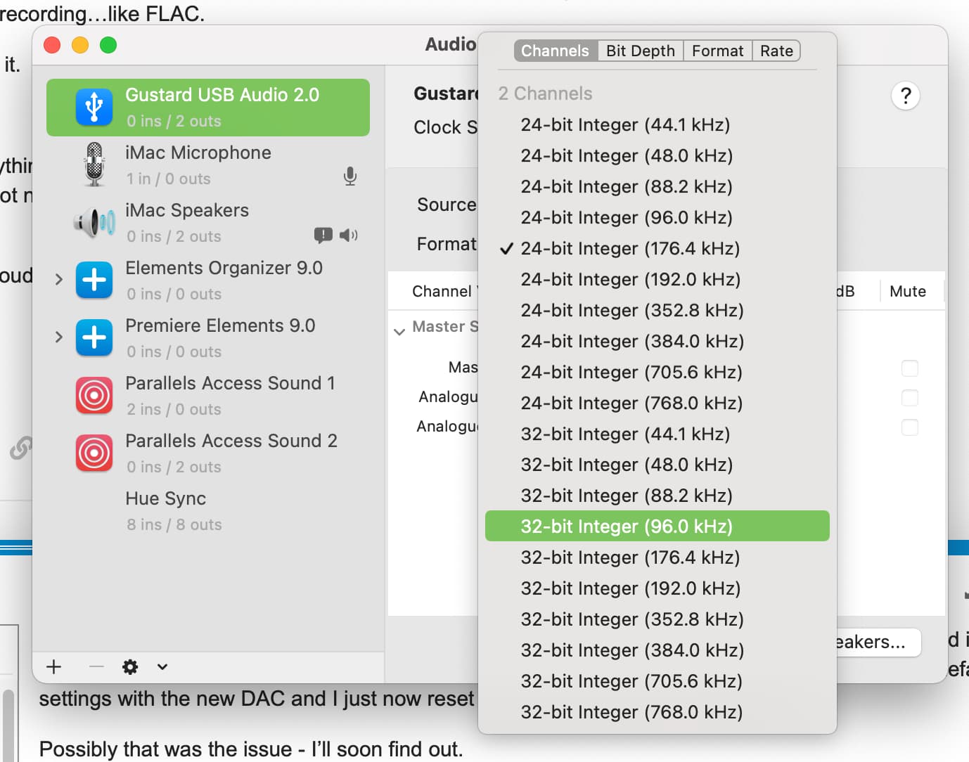

These problems started after I replaced the DAC. I had a hardware problem with the new DAC and it was replaced under warranty with another new one. I just noticed my Mac Midi settings went back to default settings with the new DAC and I just now reset it to back to maximum bandwidth.
Possibly that was the issue - I’ll soon find out.
Update: For some reason the Midi settings always go back to the default. It wasn’t the new DAC…it was my MAC…
See the attached screen shot. I can’t change the settings
Update #2: I rebooted the computer and now I am once again able to change Midi settings. Why does my Mac reset it without warning?
And then after playing some DSD 64 tunes, I rechecked the Midi settings and they had once again gone back to the default settings (24 bit 176 Hz) and were once again unchangeable.
This time I quit Roon and once again I could change the Midi settings. I put it at 32 bit 768Hz. Then I played a DSD 64 album and when I checked it — it was back at 24 bit/176 again. However, the display on my DAC indicates DSD 2.82MHz so maybe this Midi setting is bogus?
Roon is changing the bandwidth??? Are my Roon settings not correct?

24/176.4 is exactly what is required to play DSD64 in DoP format.
24/352.8 is exactly what is required to play DSD128 in DoP format.
In the absence of native DSD on Mac, these are the exact rates your Mac OS need to be outputting at, otherwise at any other rate you wouldn’t be able to play them properly at all.

DoP is a format to carry DSD. You get DSD.
Mac does not offer that.
Try Windows.
